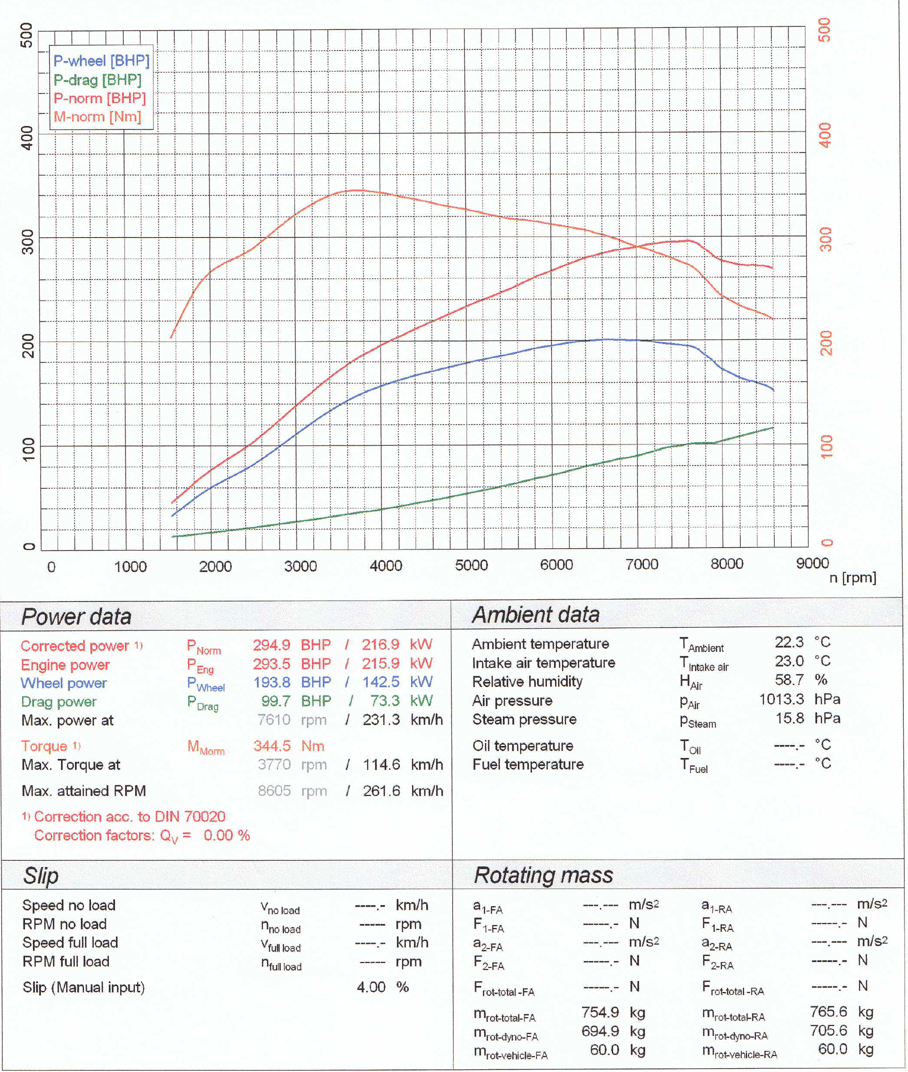

Results attached, do I have a problem?
Analysis appreciated.

honest wrote:Results attached, do I have a problem?
Yes looks like vacuum fault .. check all lines .. including the exhaust valve ..
Lots to check ...
Lots to check ...
http://www.jlosee.com/images/RS4/PDF/TS ... fold-2.pdf
Second that - there's no "kick" at 5500rpm which suggests that the vacuum is leaking away so the "power flap" isn't operating.
Lots to check ...
my thoughts exactly....that car is making 200 whp...300 Hp at the FW with 100 in losses
what's consistent is all cars have ~100 HP in losses when measured...
a cf of ~35% so 1.35 x whp ~ crank for this car...
so if you make 305 whp x 1.35 ~ 412..
losses ~25% or 100/414
so any car making 300+ at the wheels is making rated HP...
THAT's why wheel numbers are the only ones to consider...
and using a dyno that MEASURES losses
