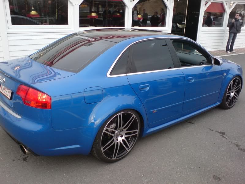

They look very nice indeed! - The RS6 wheels are 9.5x20 ET36 - standard RS4 is 9x19 ET29 - that gives 13mm LESS inner clearence and 1 mm RETRACTED outer clearence. Obviously a spacer is needed. Could someone who knows, please inform me the spacer width used on those cars and also what tire size is used (width and profile).

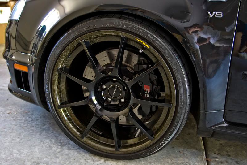

All posted before ... I like the works and Dymag

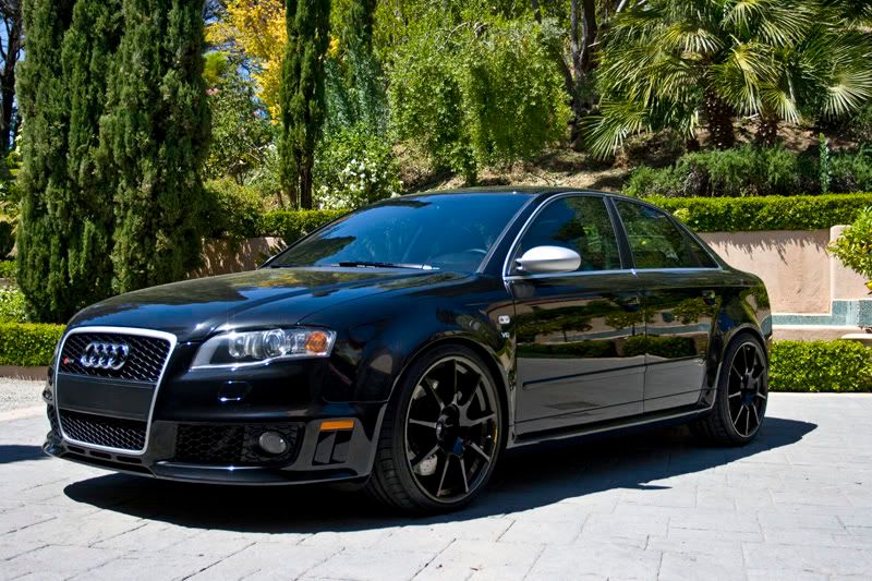

They look mint!

This is Jerome's car JD engineering, S8 20" wheels with spacers. looks good IMO

Do the wheels rub against the arches with the 20"? I would love to hear back from those who have fitted the larger wheels in terms of the benefits and downsides to having a larger wheel set. They definately fill the arches well.

Appologies it's "JEROEN' from JDEngineering not one of the Jackson 5!! :wink:
I have seen pictures of this car on the ring so guess it doesn't rub??

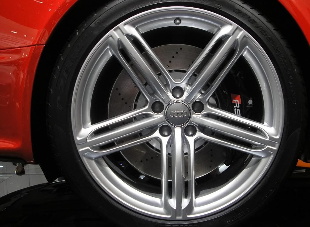

Do the S5 20" RS4 wheels fit without spacers?

ARSEY4 wrote:Do the S5 20" RS4 wheels fit without spacers?
The S5 wheel has an offset of ET29 so it should be OK for the RS4.
The only issue will have with this applications, the S5 has a different hub center bore 66mm against the RS4`s 57.1mm. So you will need some spigot rings to suit.

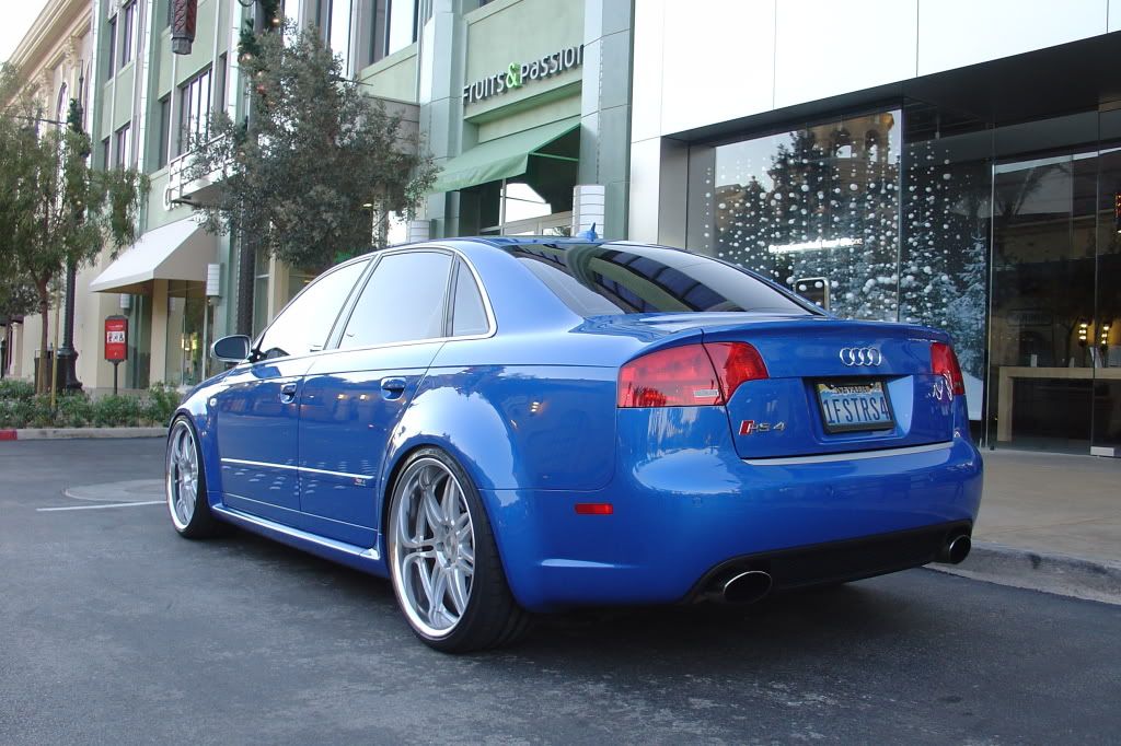

few more from RS6.com ..

Post by klauster » Tue Apr 28, 2009 3:45 pm
those RS6 alloys really do look good on the RS4, especially in that darker finish... im really trying not to, but your making it very hard

Post by P_G » Tue Apr 28, 2009 4:23 pm
Just a pity they sit on spacers.
