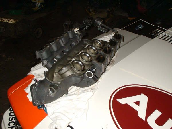

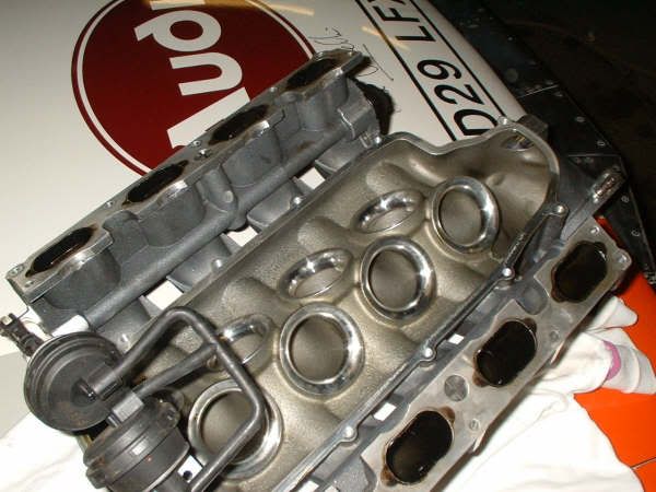

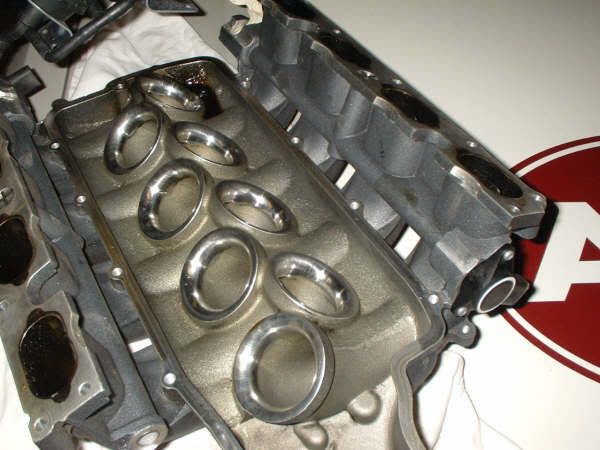

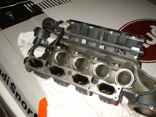

Your wish is granted. I began the work last evening. I am glad I have a new one to work on, as the thought of removing the one in the car, performing the work and then getting it back in the car in a relatively short amount of time was not realistic. I spent a little over an hour on one port and it shaped up quite nicely. I will need to spend more time on it with a finer grit tool to get a better finish. Once I get one port done, I will post a few pics. The "lip" blends in quite nicely and it looks like quite a bit of work is possible on the short side radius of the port leading away from the trumpet - which is good since that is the area of the port that the airflow tends to follow. I am optimistic that the results will be noticable. 0-100 in 9.4? I think I'll need the help of some European "petrol" for that;)
As promised, here is a pic.
Seems to be going well. One port is done, I hope you can tell which one it is! I am of course leaving the polished inlets the way they are and am just blending them into the port as far as I can. The reshaping is modest and hard to describe, but its working out pretty good. There is a significant bump on the short side radius and if I can figure out a way to get a picture of it I will.

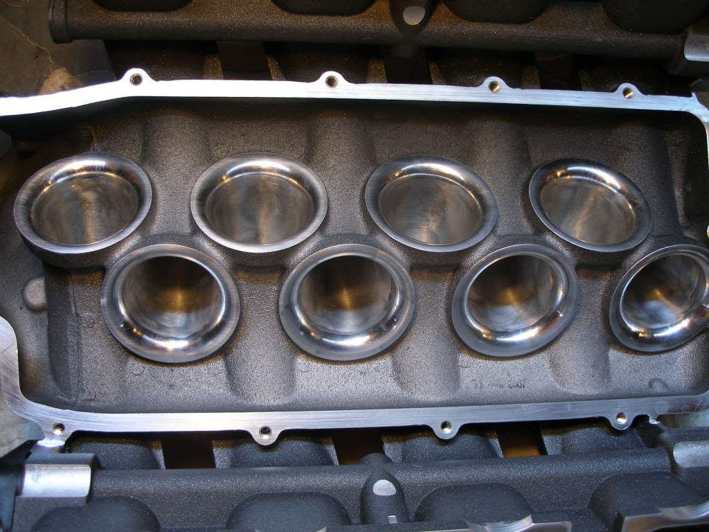

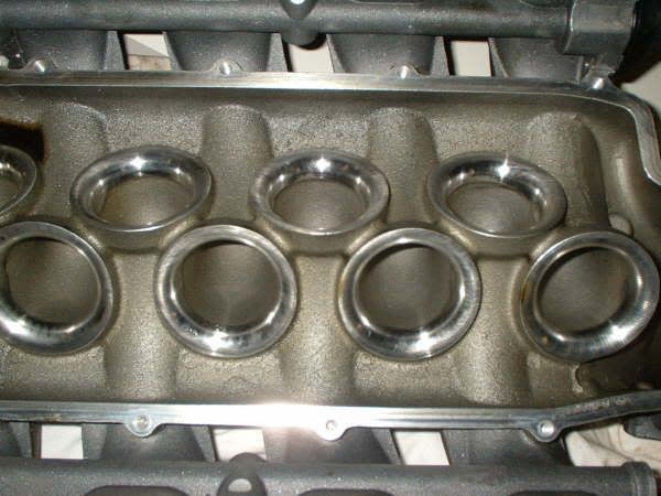

Got it done. Once I developed a routine (and identified the most effective tools, and figured out how to arrange a vacuum to quickly eliminate all the particles I was generating so I could SEE...) I could do one inlet in about 30 minutes. I think Anto also had the inlet flaps removed and may have done work on that end of the port. That would take considerable time. That end is pretty clean from the factory and I really didn't want to mess with the flaps or the shaft they mount to. Anyway, the next step is to get my car on a dyno for a baseline run and HP figures before I swap this one into the car. It is the holiday season, so it may not happen soon. When I get all the info together for the comparison, I'll probably start a new thread... Thanks for the nudge Anto! It's a fun project to be working on.
