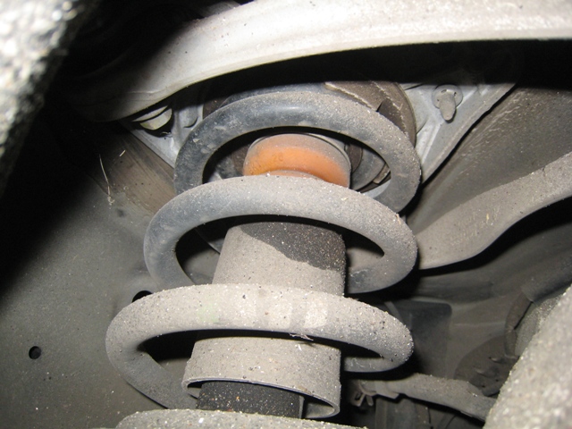

Just had the annual service for mine down at APS. After an oversteery moment the other day I asked them to look at the dampers. And I have one leakingDavid_R wrote:1 Dom81 - Avant - 7,500 - Camberley - May 08 - Fronts & Valve

June 07 RS4 Avant - 19K miles from new - OSF Leaking. 90% motorway driving.

Well, 10 days ago my car was serviced and I asked them to check the shocks due to the handling feeling a bit "loose" - AOK was the verdict.
Yesterday something didn't quite feel right with the car, and at slow speeds there was a very strange sound coming from the NSF. Checked today and it looks like the NSF shock is leaking. Could this have happened in 10 days (and 200 miles) or was the dealer talking bollocks?!
Those with knowledge of this, based on the photo is this going to need replacing ASAP (As Soon As Parts are available
), or will it come under the "minor weep, keep an eye on it" school of thought from the dealer?
Chris
06 Daytona RS4 Avant (B7)
Can't be sure but have my suspicions....Could this have happened in 10 days (and 200 miles) or was the dealer talking bollocks?!
Personally I don't have the expertise to give a view based on the photo but if the handling is being affected I don't see how anyone in their right mind would say "minor weep, keep an eye on it". If they do I would ask them to give you a letter stating that they believe it to be safe to drive.Those with knowledge of this, based on the photo is this going to need replacing ASAP (As Soon As Parts are available ), or will it come under the "minor weep, keep an eye on it" school of thought from the dealer?
Thanks for the reply, hanbury.
Thing is, the tyres are pretty worn and due for replacement and I suspected that was the cause of the handling changes and increased on-lock noise, which is why I didn't worry too much after the delaer gave the shocks the all-clear. But the noise at least has got much worse over the last few days, strangely from the very moment I picked it up from the dealer on Thursday after having some minor post-service work done. As they'd just done a 25 mile test drive I'd have thought they'd have noticed something wrong themselves, really.
Anyway, I'll be popping down there later with the photograph and see what they think ...
Chris

drcarrera - Guildford Audi gave mine the all clear, I was certain it was not correct so took it to a dealership that had real experience with the RS (Camberley). This was out of my way, but it paid off because as it turns out I have both fronts leaking!
In closing, take it to a dealer that has the knowledge to pass judgment on the case, any other will just pass it off as it 'just being you'.
They're going to get it up on the ramps and give it a check tomorrow morning. Service guy didn't seem to think it looked too bad from the photo but was at a loss as to why the technician didn't mention it when they were checked two weeks ago!
This is Newbury, by the way. I may as well give them the chance to sort it out first, seeing as it's five minutes from work, whereas Camberly's over an hour!
Chris
