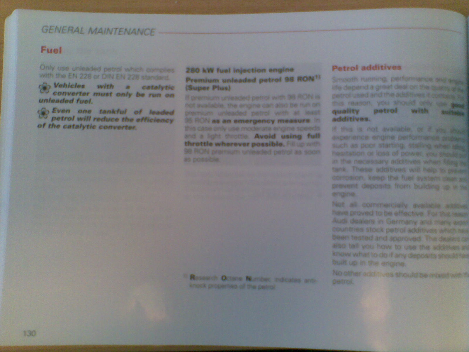

Post by mbelle » Tue Jun 10, 2008 2:59 pm
PetrolDave wrote:NONE of them use the word EMERGENCY. The true position is that 97 octane is recommended but that 95 octane CAN be used (with loss of performance) if 97 is not available. There is NO requirement to refill with 97 ASAP.
I have to disagree with you PetrolDave – my B5 RS4 handbook clearly states (and I quote)…
Fuel
Premium unleaded petrol 98 RON (Super Plus)
If premium unleaded petrol with 98 RON is not available, the engine can also be run on premium unleaded petrol with at least 95 RON as an emergency measure. In this case only use moderate engine speeds and a light throttle. Avoid using full throttle wherever possible. Fill up with 98 RON premium unleaded petrol as soon as possible.
(Apologies for poor pic quality...)

PetrolDave
Posts: 7599
Post by PetrolDave » Tue Jun 10, 2008 3:33 pm
mbelle wrote:my B5 RS4 handbook clearly states (and I quote)
I don't doubt that for the B5 RS4, but since this is the B7 RS4 forum and we're talking about the B7 RS4 I don't see it's relevant...
And the B7 RS4 handbook does NOT state that.

Post by mbelle » Tue Jun 10, 2008 4:12 pm
Fair enough
