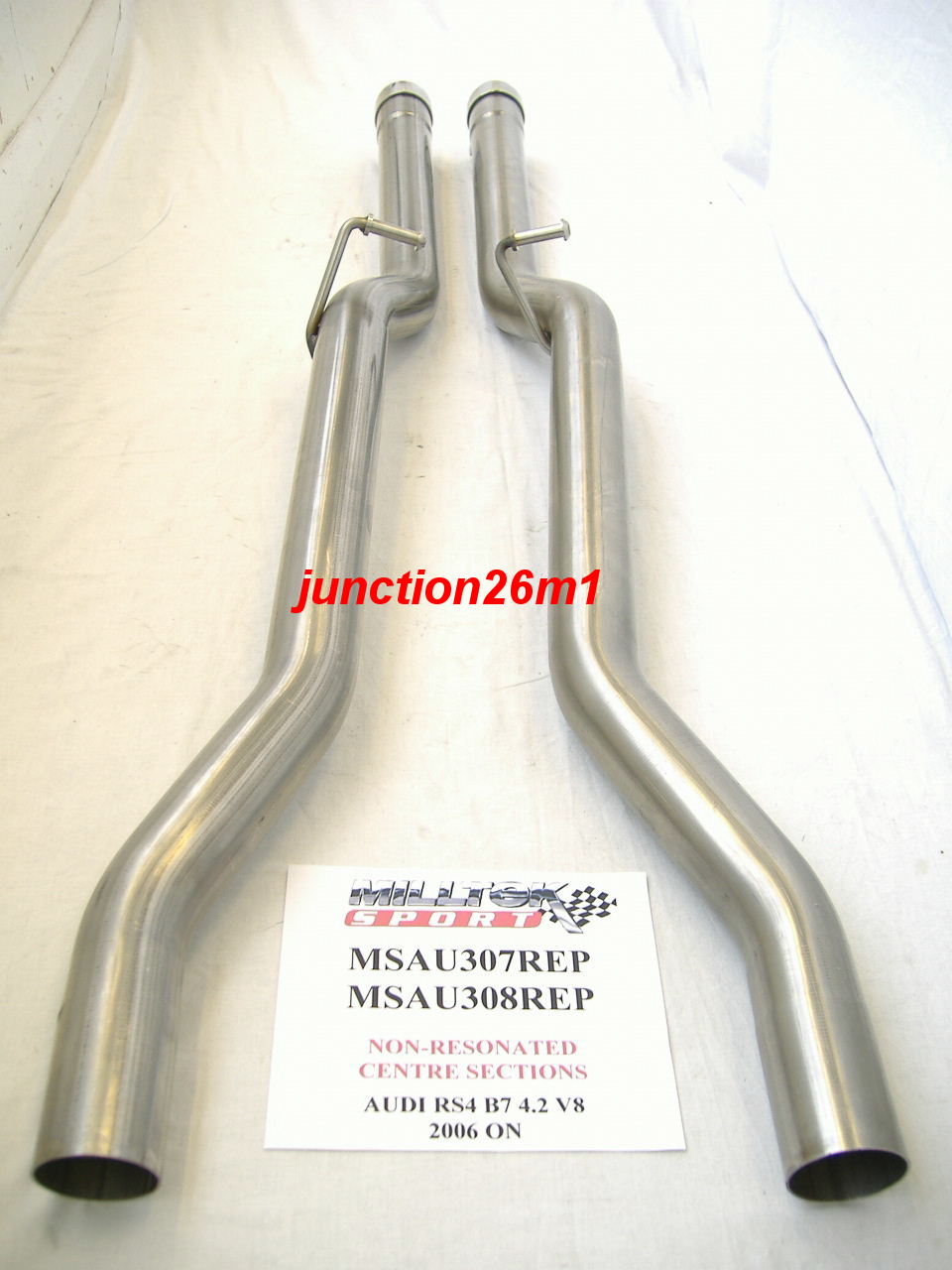

Just a quickie - anyone know the dimensions for the stock exhaust mid-section? I've just bought the Milltek mid-sections (attachment) and would like to confirm that they will fit with the stock front and rear sections that I am leaving on.

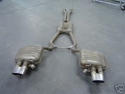

I think you will have fun fitting it, as I suspect the OEM exhaust has different lengths to the couplings, let alone possible diameter changes ...

I suspect you are right and was wondering if anyone could be definitive about things like couplings and diameter. Milltek is 2.5" but I can't find any info on the stock part's diameter.

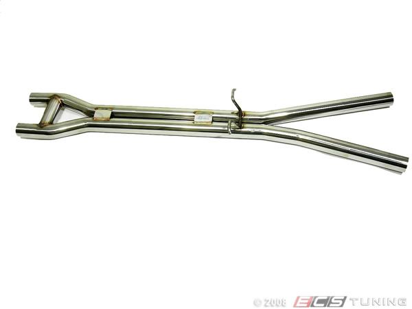

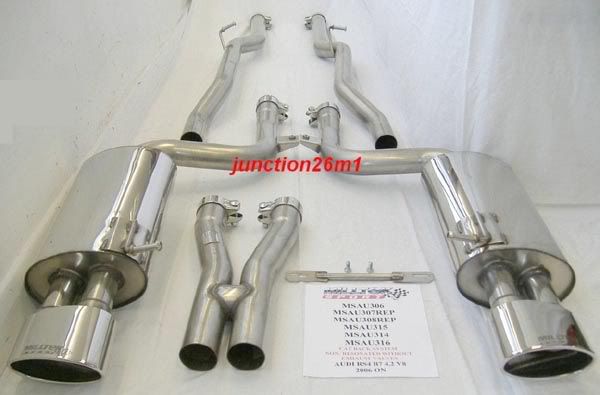

I think you are missing an extra bit
You need the extra small bit that goes to the cats ...
Note the shape and length of the ECS one

The ECS is about $200 to ship to Europe, so a TUBI 'H' part may be an option ... I just waiting on if they will supply this on it's own ....
I would get rid of what you bought or send it back ..
