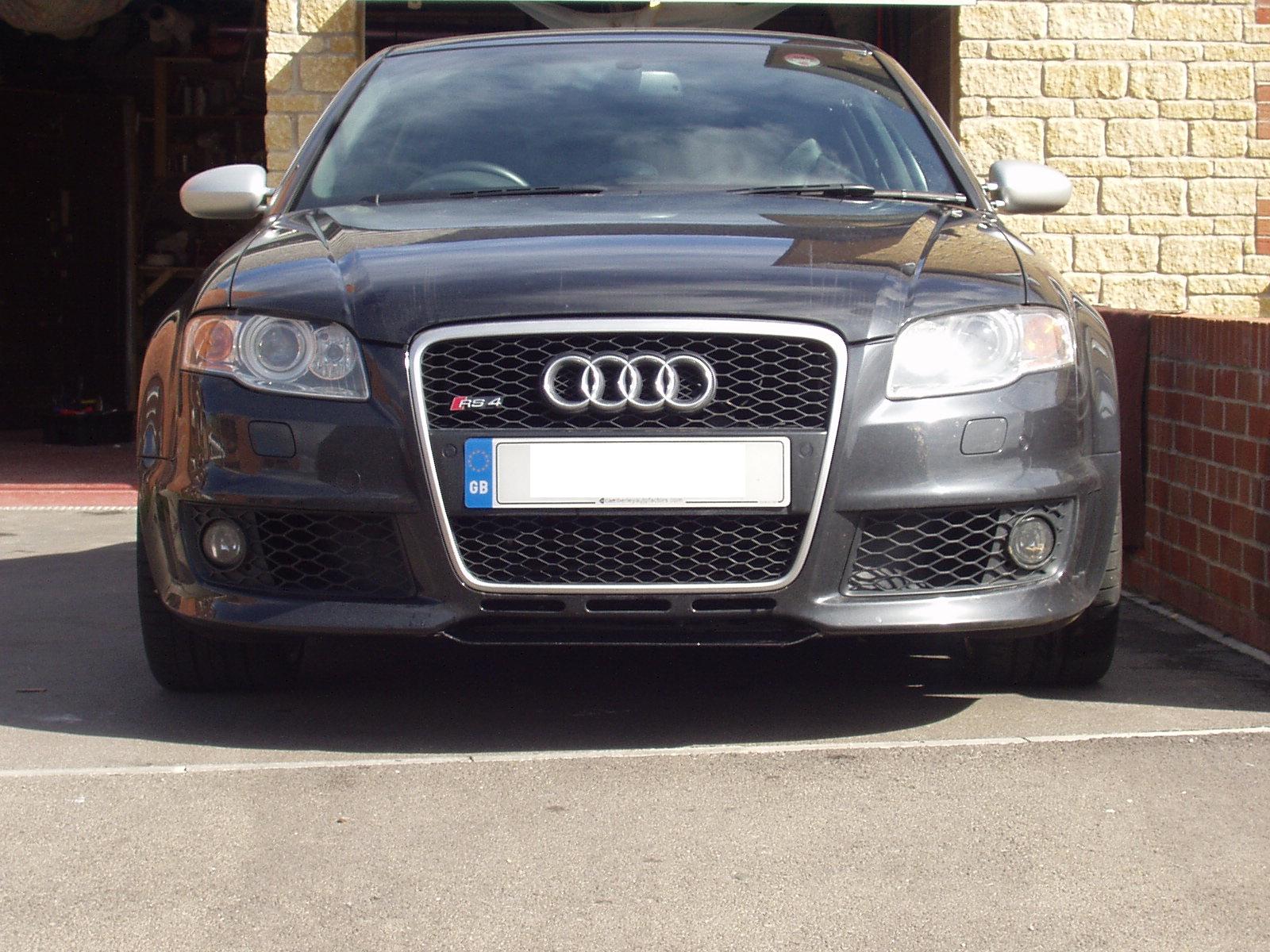

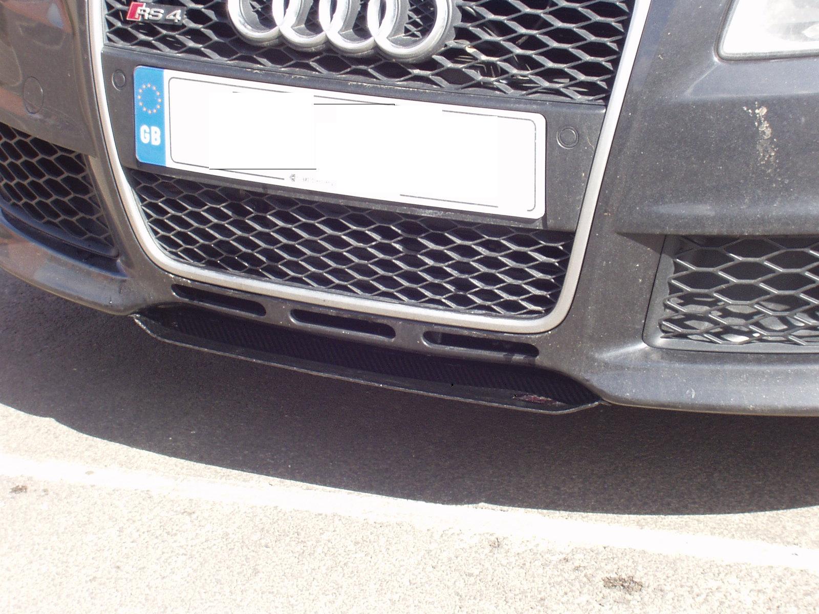

Well finally got around to it and have a mold to re-produce if enough interest. Bear in mind it is the first one I have done and I haven't finished it off. I just wanted to see if the things works - and it does. Below about 70 the oil temp is similiar to before but it recovers much quicker. Above this (and a lot above this) the temp actually drops off. On a private track I started at 80 and 97degC and by the time I had got to 120 and held it for 10 seconds or so the temp had dropped to 95degC. I have a slight mod to make but it would appear to do the job.
Answers on a postcard....? If enough interest I am going to sell it through VAG Parts as they have shown an interest.
It has been more time consuming than the std flat replacement I did the other week.

The clearance is obviously less than std as the std part is flush but it is not excessive, it adds about 20-30mm.
This unit replaces the std one and come's prep'd but not drilled as the hole position varies ever so slightly between cars. So at worse case you have to drill a few holes in it and use the std screws to screw it in or I could drill it and then it is just an unscrew/screw job (I could even provide new screws). I will be working on getting a finished article to VAG-Parts at the weekend, I'll take some photo's for you guys at the same time.
