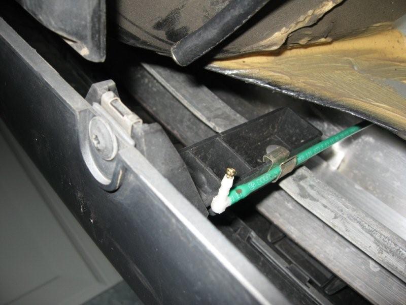

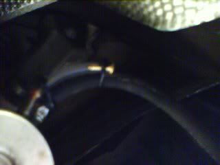

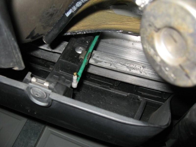

Hi guys, This is how I did mine...effortless and truly worthwhile. Cheers.
Here's my version of disabling the valve.

I separated the black tube from the inlet and plugged the respective holes with wood screws. Then I just cable tied the 2 together to avoid the black pipe flapping around. I left the metal clip at the end of the black pipe intact.

Ozrs4 wrote:Hi guys, This is how I did mine...effortless and truly worthwhile. Cheers.
If you do it that way around, it looks like you can just push the black hose back over the white fitting with the wood screw in it, and then the vaccuum is blocked and there are no exposed ends and nothing flapping around.

Hmm, I did think of that but couldn't find any double ended screw that has different diameter to fit both end. The gold screw I have in the white adaptor is smaller than the black tube and it doesn't fit tight. I guess anyone trying this method just trial and error until you can find something that will fit both ends and holding it together like you say and yes it would definitely be a "nice and stealth" method. :thumbs:
The black tube is quite rigid and it doesn't flap around. I guess I can get down again and cable tie the two ends together.

Will the black pipe not just push over the screw head onto the white bit? It looks like it should.

jackwood wrote:Will the black pipe not just push over the screw head onto the white bit? It looks like it should.
Jack
I did try but it's loose and the black tube would just come off. May be if I can try finding another gold (or steel) with a bigger head that fit the hole of the black tube. I still like the "threading" in to seal the opening. I would hate to think it comes loose without knowing and all the dust will get into the valve attentuator.

I cut the head off the bolt and pushed it into the tube and got the same dia tube, an inch long,pushed the other end of the bolt into that and reconnected it, looks standard but ain,t.
