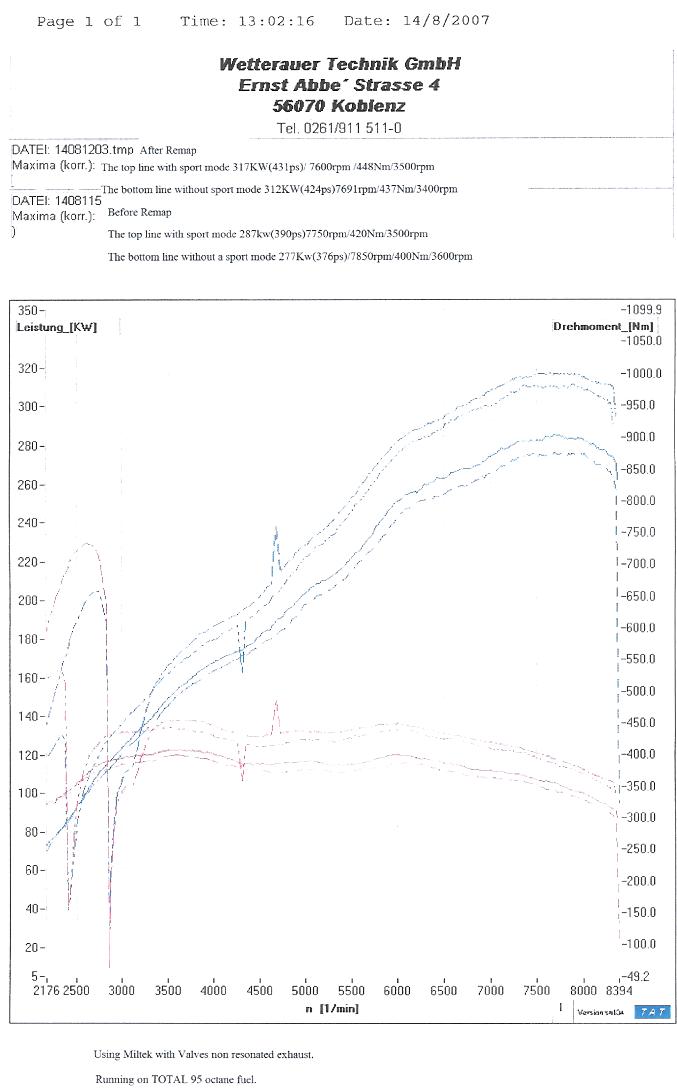

Hi guys this my dyno result at germany ... very interesting with the result
as i'm using miltek valves non resonated it's stated clearly as the engine breath better with sport mode ... now i'm imagine if i pull the vacuum hose at the actuator flaps maybe it will be slightly more hp.

here

This is the tuner dyno graph ..
Post by rs4mal » Sun Sep 16, 2007 5:33 am
here

It was a good deal as i only pay 950euros included dyno... i said to the guy thah i wanna see the comparison between standard and after remap..
i must say i was satisfied with the different the car so much responsive especially at lower end and high end.
i did some test using performance box via gps
0-100km 4.2sec average was 4.3sec
0-160km 10.3sec avg was 10.4
before remap wa
0-100km 4.5sec average was 4.6sec
0-160km 10.7sec average was 10.8

Those are huge figures dude.. 20kw @ wheels !!! so am i right in saying pre looks like 207 kw@wheels and after looks like 227 is@wheels in pic 1

sykotoy wrote:Those are huge figures dude.. 20kw @ wheels !!! so am i right in saying pre looks like 207 kw@wheels and after looks like 227 is@wheels in pic 1
They are flywheel figures.
370 Bhp before the remap in non sport mode and 425 Bhp in sport mode after the remap.
A gain of 55 Bhp, on 95 Ron.
Just think of the gains had it been filled with 100Ron.

What does 428 nm torque translate to in lbft !?!?
t_urbo
Posts: 597
Joined: Thu Apr 26, 2007 7:11 am
Post by t_urbo » Mon Sep 17, 2007 1:36 pm
djcevo wrote:What does 428 nm torque translate to in lbft !?!?
315.7
315.7
So BHP is up considerably but torque is down. Most remapped cars are up on torque.
t_urbo
Posts: 597
Post by t_urbo » Mon Sep 17, 2007 3:17 pm
Torque is up from 400 Nm in non sport mode pre to 448 Nm sport mode post remap.
