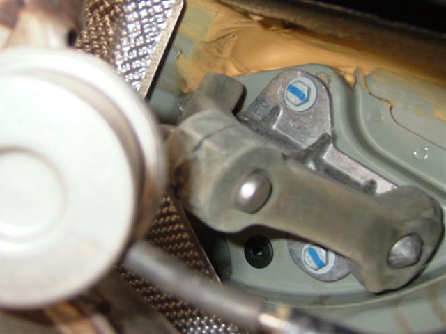

Alex, job done took 5 mins each side.
Lay under rear you will see the pipes (one each side black rubber) using longnose pliers carefully ease off the pipes, find two 4mm threaded bolts, remove the heads, cut them to 1 1/2" long , taper the ends with a file or grinder if you cant get them into the rubber pipes, I had a peace of 1/4 OD 1/8 ID tubing, you will need to buy/find some.
cut this in two pieces 1 1/2" long (2).
Push one end of the bolt into the existing rubber tube and the other into the new piece and then connect into the diaphragm, when you've had enough or need servicing, remove and re connect.
Photo attached it's the pipe at the bottom, bit blurred sorry.

So what you are saying John is with the bolt you are blocking the vacuum to the diaphragm.
Yep the bolt minus the head is what stops the vacuum, and it goes back to normal in one min flat this way, so easy.

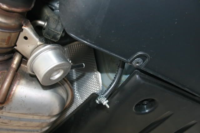

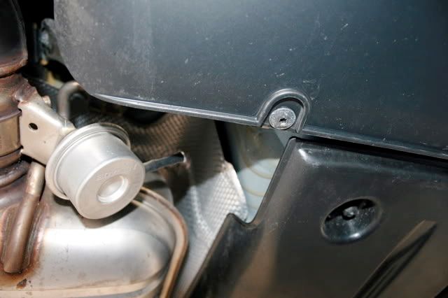

Post by ChrisRS4 » Fri Sep 14, 2007 5:32 pm
I just went and took a couple of pics of mine, might help..
I used a bolt and a mini clamp on the vacuum hose
And then tucked it up into the bumper. I had some silicone vacuum hose laying around, so I cut a short length and used a woodscrew in the end, and slipped onto the valve inlet.

John and Chris, thanks a lot for the pics...very useful. Will now have a think about how to do mine.
