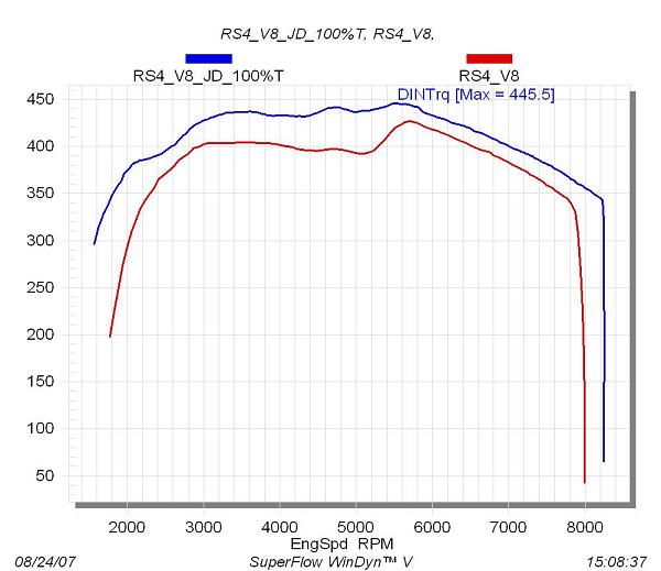

Hello !
Difference with valves open or closed is about 10Nm torque between 3400-5000 rpm. Max bhp is not different,
because the valves are also open from 5000rpm @ WOT (full throttle) in normal mode. I have some dynoplots to prove, I'll try to place theme here….
Throttle is only 50-60% open also in S-mode till 5500rpm, but only in 1, 2 and 3 gear. From 5500rpm 100%.
S-mode will give 100% throttle in 4, 5 and 6 gear from 0-8250rpm.
Regards,
Jeroen

RSjd
Posts: 17
Joined: Tue Aug 07, 2007 2:22 pm
Location: The Netherlands
Post by RSjd » Fri Aug 24, 2007 2:50 pm
Here you can see "the 5.5k rpm kick" (redline), standard RS4 in 3th gear, Torque(Nm), that's what you feel...
Blueline is 100% throttle opening all the way, plus some more re-map work. So that can be mapped out, SIMON :wink:
Regards,
Jeroen

RSjd
Posts: 17
Post by RSjd » Fri Aug 24, 2007 11:57 pm
@ Paul,
The only difference in Sport-mode is exactly what you said, nothing more !
The only performance win is very small, thanks to the exhaustvalves, 10Nm more @ 4500rpm, as you can see the difference in thirst dynoplot the upper blue and red torque lines.
So there is no max. throttle angle difference in Sport-mode.
This is only gear depending.
In 1, 2 and 3 gear, Throttle is only 50-60% open till 5500rpm, from 5500rpm > 100%. You can see the redline in the second dynoplot, "the 5.5k rpm kick"
In 4, 5 and 6 gear, 100% throttle from 0-8250rpm. See the blueline.
Simon,
Yes they are from my own car. I did the mapping myself. No it has not the infamous 5.5k rpm kick anymore. I mapped it like the blueline, 100% throttle through all gears.
Also exhaustvalves allways open in S-mode, not only from 4000rpm in the 1,2,3 gear.

RSjd
Posts: 17
Post by RSjd » Sat Aug 25, 2007 8:25 pm
W8PMC wrote:Jeroen, sorry as this is probably me being thick but can you clarify this one point??
I'm not getting the throttle vs exhaust flap scenario?? In sport mode the exhaust flaps are open from 0RPM, however in non sport mode the flaps open at 5500RPM?? This being the case, why do i feel the 5500RPM surge in both Sport & non sport?? Back tracking, are the exhaust flap & throttle alterations (assuming their are any) non dependant on each other?? So the surge at 5500RPM is purely down to the throttle opening fully to 100% which as i think you say only occurs in 1st, 2nd & 3rd gears?? & TBH i can't say i've ever noticed the surge in the higher gears although i will try to check this out next week.
I'm sure you've answered this fully already & as above it's probably me just getting confused (easily done), but if you could explain the above in simple terms, i & many others on here would be very appreciative.
Finally, is it only via a re-map that the 100% throttle (assuming that's correct) can be achieved in the lower gears (1st, 2nd & 3rd) from 0RPM & secondly, with your map have you raised the rev limiter?? My guess (could be wrong again) that with other re-maps, the fact that the rev limiter is raised to 8400rpm would even things out when head to head, assuming you've not raised the limiter as well??
Hi Paul,
Sorry no you don't understand it completely, maybe my Englisch is not very clear, I'm from Holland :oops:
No they're not dependant on each other. And Yes, the surge at 5500RPM is purely down to the throttle opening fully to 100% which only occurs in 1st, 2nd & 3rd gears !
Finally, you are right, only via a re-map that the 100% throttle (assuming that's correct) can be achieved in the lower gears (1st, 2nd & 3rd) from 0RPM-8350rpm.
Yes, I raised the rev limiter to 8350rpm.
Hope you understand me, I try to explain more/better in the next reply :wink:
Regards,
Jeroen
