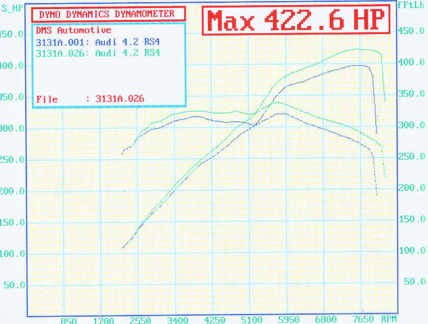

Post by simple1 » Sat Jun 23, 2007 6:32 pm
sounds like you have been fed duff info. Of all the cars I have heard of which have been tested, the calculated figure is 412-415 bhp. My own was 412 standard, so unless you have a major failure and you would be aware of it by the loss of power, treat what you have been told as garbage.
13 June 2007.jpg (148.45 KiB) Viewed 2047 times

Post by Lancia » Sun Jun 24, 2007 12:55 pm
simple1, did you have the engine out of the car to get that figure???, How did they work out your flywheel horse power????
My RS4 showed 220kw at the wheels. around 295HP. Going with 30% (seems a bit high) drive train loss that gives me around 420HP.
Not sure what you dyno graph is showing and how it would figure it out?? Then again I know nothing of dynos except anything can vary it even tying a car down too much, heat and so on???
