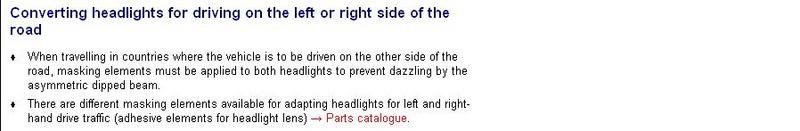

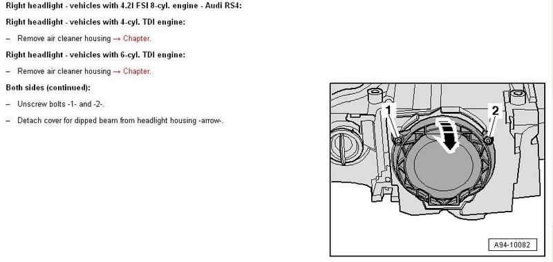

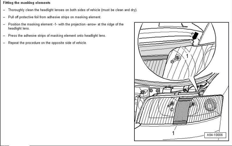

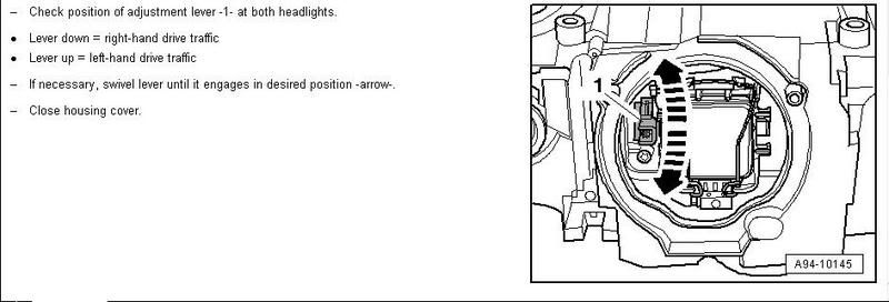

Dave - have a look if yours have this lever:
It is not clear whether this is the case for bi-xenons. Otherwise it is a case of:

GlynG60 wrote:Dave - have a look if yours have this lever:
Glyn - nothing like that on the bi-xenons that came off my RS4.
Not surprisingly since ............. those pictures are of a B6 - look at the shape of the headlamps!!!
See what I mean about all the available information being misleading!

Over on http://www.audi-accessories.co.uk/index ... ductId=242 they are selling the Audi headlight protectors for the B7 (8E0 072 100) that come with add-on beam deflectors.
Here's what they say:
"Pair of Headlamp Protectors for the Audi A4 B7 model, including two sets of Beam Deflectors and marking points etched in the plastic to locate them. The quick and easy way to set up your A4 for the Continent.
Please note; the Beam deflectors are only suitable for Halogen light vehicles. Xenon and Bi-Xenon equipped B7 A4's use a Neutral Beam which reqiures no adjustment when travelling temporarily in Europe."

However, the "neutral beam" is nonsence - the dipped beam has a clear left kick.
Looking at the images in GlynG60s post, the top two images do seem to be the B7 units, but as PetrolDave rightly pointed out, the bottom image is the B6 headlamp.
I've had a shufty at mine, and unfortunately, you do need to remove the headlamps to gain access to the rear cover (the left one is blocked by the power steering resevoir, and the right is blocked by the airbox).
Dave, you stated you swapped your orange indcator headlamps for clear indcator headlamps - did you do this yourself? If so, how did you actually remove the headlamps, because they are quite different to the B6 lamps.
