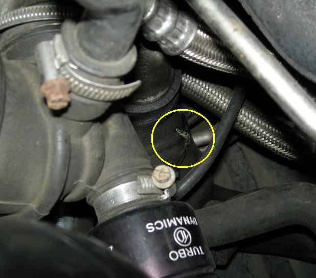

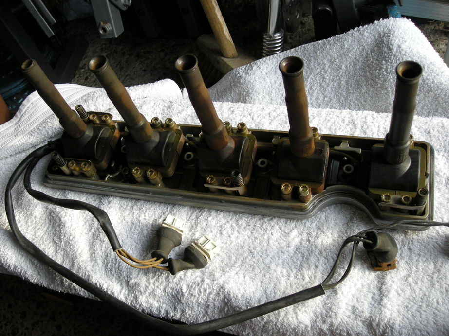

Took the ignition coil carrier off the top of the engine and found each coil pack cable, cracked at the point of entry to the coil pack and cracks to the cables at the rear of the top cover, not to mention three slightly loose spark plugs with oil round there bases. (Slight loss of compression but spark plug colour OK, Last time I trust the service agent!!!)
All cleaned up nicely with brand new plugs fitted. Not happy with the ‘Audi’ Prices for the coil pack/leads and the ‘POS’ blocks. I am investigating a replacement set, “AAN High Output coil kit” from ‘www.034motorsport’ that does away with all the old parts. Should also look neater as well, I hope. The cracks in the cables are due to heat and age and are almost invisible to the eye but a very close inspection showed various splits/cracks in the cable covering where the copper cable strands can be seen.
Only started out replacing the blown turbo output hose and having a general clean up, now replacing all sorts of bits but it will be worth it. (I will post the pictures of the converted spark plug coil pack arrangement in a few weeks.)
Splits in the coil leads are highlighted in yellow.
Bits being replaced:
All five coil packs, spark plugs and leads. (Ouch!!!)
Discarding both of the ‘POS’ amplifiers if I fit the ‘034 MS’ kit.
