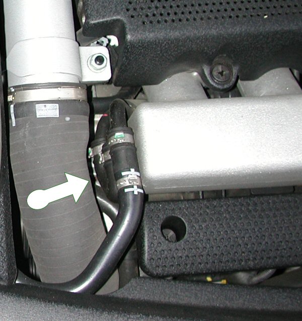

Sounds like the leak I had on my TT. See HERE
p.s. Sorry there's no pics. It's the W shaped hose at the front left top of the block.

If u have a boost leak due to the brake servo there is a good chance its this hose, its common for this hose to split in the U bend. I have replaced mine with a samco 135 degree silicon elbow. I cant remember wether its 11mm or 13mm, u need to remove the orignal one to check it properly so measure it then.
