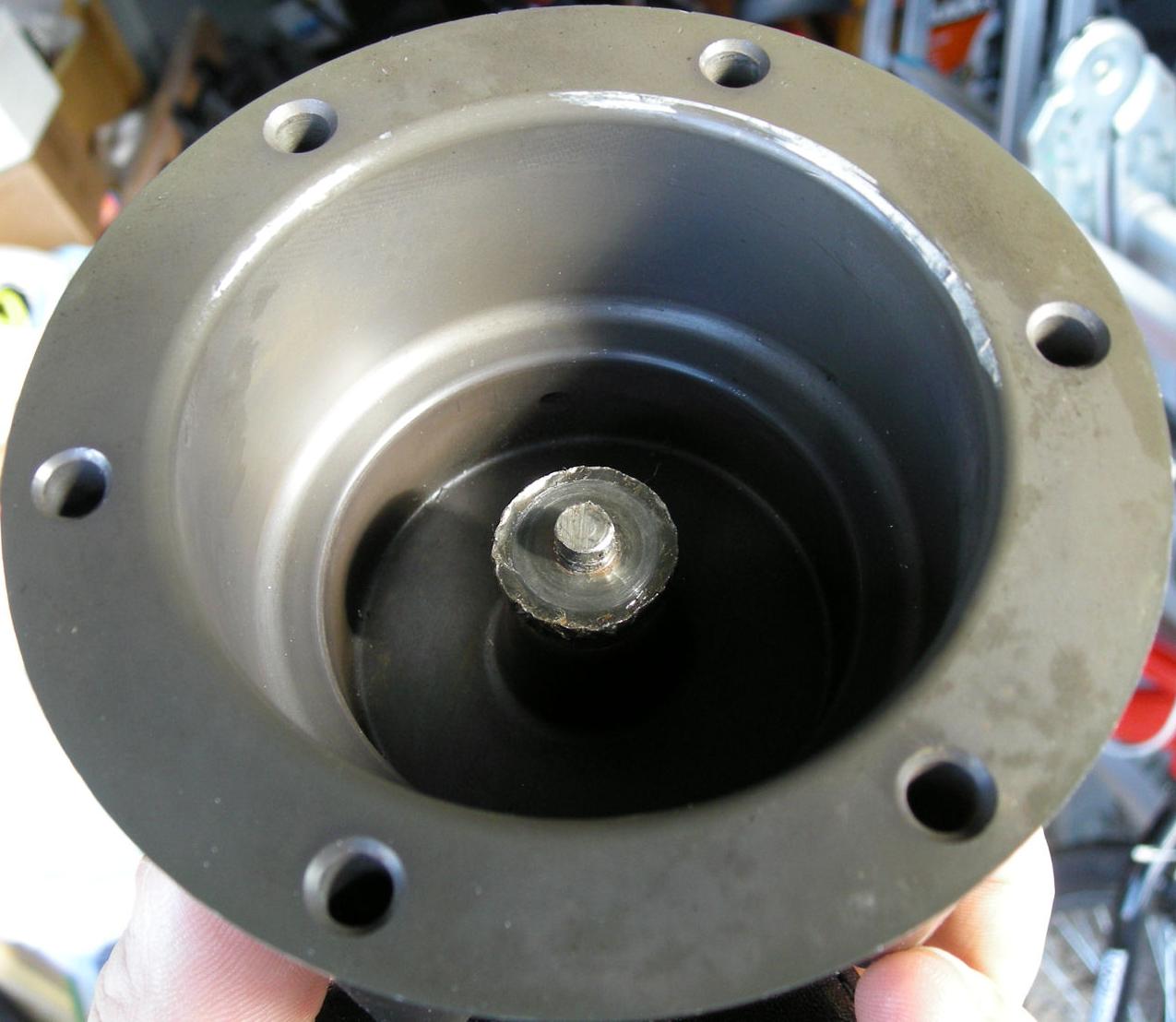

I replaced the wastegate top cover for an unmolested version where the anti-tamper cover is still fitted and the adjustment screw was still at factory settings compared to the previous owners attempt at getting a more powerful engine. (Old on the left, replacement on the right. No perch fitted for clarity)
What a transformation, no juddering at all in top gear and the all round drivability in all gears is far superior to what it was before. When I compared the original wastegate that came with the car to the replacement, even at the minimum setting, the spring height uncompressed, was already “13 to 14mmâ€
