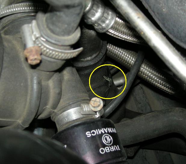

Oh I forgot to mention, watch out for the turbo charger output hose fracturing. At ‘8’ years old they will have had it and you will not know until your car loses all boost over ‘1.2 bar’, miss-fires badly and lots of hissing too.
Fit a set of Samco TCS146 hoses. (£140)
Here’s one my car prepared earlier today.
