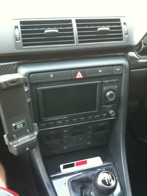

Never been a fan of the fish scale trims and as mine had a few scuffs from the previous owner and that carbon just looks awesome, I decided to give it a go.
I bought some piano black trims from eBay, just incase it all went wrong because I've got very little patience :lol:
Bought all the materials from Carbon Mods, Sainsburys and Toolstation for around £120.
Lay out the carbon and cut to size for each part.
Sand down the parts with 120 grit and degrease
Paint all parts with black epoxy base and leave for 3 hrs
Wrap the parts in carbon like wrapping presents, taping the edges to the rear of the parts
Paint with clear epoxy and leave over night
Sand with 120 grit to get a nice base.
More epoxy and leave for 3 hours.
More epoxy and leave overnight. (the point I'm at)
Tomorrow I'll tidy then up with a Dremel and start wet sanding to flat polish them, ready for a UV protective clearcoat.
More pics when I'm finished but all in all not as hard as you'd think and quite enjoyable.

Had a few problems with the clear epoxy. Because of the rounded shape of the trims it tends to run off of them as it sits, so im getting a nice layer in the centre of the pieces, but very thin on the edges so kept sanding through, so I spent yesterday wet sanding and shaping and then today ive mixed up some epoxy and left it for 15 mins before use so its turned abit gluey, ive then brushed it on to the centre area of the pieces and worked outwards and once nice and smooth so only minimal sanding will be needed ive got a heat gun on it to put a skin across the surface.
Not overly happy with the most difficult piece that goes around the light switch, it seems like the carbon may have lifted at one section so it looks abit rippled at the moment, but if its f**cked Ill take the one out of the car and start again.
Pretty sick of it now though :lol:

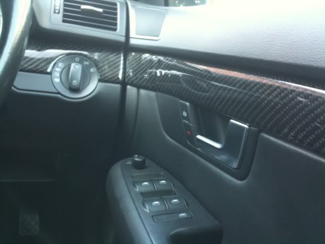

Heres the latest. Lacquered and drying, just a quick de-nib then polishing to go.

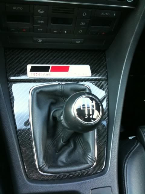

Front & Rear ashtrays are done, gear surround needs trimming because the layers add have made to too big and the ashtray also catches it. Dremel to the rescue!!
Im not happy with the front passenger side trim, but it'll have to do for now. In a few weeks I'll cover the one I take off to replace it. Already scrapped my first attempt at the light switch surround and started again with another.

Still needs abit more polishing, but it all comes off easily so I can do a bit at a time
