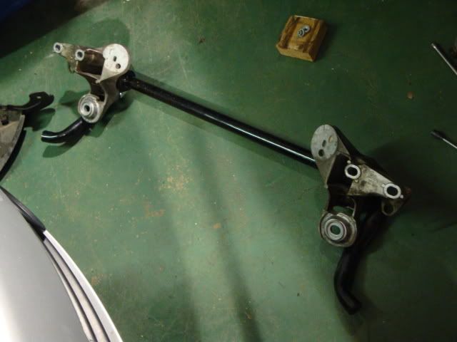

Mounting brackets and anti-roll bar removed:

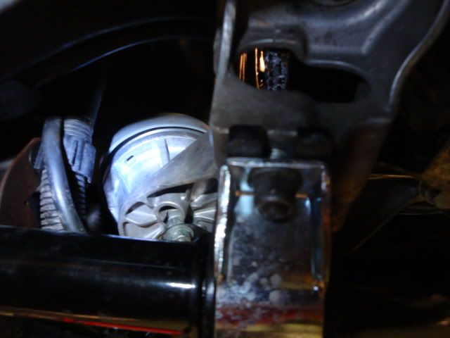

Engine mount:
That pic doesn't do the lack of space justice.
Engine mount:
Engine mount:
