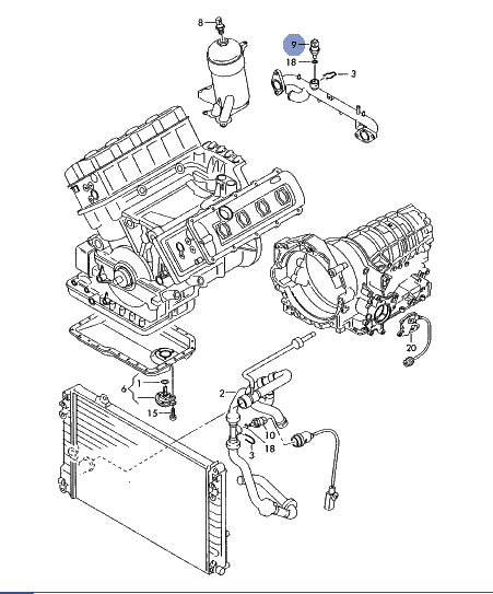

I could not for the life of me find the temperature sender. Can anyone give me a idea of where it is? I had a good look all round the back of the engine, and couldn't see anything remotely like it.
neckarsulm
Posts: 4468
Location: The Point
Post by neckarsulm » Mon Feb 08, 2010 10:12 pm
HTH
Posts: 20343
Post by Shoppinit » Mon Feb 08, 2010 10:43 pm
Cool. Thanks. I saw that metal pipe, but didn't see any sensors going into it. I'm going to have to have another look :oops: At least I know I was looking in the right area now!
neckarsulm
Posts: 4468
Location: The Point
Post by neckarsulm » Mon Feb 08, 2010 11:37 pm
Do let me know, maybe it's different on your build.
Posts: 20343
Post by Shoppinit » Fri Feb 19, 2010 7:47 pm
Right, that was a bastard job. The sender is almost completely hidden, so it you don't know exactly where to look, you'll have real difficulty finding it. Anyway, job done, with slightly more than the usual amount of skin lost. Here's a pic to help others locate the sender. In this picture, the electrical connector is off, and you can see the green sender. As you can see, the sendor is almost horizontal, as opposed to the exploded diagram above. I put a little cross on the sendor so I didn't confuse it with the new one.
