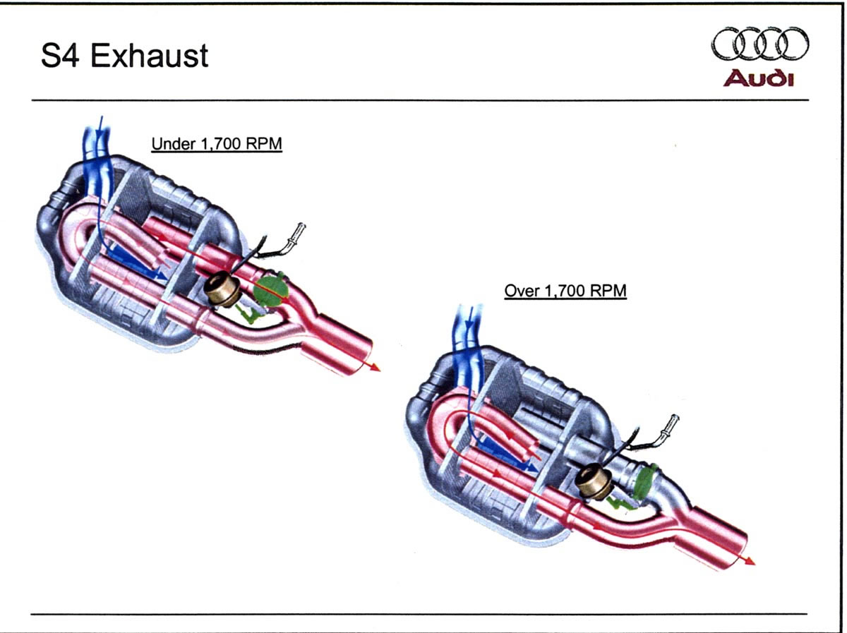

Found this diagram on the Milltek website.....the valves are on the top side of the rear boxes.

Yeah didnt look hard enough! Do you notice a big difference in sound and performance?

Post by BlingBling » Sat Sep 22, 2007 11:16 am
The only thing you can do is carry out a mileage check. Are your back boxes cylindrical of box shaped as perthe pic above? If cylindrica then you may well have aftermarket back boxes.
