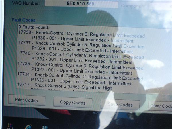

DavidT wrote:The ECU will be controlling the 'knock' (if there is any) anyway. You will not hear the 'pinking'.
Ohh look, i was right - i could hear DET.
You about sweeping statement isn't quite as correct as you'd like it to be now is it :roll: *
*see attached image
Tartan_Rob wrote:I would question any tuner that did not know this and thought it better for the untrained and unqualified to 'listen' for pinking.
You say i'm unqualified to listen for det but yet you know nothing about me.
I presume you have seen my low post count and assumed, wrongly, that i have no experiance with mapping and it's effect's both positve and negative. :x :(
It's a shame people jump in with both feet with sweeping statements before qualifying the situation :roll:
DSC00162 (Custom).JPG (49.83 KiB) Viewed 959 times

Shame I've only just seen this. I did wonder if it was going beyond the amount the knock sensors are able to <beep> the ignition.
What fuel are you running in it? It could also be the MAF making it run lean then pinking.
Were all the faults just the knock sensors?

Post by NotNormal » Thu Mar 08, 2007 8:45 pm
Yes, all faults were just knok sensors.
Fuel, i usually run it on Total Exellium, but i put £150 worth of Shell V-power and £50 for BP Ultimate (which i'm not a fan off) through the car - made no/little difference. On shell it was slightly better - but only slightly, on the bp it made no difference
The MAF reading's are ok, had Quatronics check them today along with everything else .
I've got the stock map in for the time being, but the Revo one will be being sorted ASAP :)
