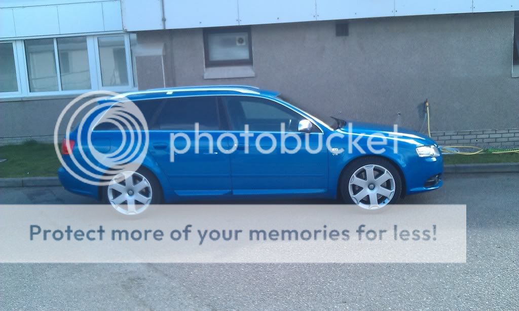

That does look a bit high at the front tbh. This is my old S4 below, sorry it's not the best photo. First pic is just after I bought it, totally standard OEM springs/shocks. The 2nd pic is lowered on H&R Sport springs (25mm drop).

Re the gaps, it's hard to tell from those pics. Is it possible to take a side on shot? Similar to the angle I posted?
