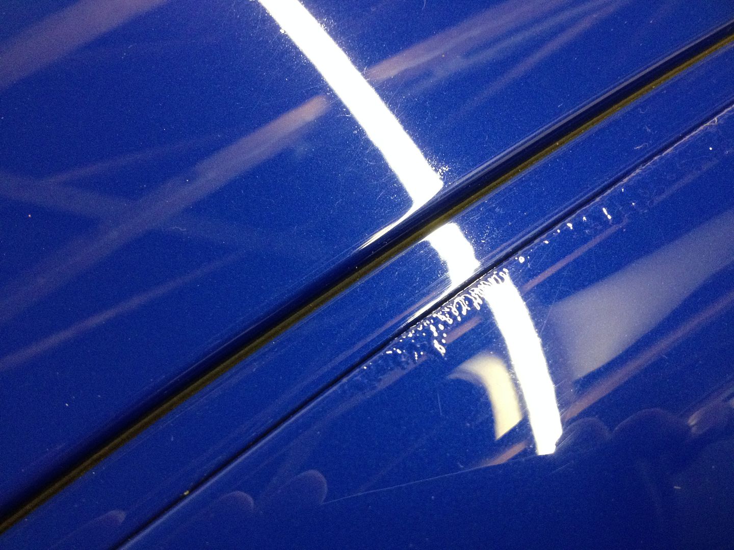

So far I've had the onset of corrosion sorted in the drivers side roof guttering all sorted by a specialist body shop. I just couldn't be bothered going to Audi and haggling over what percent I would have to contribute to what should be totally down to them as my car is well within the body corrosion warranty period and has a full service history. So I decided to go to a specialist body shop who went the whole hog in an attempt to ensure that the corrosion was removed and did everything to prevent it from returning. Micro blasted the channel back to bare metal, all bare metal treated with some type of rust inhibitant, sealed, primed, topcoat etc etc and the strip that seals the roof guttering had the rubbers replaced and the undersides treated with waxoil prior to being refitted. Whole roof resprayed, front bumper and front wings resprayed. Over the moon with the quality of their work (Mission Bodyshop - Gosport - Hampshire) total perfectionist.....

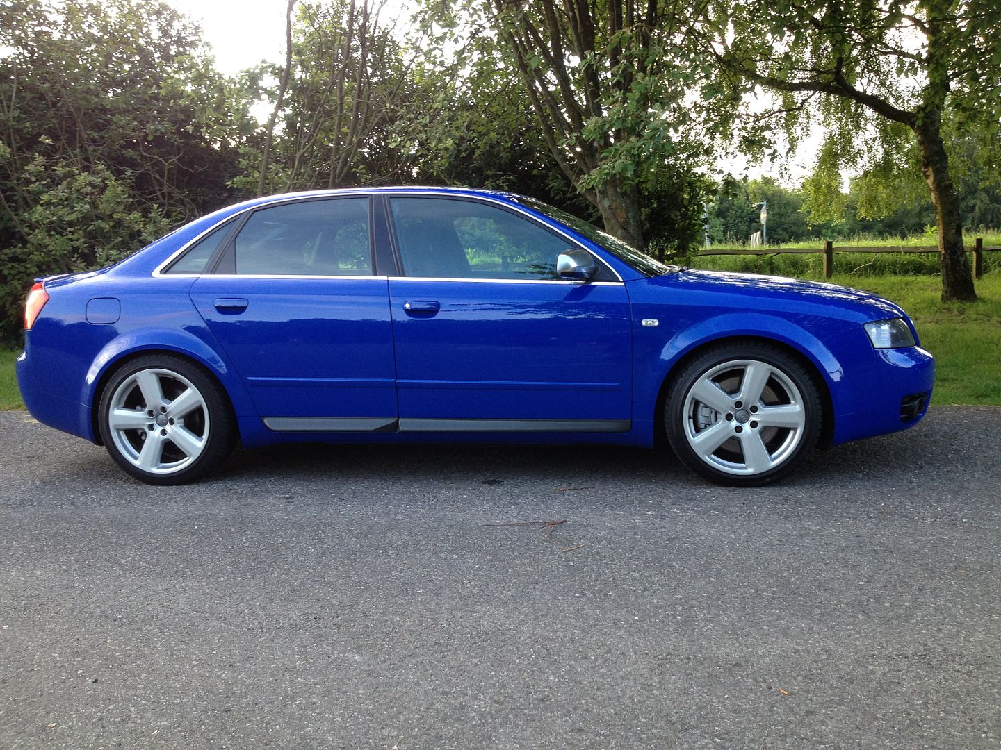

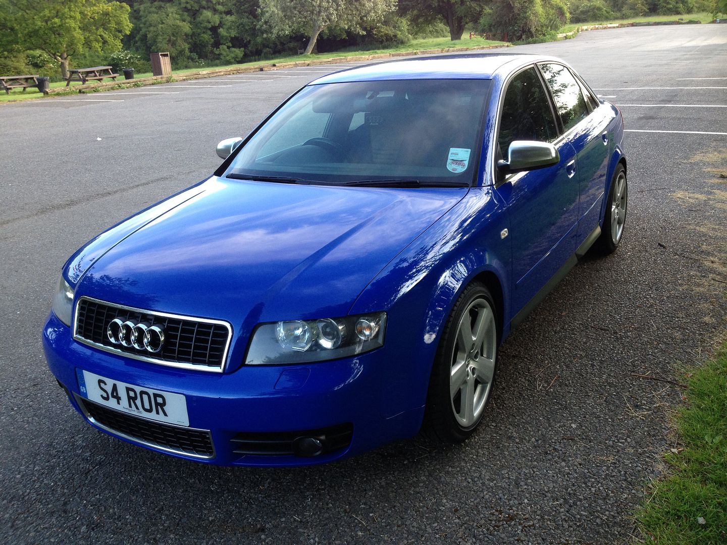

Here's the finished results - Perfect colour match, perfect finish match.

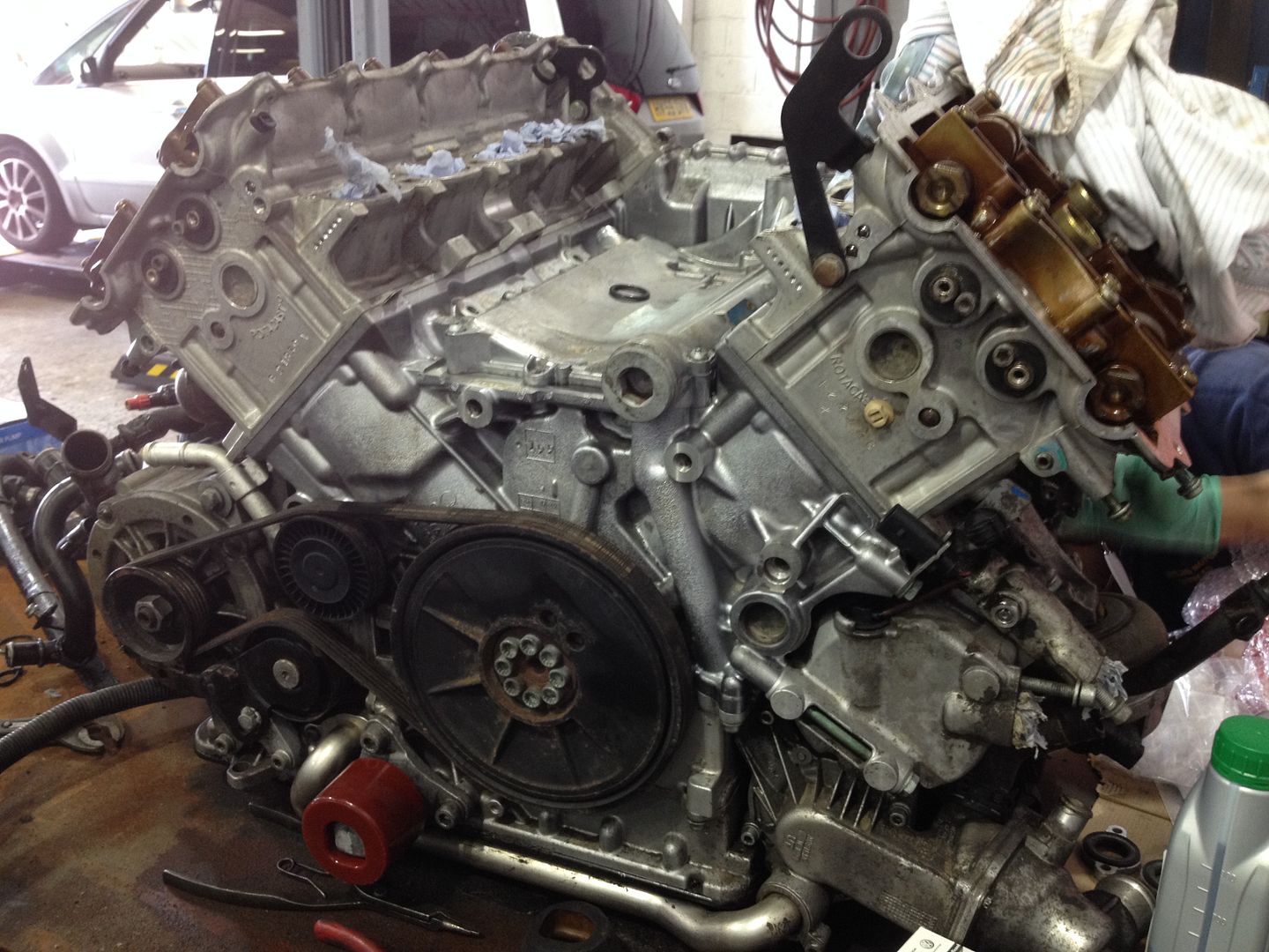

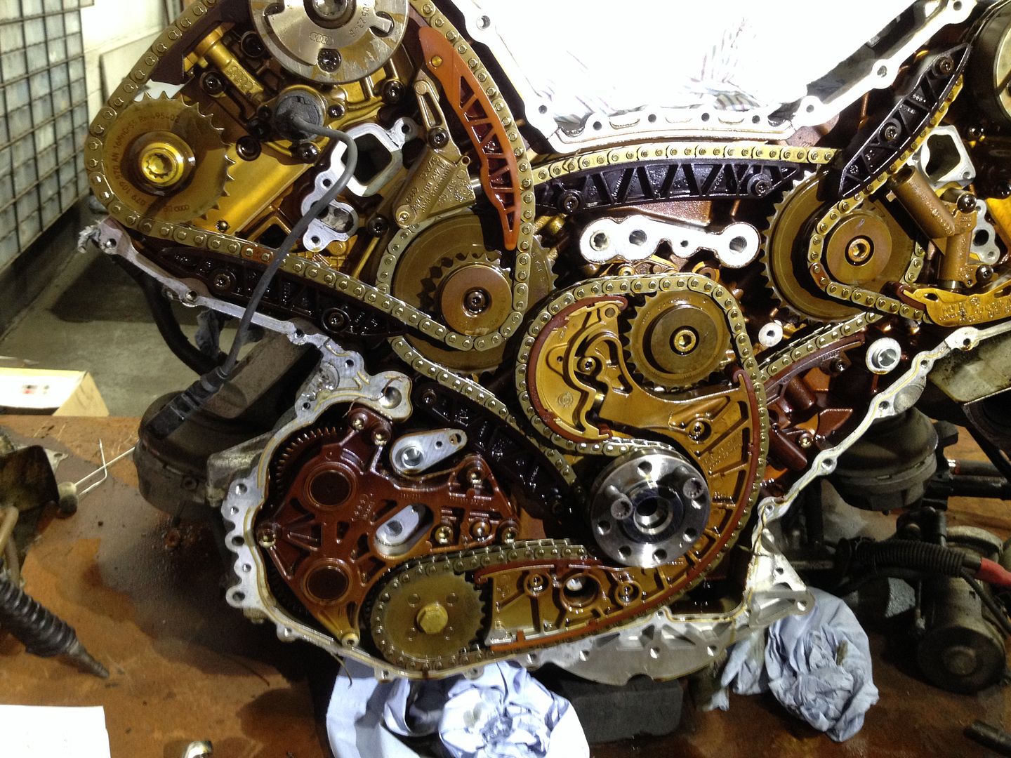

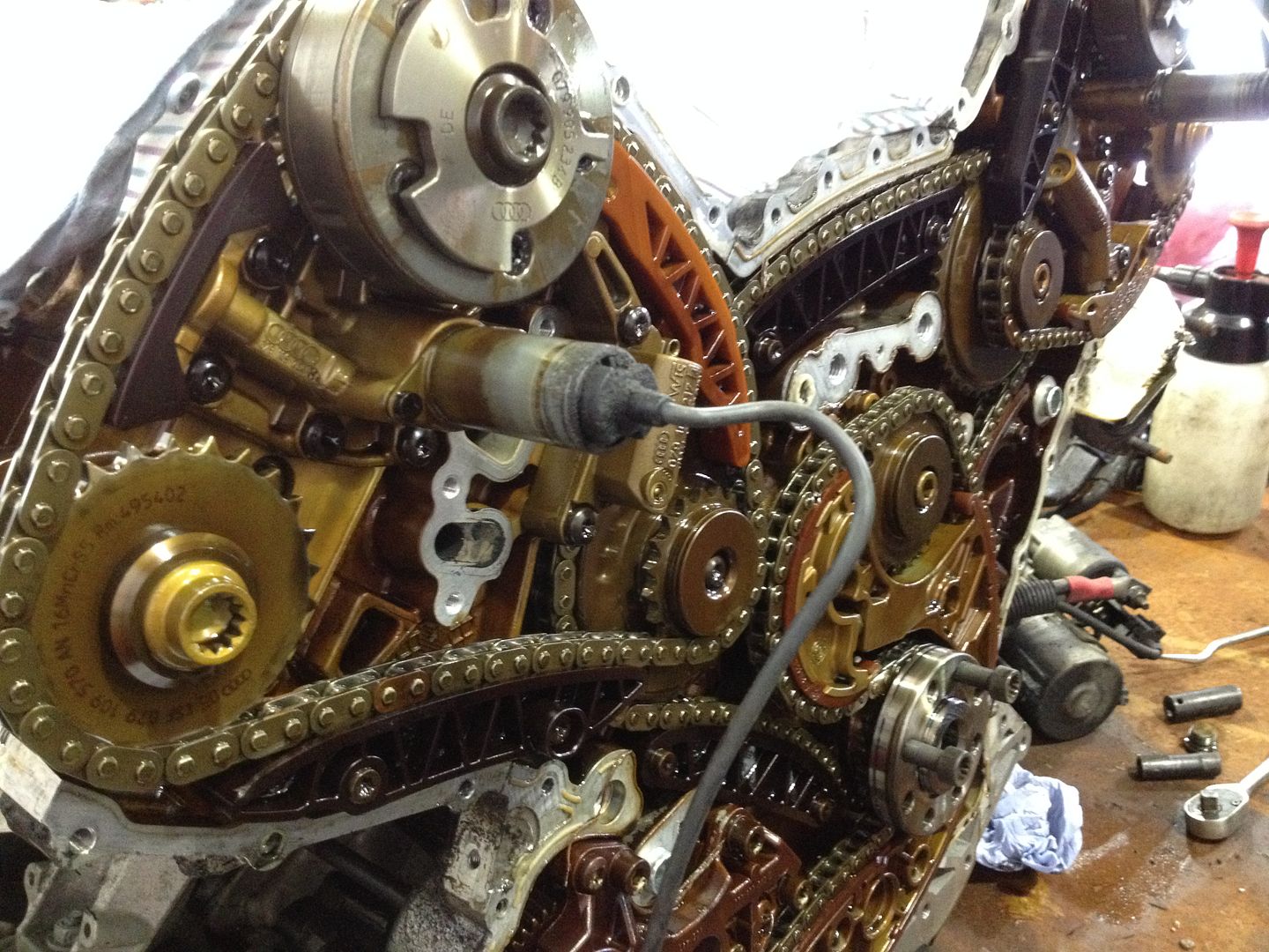

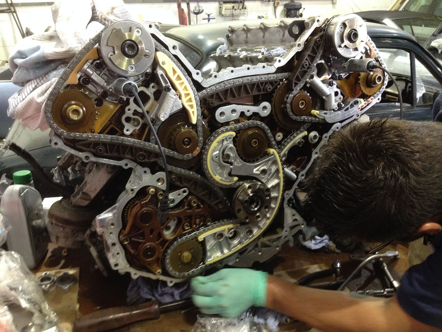

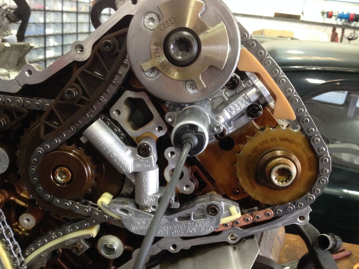

Well.............. Having got the engine out I decided to spend a little time tidying up the engine bay and replacing a few other items while I have an empty engine bay.

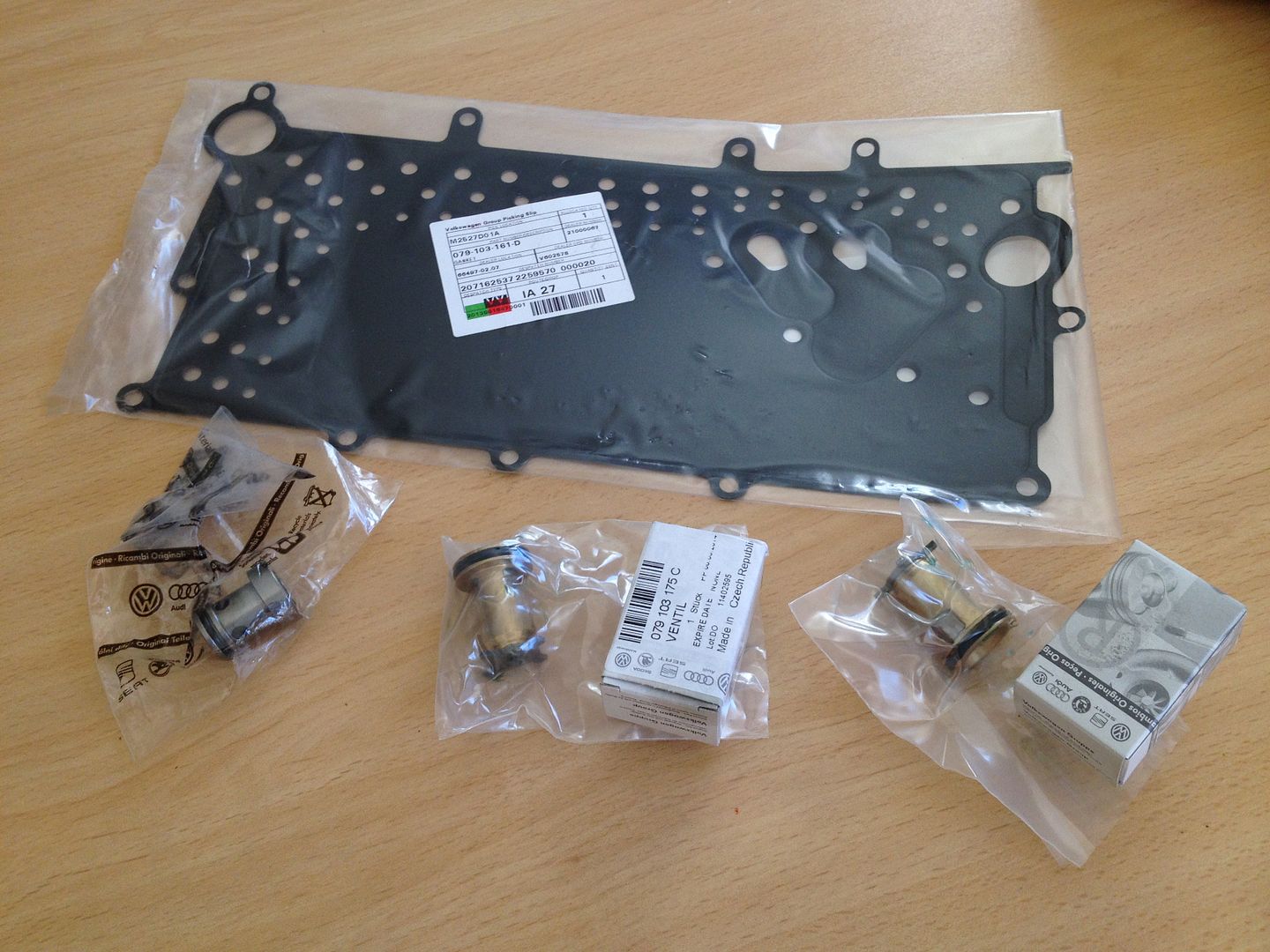

A few delays due to waiting for a few parts in addition to all of the timing chain/tensioners/guides/inlet cam adjusters etc etc etc which I have had for some time.

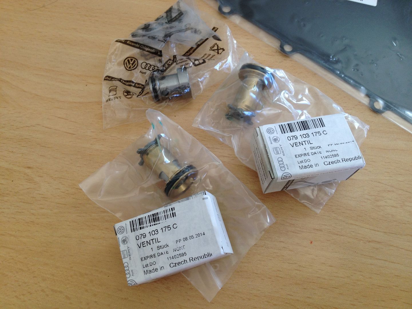

I decided that while the engine was out, I may as well replace the two non return valves and the oil jet after removing the inlet manifold, so had a week lost waiting for these.... but at least it will set my mind at rest knowing that I'm replacing every possible component to give me another 100k miles with minimal issues.

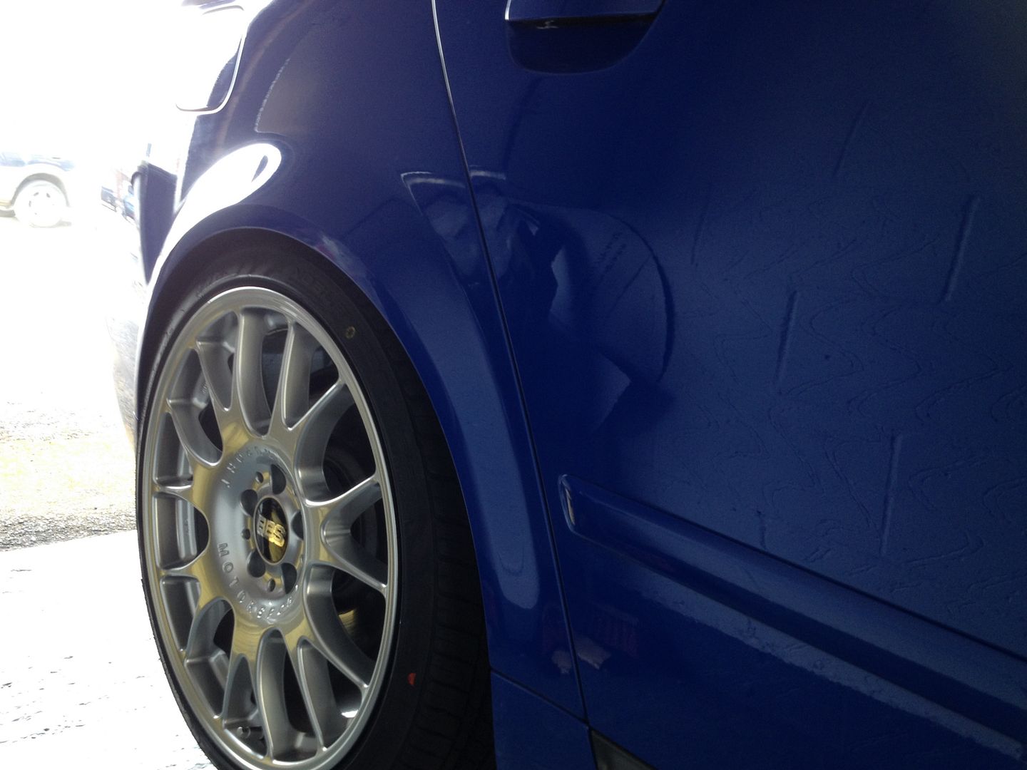

The 19" BBS CH wheels & Falken tyres were the first things to arrive and look great, but they'll look even better once the car is no longer on the lift in the air and sat on the ground...... LOL.
So I'm holding fire on those pics too......

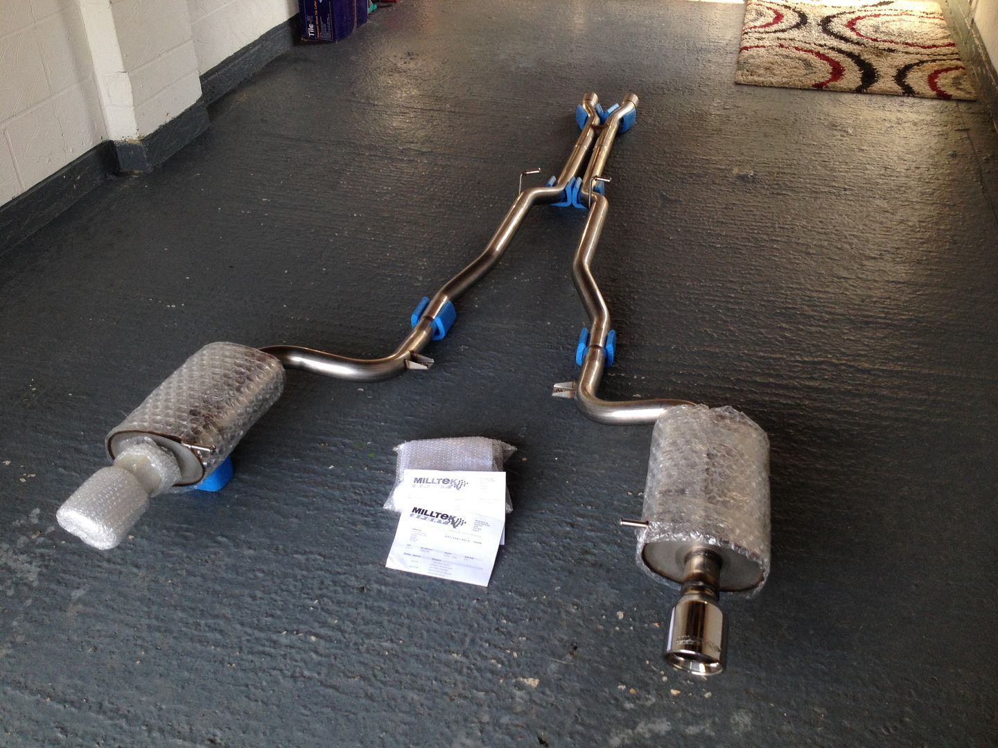

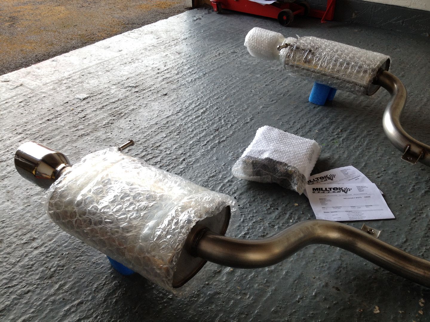

Milltek Exhaust System (Non Resonated) arrived and is presently sat in my garage waiting to be taken to my buddy at Moorland Motors who are refitting the engine, but he's asked if I can hang onto it until mid week, as space is limited in his workshop, but at least I now have it in my dirty little hands, as this too delayed a few things as Milltek must be doing really well at the moment as they are now only building to order and it took them four weeks to produce. Very pleased with the quality of their work though and worth the wait.

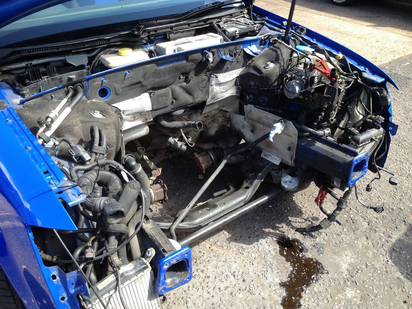

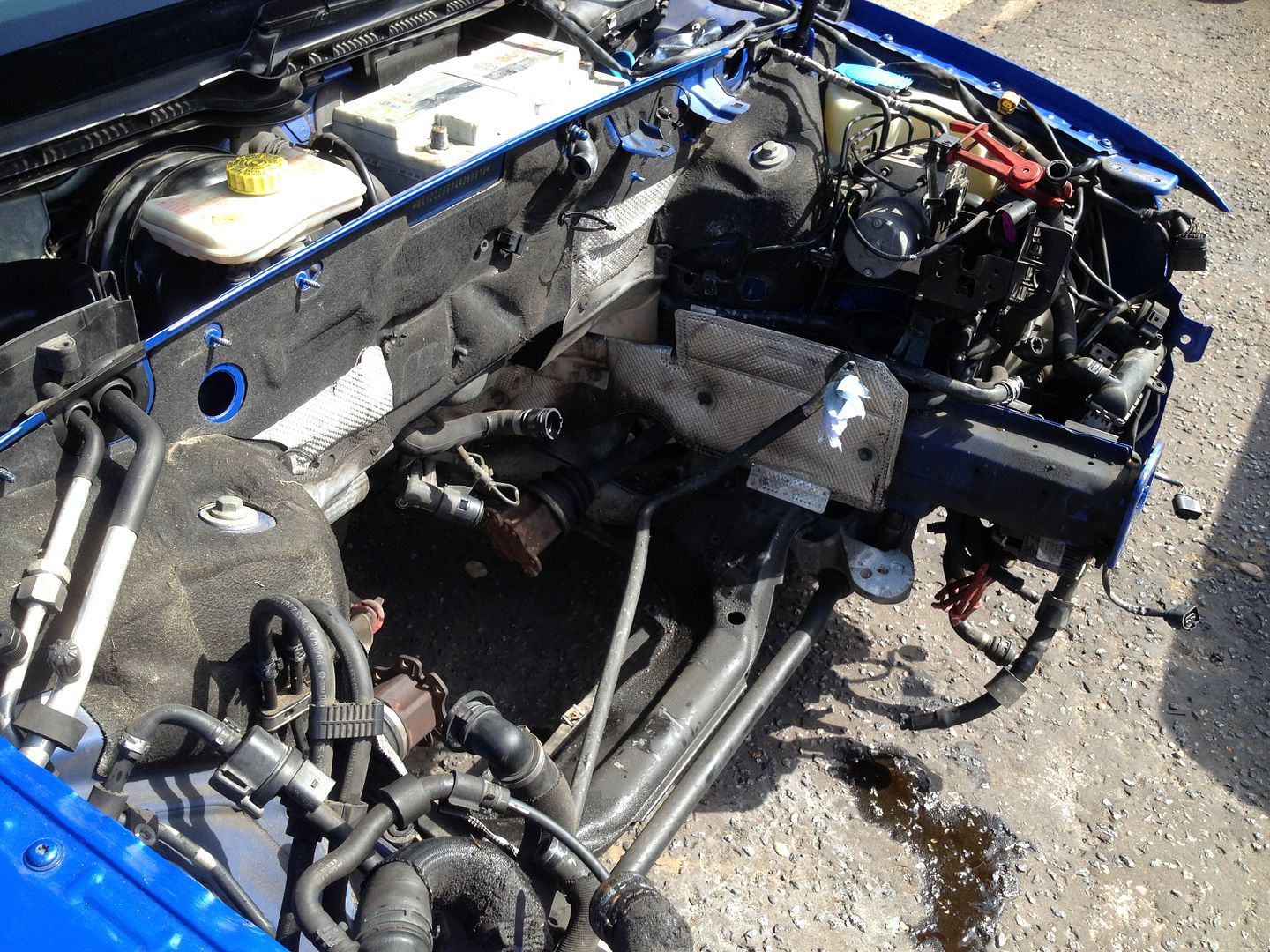

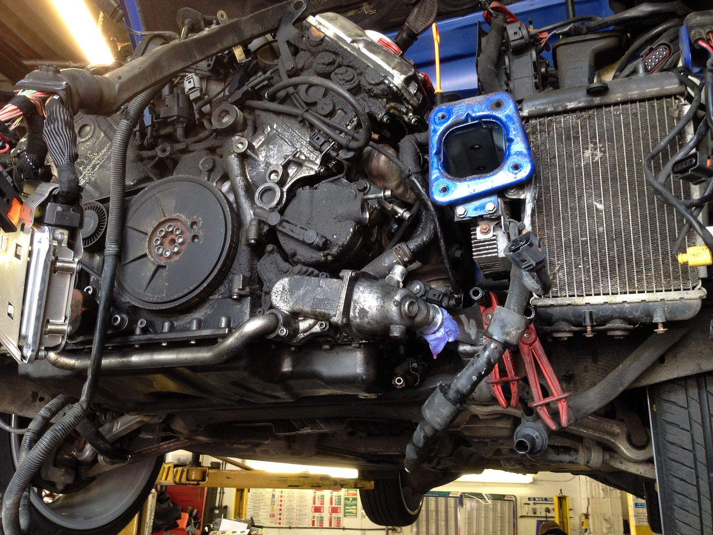

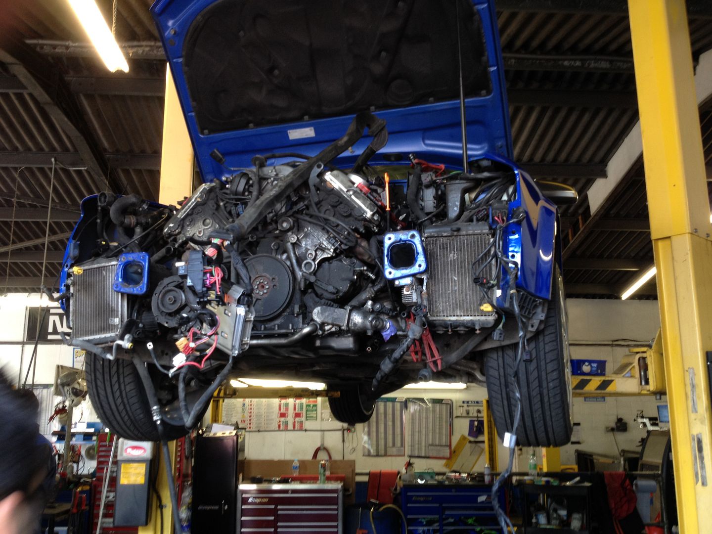

The pictures below were taken about two weeks ago when I first started removing the engine........ More To Follow.

Those BBS look really nice in that close up shot. Can't wait to see the full view! so much better than those standard wheels!!

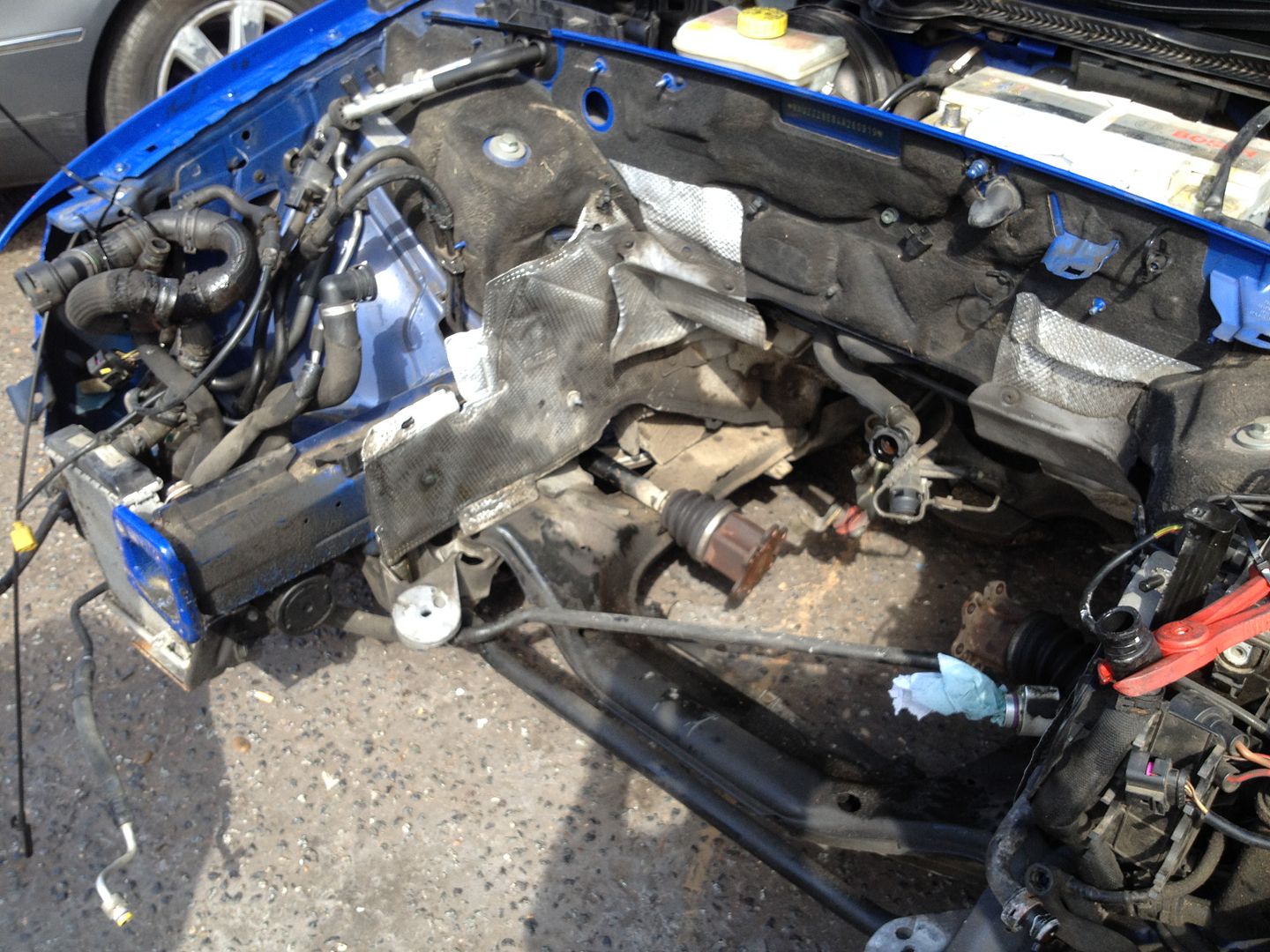

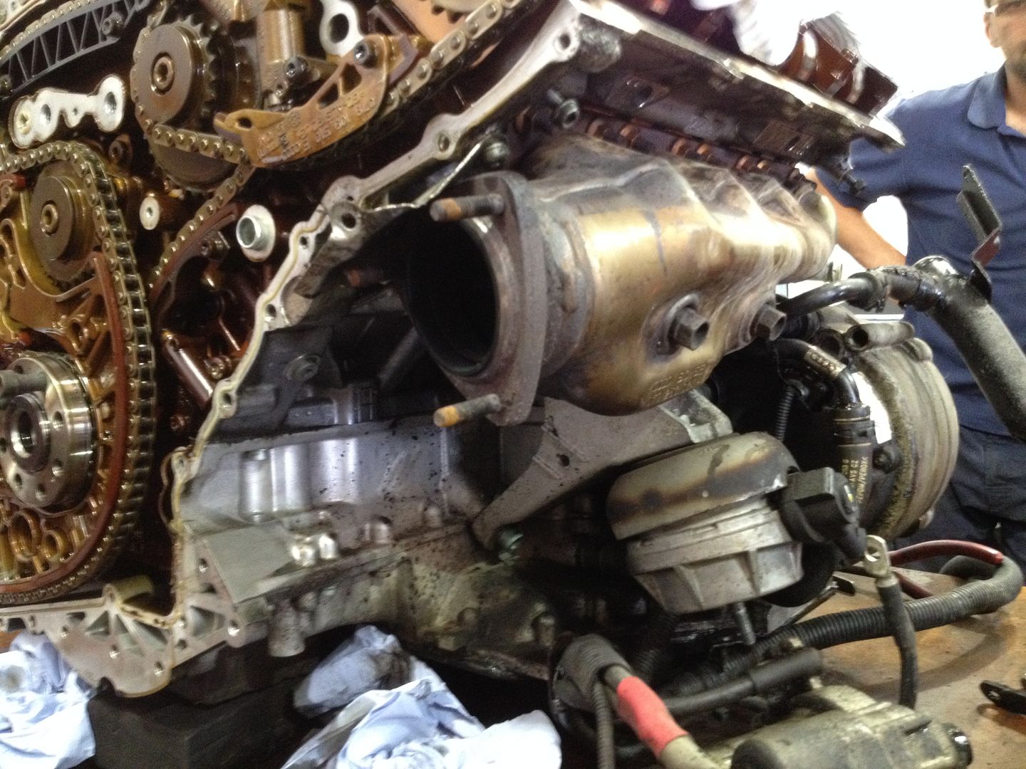

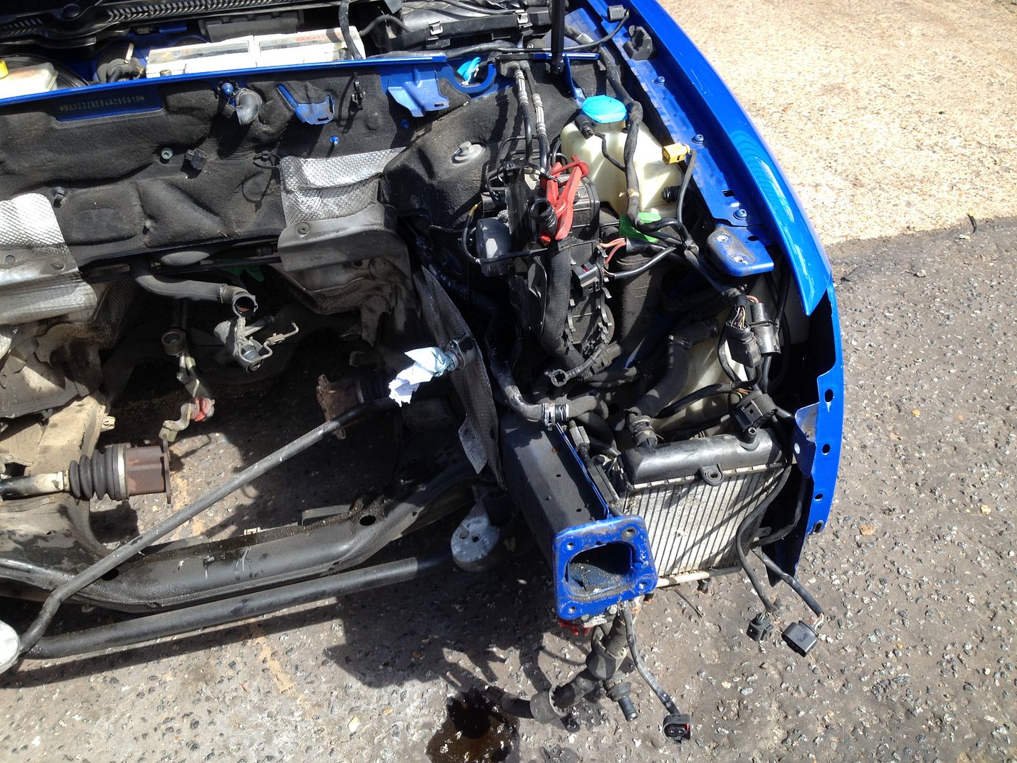

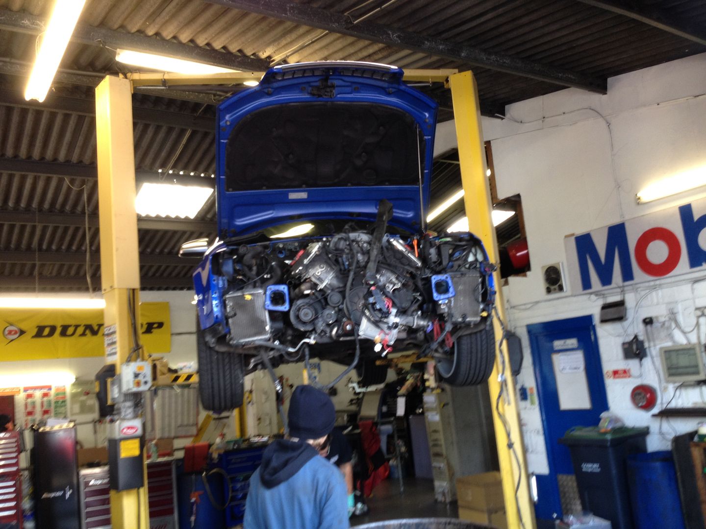

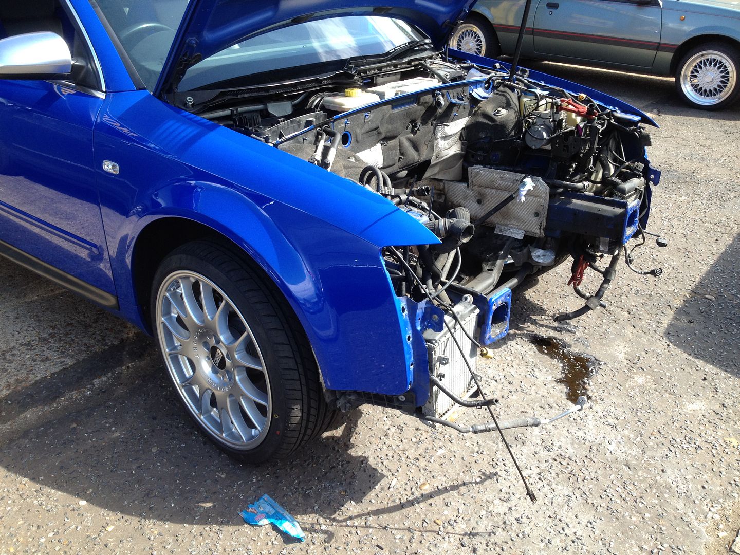

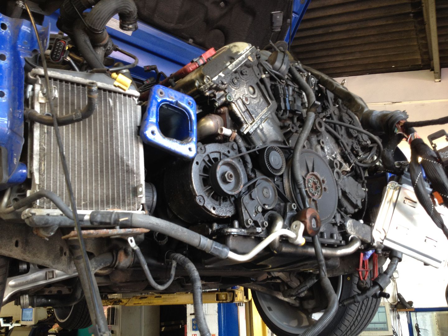

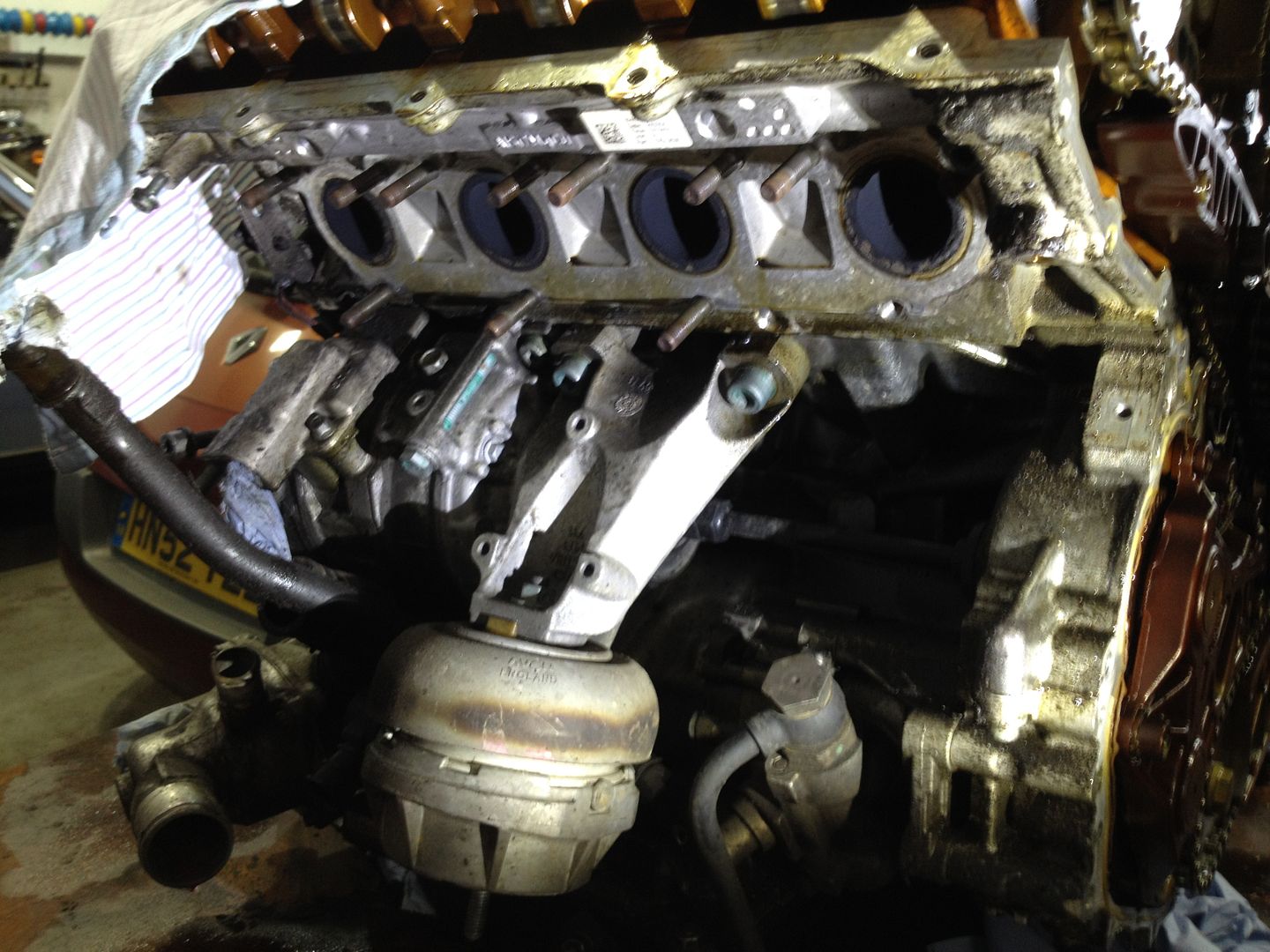

Well, after a few delays and my mechanic being a bit anal about cleaning parts (Many Thanks - Real Professional) as they were taken out and in some cases cleaning parts before they were taken off to prevent and debris falling into the engine, things are finally on the move. A few additional parts that I hadn't budgeted for have had to be bought as it would be stupid not to fit them now while the engine and gearbox are out. Those parts include a new flywheel, Clutch and Pressure Plate and taking the sump off to cure a few seeping areas, along with a few unexpected gaskets, but when your doing this much work it's not worth scrimping. I'm just dreading adding up what it'll have cost at the end, but this is a long term project and this is just making sure the mechanics of the car are perfect before I go even further.
I won't bore you with what a pain it is to remove the engine and box and how many components you have to move out of the way first, but just to say it's not for the faint hearted, but if your mechanically minded and have access to some decent facilities it is possible.
So now I'll just add the pics of a sorry looking car, that will be perfect once I've finished.
Here goes :

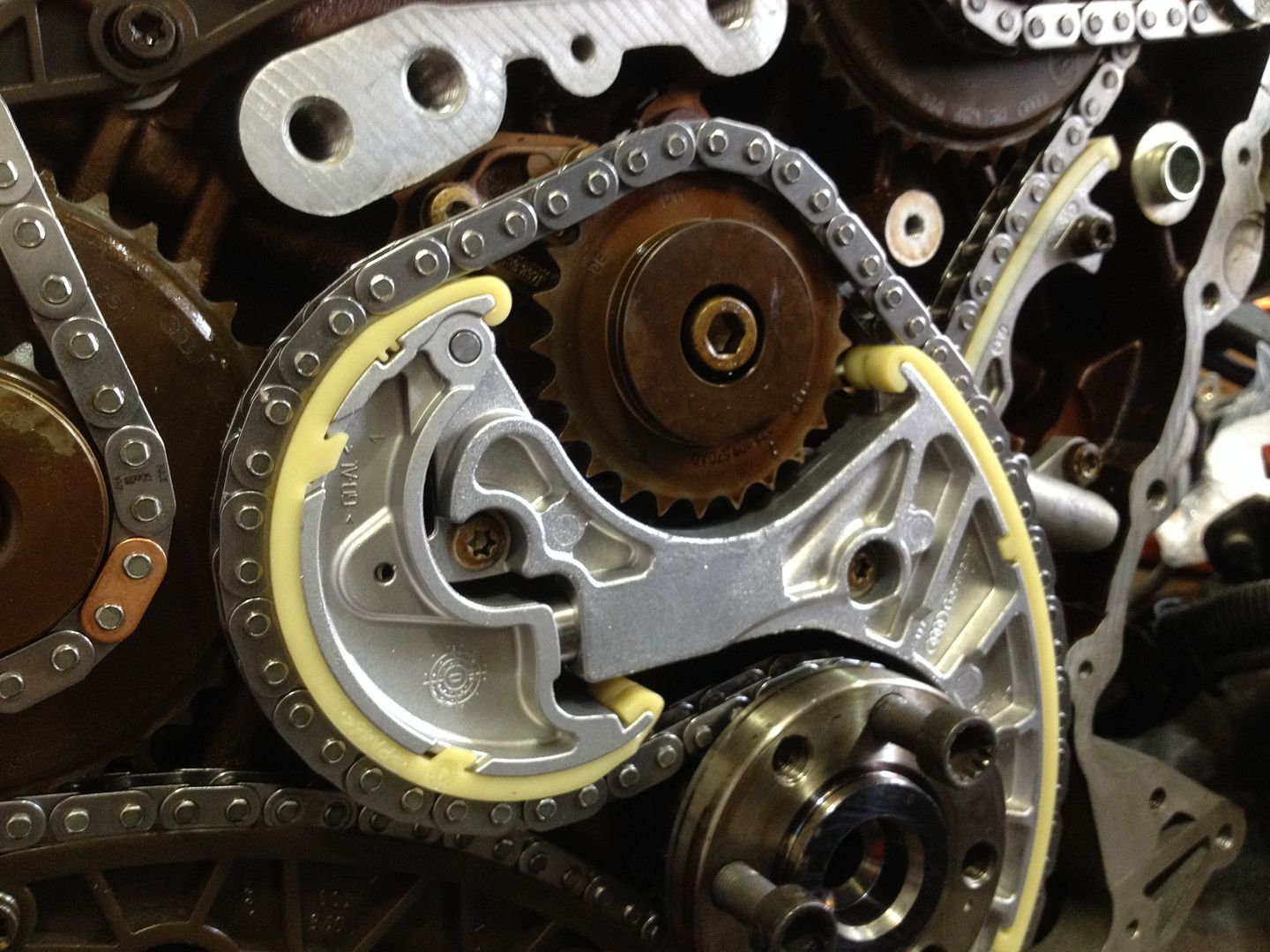

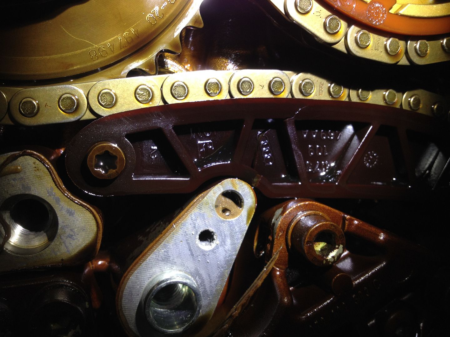

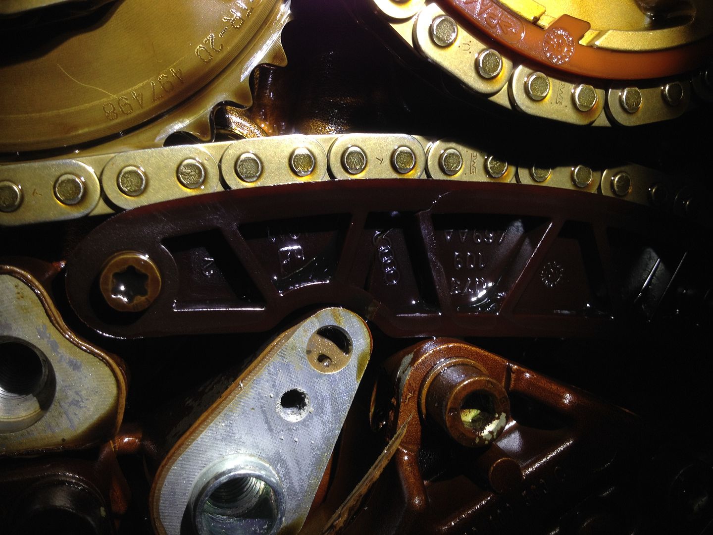

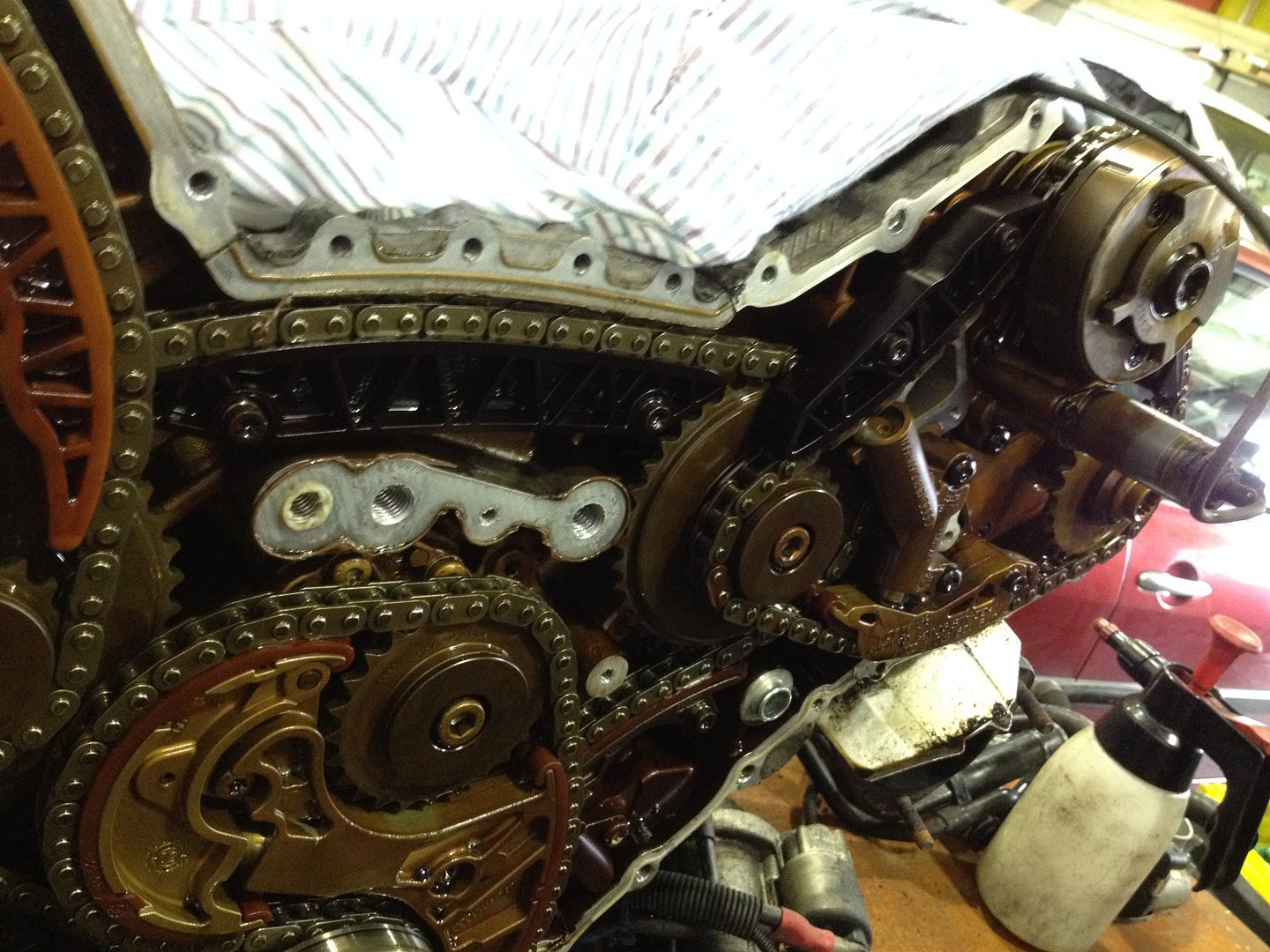

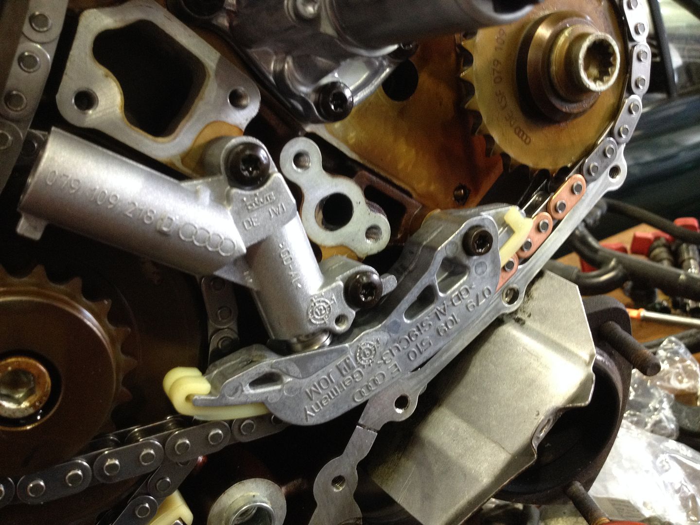

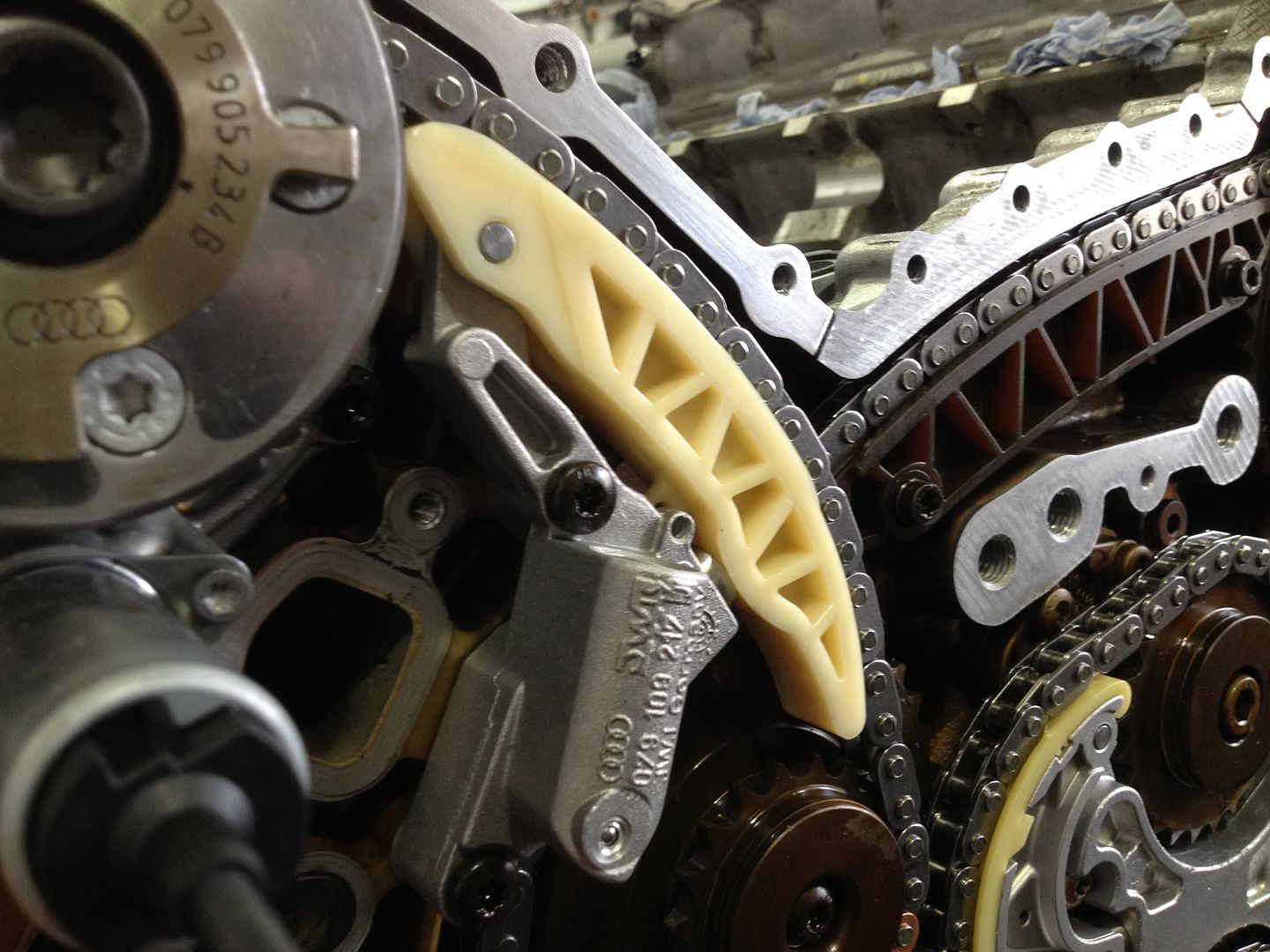

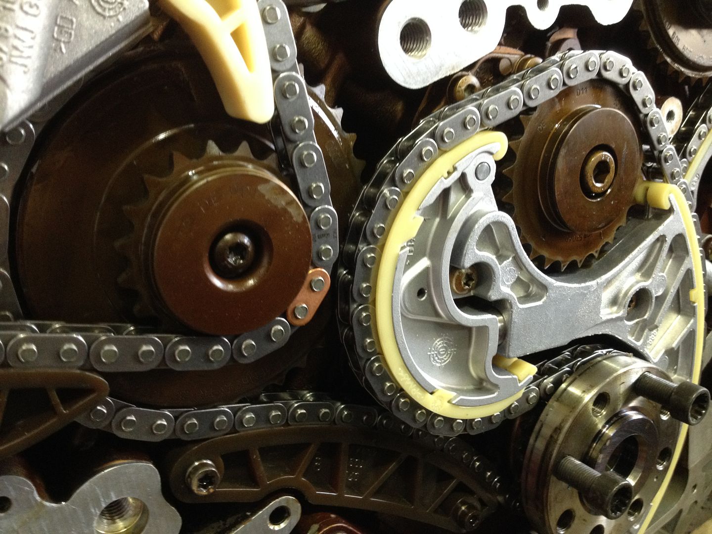

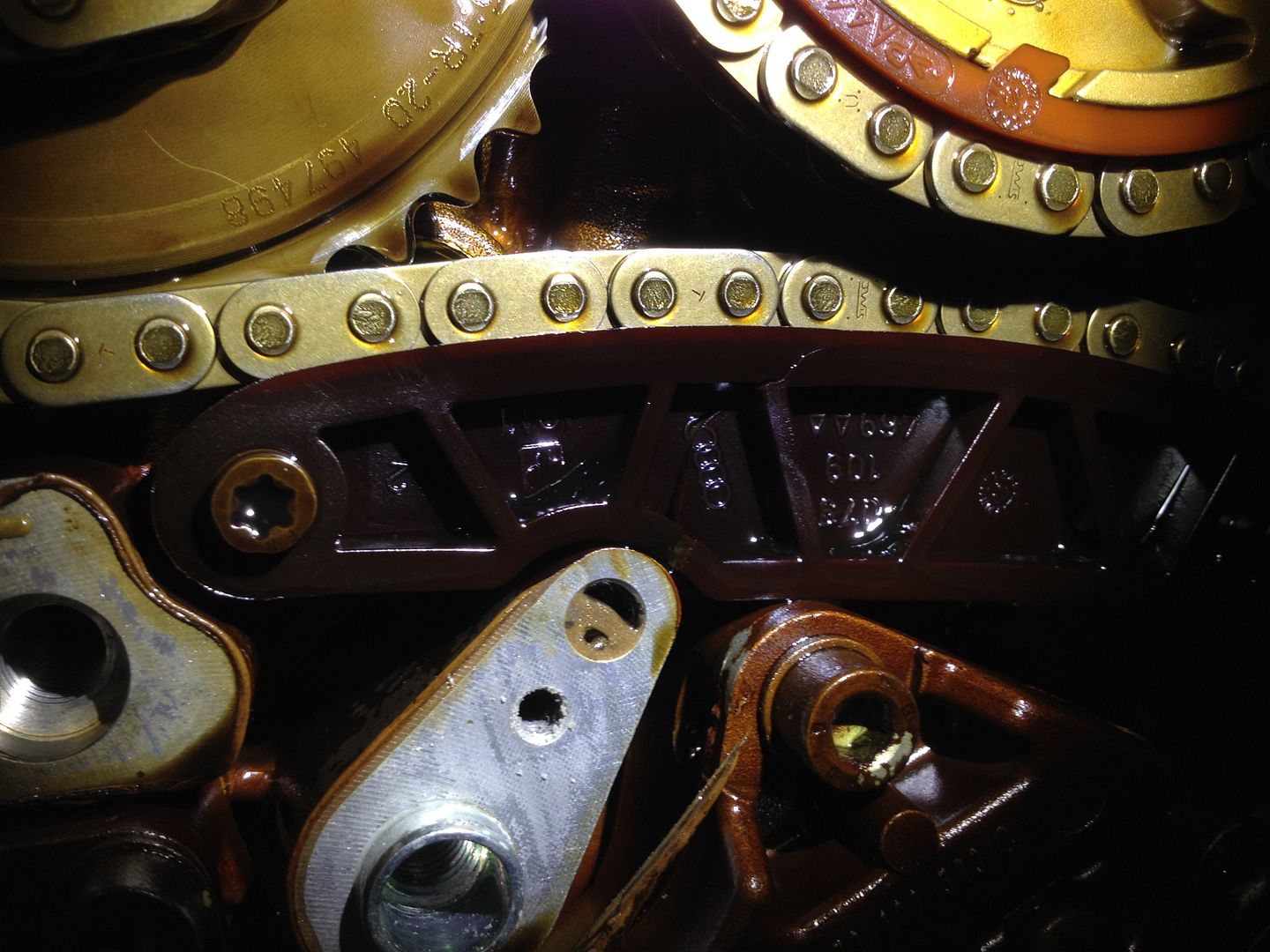

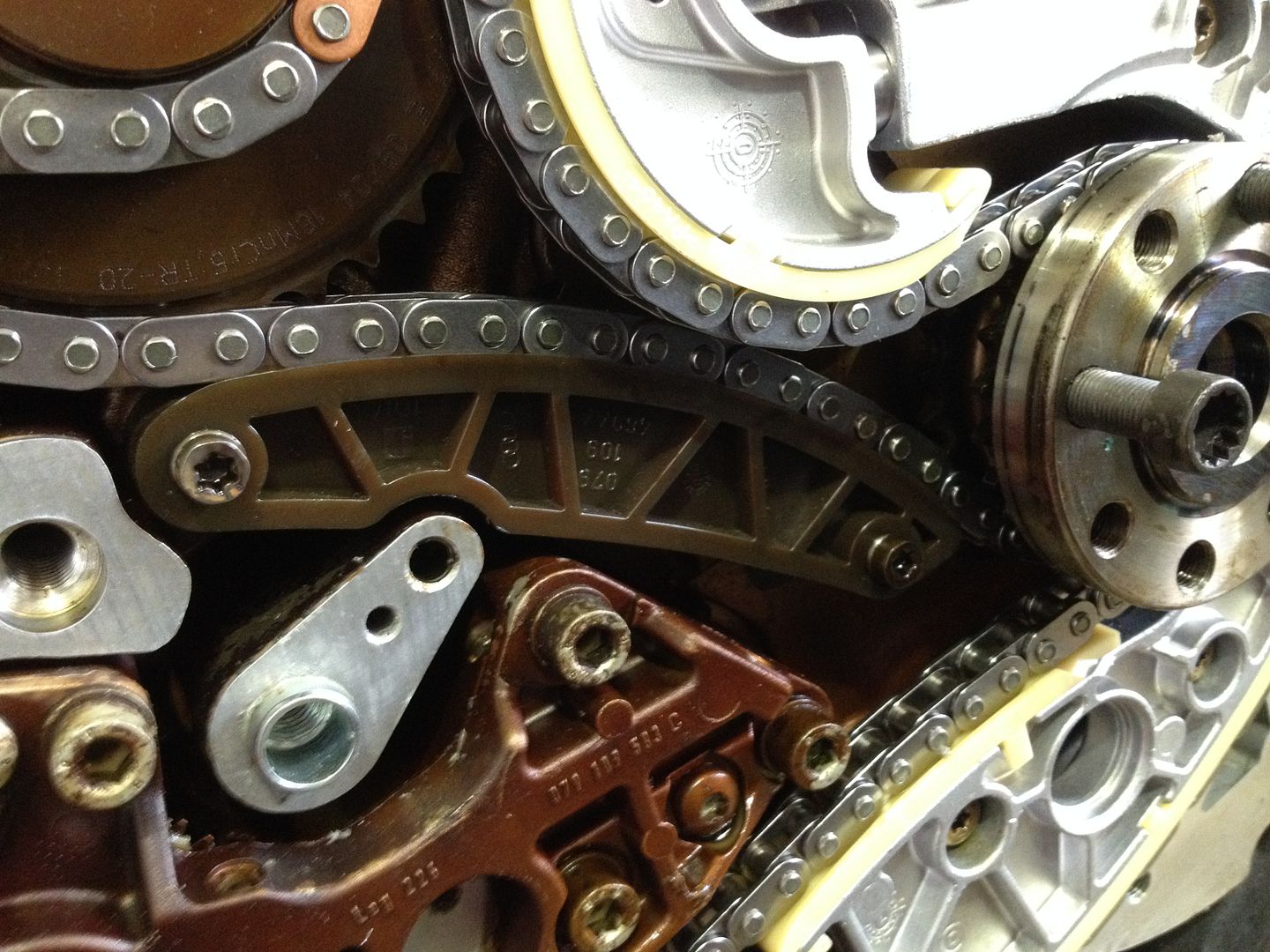

And lo and behold, I found the reason for committing to doing a total rebuild of the timing gear, every item is being replaced as recommended by JHMotorsports, and just as they state, most of the engines that come in for a timing gear rebuild, they almost always find one particular tensioner has failed........... Which is exactly what I found, luckily mine had only cracked and not broken up and fallen into any other moving components. Guess I was lucky, or my timing was perfect in doing this mammoth job. As you will see, the timing chain tensioner (The guide actually) had cracked in two, but was still in place.
Having checked all of the remaining guides/tensioners, everything else appeared in good condition, but showing signs of wear, this is an 81k miles car, so not a sky high mileage one. Just goes to show.
Well, I hope that's enough pics to keep you guys happy for a couple of days, the next pics will be when everything has been replaced.

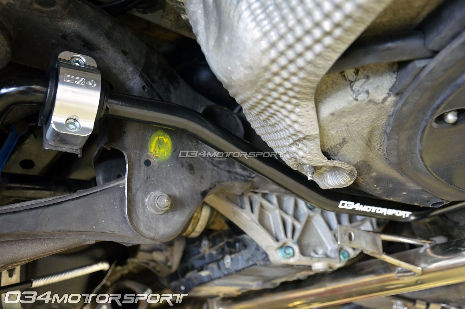

You mentioned forced induction. And the engine is out at the moment... :biggrin3:
I'd recommend when you are looking at suspension you go straight for these: http://www.larkspeed.com/index.pl?a=i&p ... ll-Bar-Kit
They're the H&R 32mm front, 24mm rear bars designed for the B7 RS4 and are perfect on the B6 S4 (both set to stiff). Some do the OEM 22mm rear only, some do aftermarket rear only. Personally I find the front and rear works best together. Really is a bang for buck upgrade and you'll appreciate it coming from M3's and 5's.
Also the servotronic is quite a bit too over assisted in my opinion. You can sort that out by pulling the relay behind the fuse box. It'll have a number like 638 on it and is a black box. Remove it and the steering is noticeably heavier. At first it may feel too heavy at low speed, but after a little drive you get used to it and it feels much better (IMO). Goggle 640 mod, there a few how to guides, but it's just behind the steering wheel, accessible via the fuse box entry to the dash.

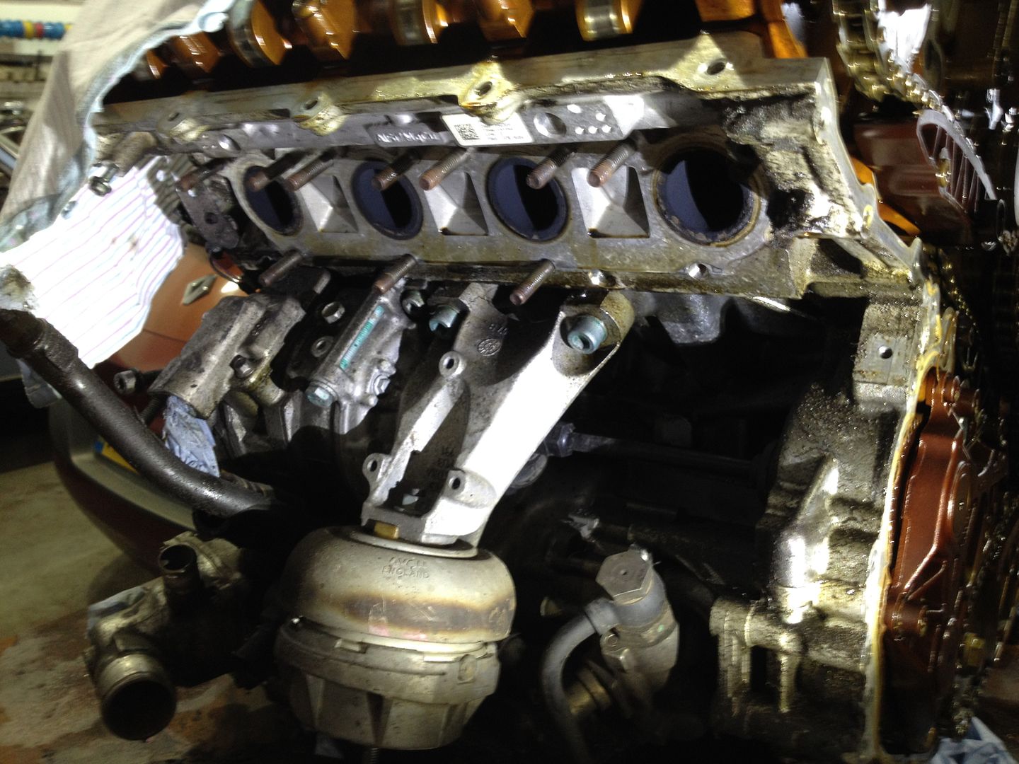

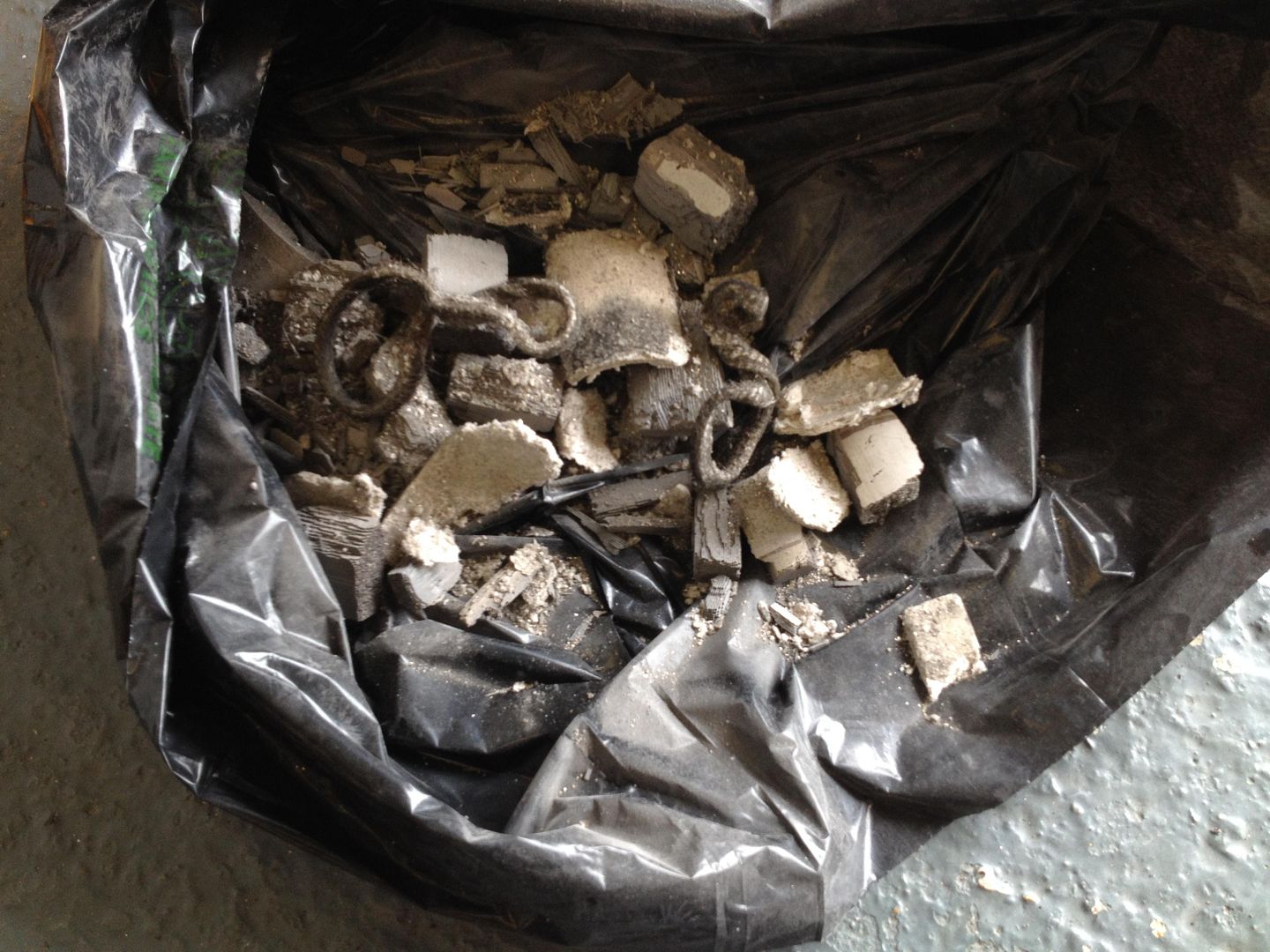

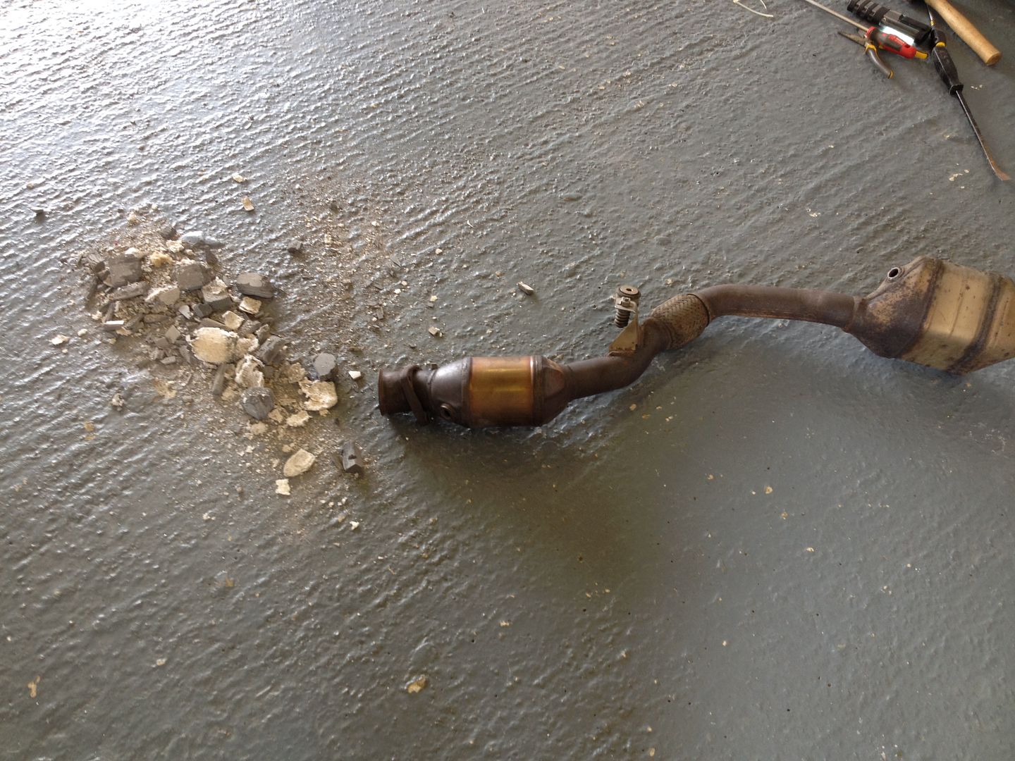

Well......... As the days tick past I keep doing all those little bits that while the engine's out you should take advantage of.
So, if anyone want's two pre cats from a 2005 B6 S4........... here they are, you just need to come and collect them :
And I'll keep the Piggy Pipes with both Pre-Cats removed.
So, the story so far...... "Full" timing chain component replacement, including every chain, every guide, every tensioner and both the mechanical cam adjusters...... everything. Milltek Cat Back Exhaust System (Non Resonated), Piggy Pipes (Pre-Cats removed from Down Pipes), a lot of gaskets replaced while the engine was out. New Flywheel, Clutch & Pressure Plate, H&R Springs Fitted, BBS CH 19 x 8.5 Wheels Fitted. Replaced Coils, Plugs, Air Filter and Full Oil (Castrol 5-40) and Filter Change. I've also fitted some 02 Sensor Spacers to try and eliminate the CEL light being activated (I'll see if that works or not). But once were up and running then I need a JHM Remap, but obviously being in England this will have to be done by a download.

Too Late for the Anti Roll Bar Kit............ I've got this on it's way ...........
Your totally right about the steering being too light with little or no feedback...... MANY THANKS for the info on the fuse removal, I'll certainly be trying that mod.

Looking forward to the pics. That 034 bar will do the trick. I think it's 25.6mm IIRC, so will be a marked improvement over stock.

Can the pre cats be got with the engine in situ?
Past & Present: Audi S4 B6 Avant, SupraTT <Gone>, Audi S2 <Gone>, Mustang 69 302ci.
JimGreen
Posts: 17
Joined: Sat Jul 05, 2014 6:39 pm
Re: 2005 Noggy Blue S4 - Project
Post by JimGreen » Sat Aug 02, 2014 10:06 pm
Yes, they can.
Obviously need to lift the car up on stands, and then remove the exhaust, then the down pipes.
Once you've done this which should take about an hour, removing the pre cats is about thirty minutes work on each.
Well worth it from what I've read, still got to get my engine back in to verify though.....LOL

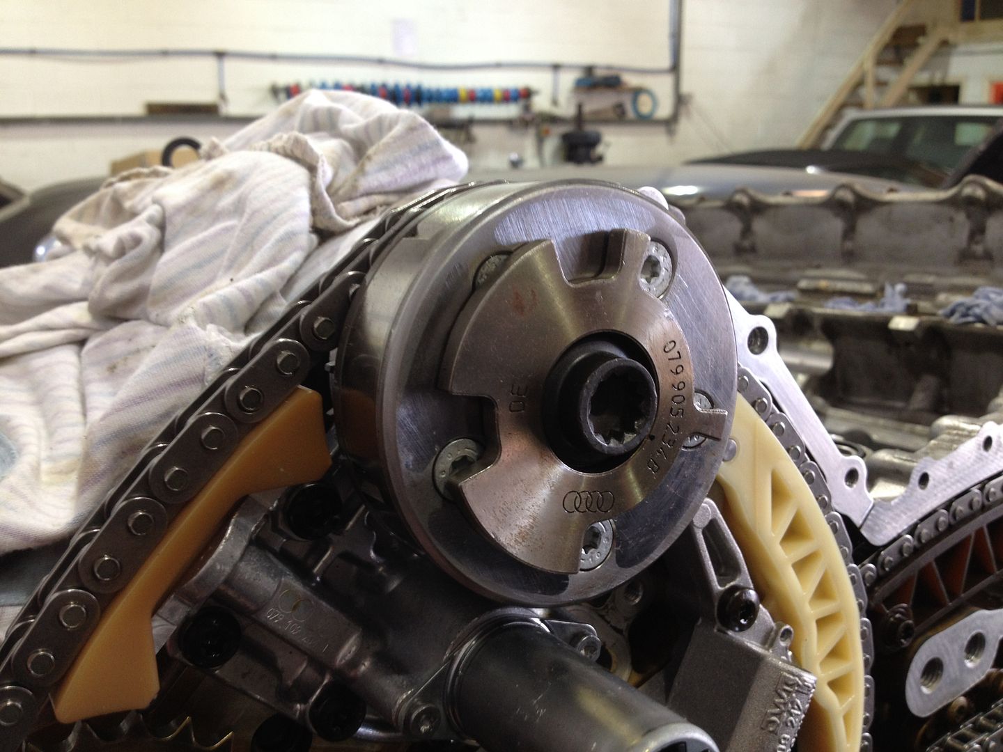

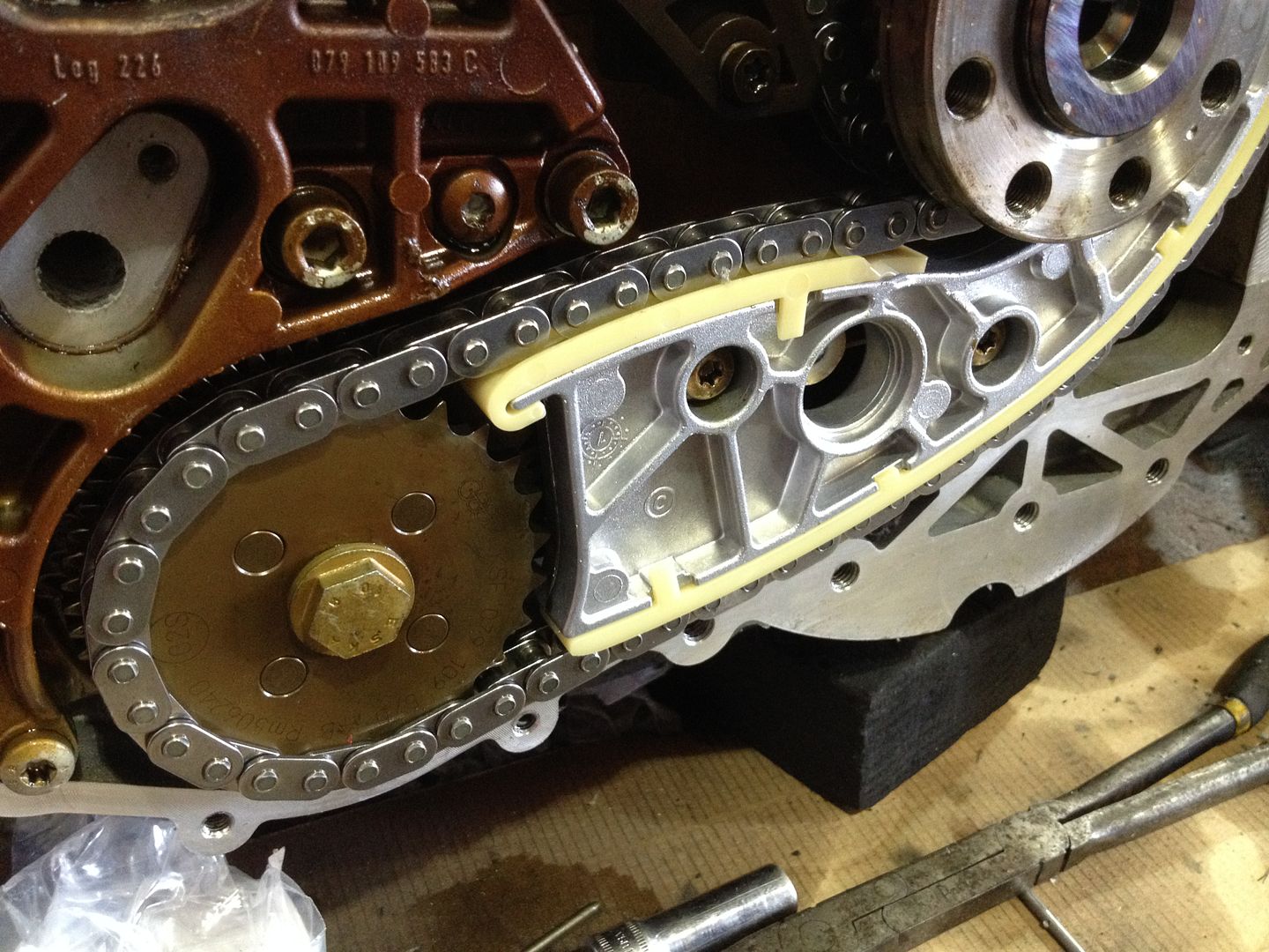

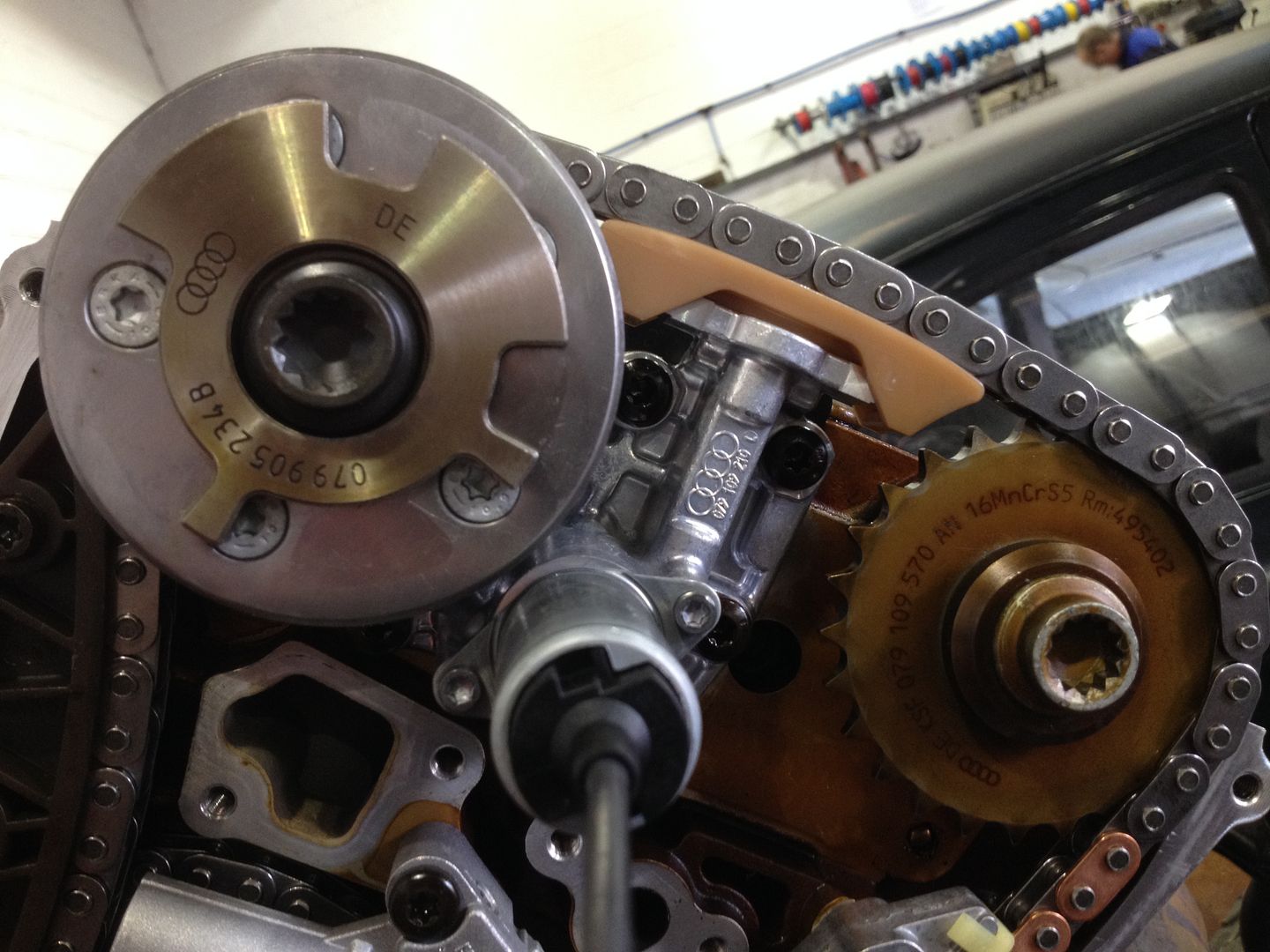

Not a lot to say about the pictures below, this is with the "Full Plus Kit" fitted (All timing components replaced).
Just getting ready to put it back into the car.
Well, I hope that makes up for not posting for a few days, just looking forward to getting it back into the car, hoping for a bit of a performance increase as now the timing will be spot on, as the variable cam timing adjusters were both worn and not timing the inlet cam accurately, the Milltek (Non Resonated Exhaust System) will give a little extra, along with the piggy pipes (Pre Cats Removed on the down pipes). Once it's up an running again it will be treated to a JHM remap, downloaded into the ECU.
http://jhmotorsports.com/shop/catalog/j ... p-381.html
Yep it's taken longer than the month I intended, but cleanliness is next to godliness...... LOL, and every inch of the motor and transmission has been cleaned to perfection and I've treated to cam covers to something special to brighten them up....... Pics to follow once she's all back together.
It's been a huge job and VERY expensive, but to me it's worth it. I've replaced every timing component, plus all of the chains, plus the flywheel, clutch and pressure plate and a load of gaskets were replaced to play it safe, I've also replaced a load of other items, engine front snub mount, a couple of sensors and the serpentine belt will also be replaced, the tensioner was replaced about a year ago so this should be ok. To be honest, I've lost track of some of the other minor items I've replaced........ So many.
Once I get a spare moment, when the car is back up an running, I'll post some pics of the old components so give an idea of where the wear occurs and which items appear to fail first and show the failures....... this is on an engine that has a full Audi service history from new, was owned by two previous owners, the first of which was 68yrs old, so I doubt he thrashed it. The second owner who I purchased it from had looked after it like it was one of his children......... so it just goes to show that even the pampered cars can still suffer with the timing issues.
