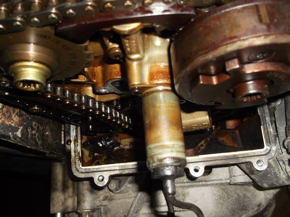

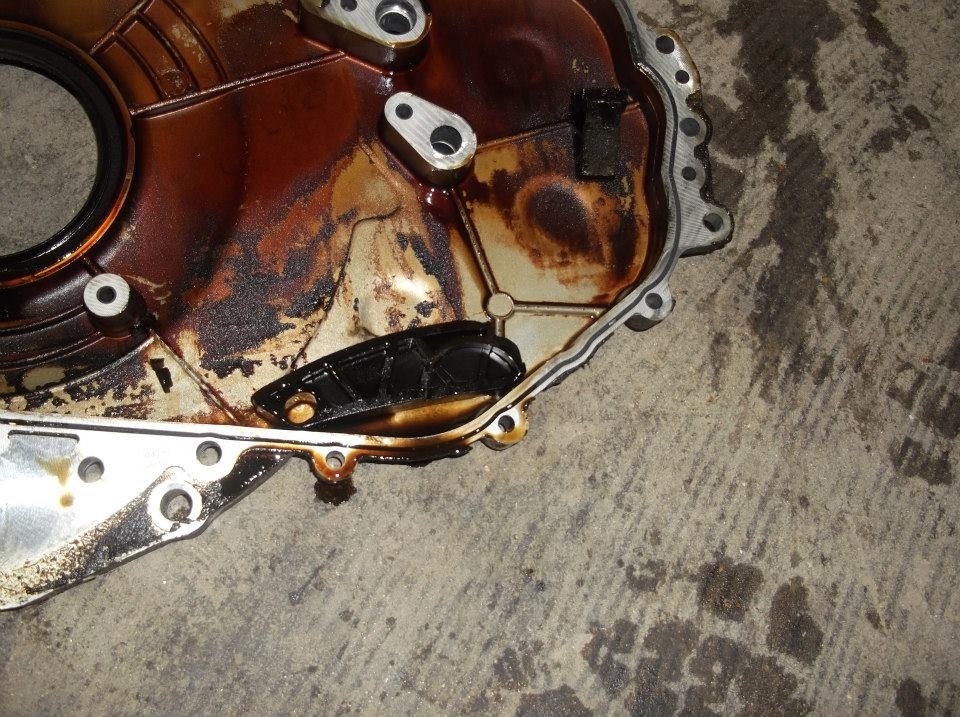

Finally got the pictures from the garage of the broken bits on the car. :audibash:

Thats some pretty complicated mechanical engineering going on there. Thanks for posting up some pics. :thumbs:
I cant quite figure out where the damage would be if i'm looking at pic 2.
Its such a major job for such a small inexpensive part to fail, there seems to be very little thought for any long term ownership with this design. :audibash:
What is different with the B7 RS4 design, they dont seem to fail.

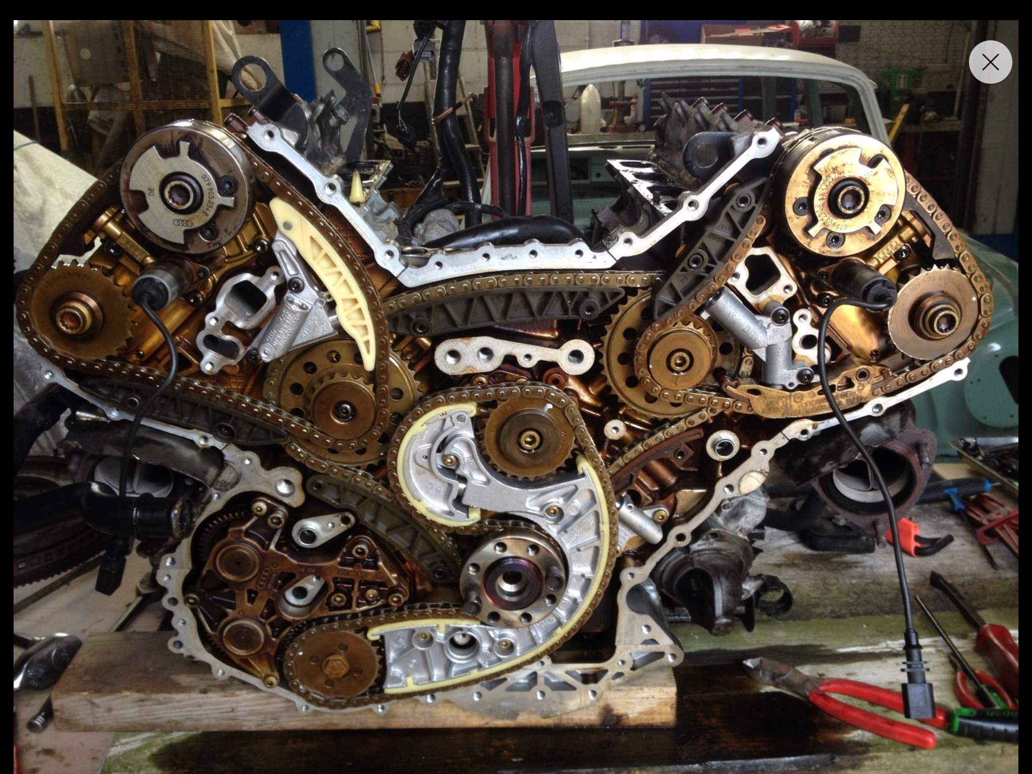

The RS4 is a different engine and the guides look similar but I believe are made of a different material.
On the second pic there should be a guide running down the left hand side of the middle chain and part of the centre one is missing. The top pic shows the broken bit sitting in the cover. This pic shows where everything should be.
