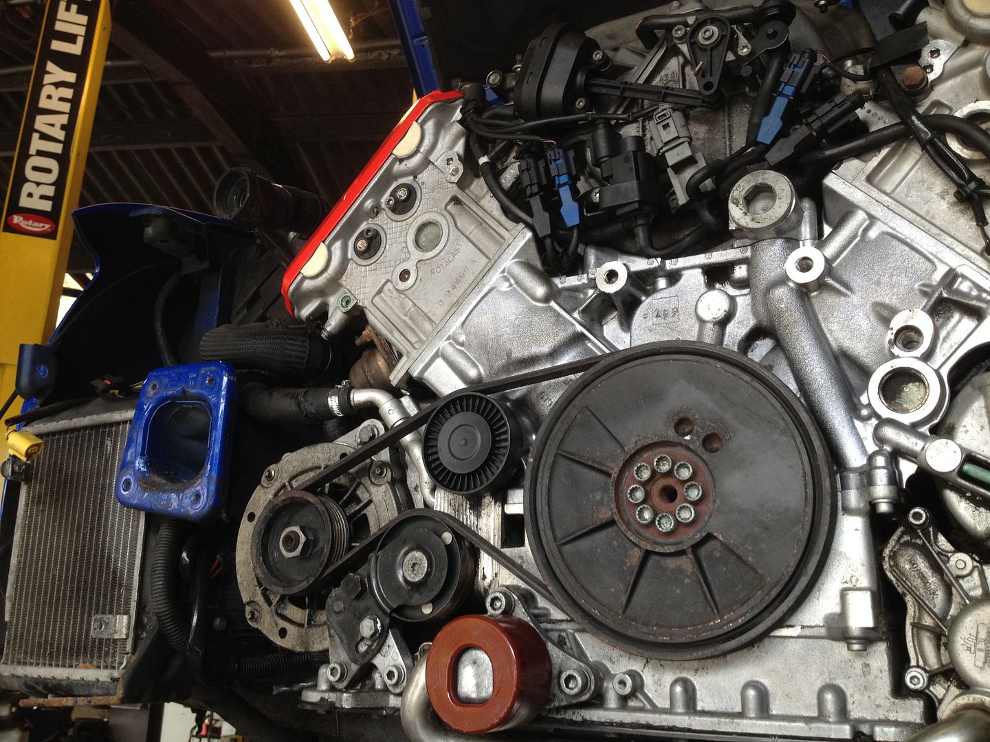

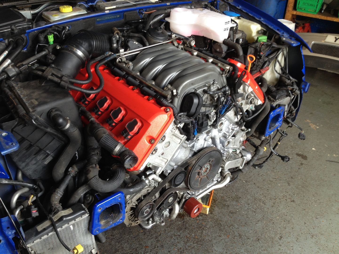

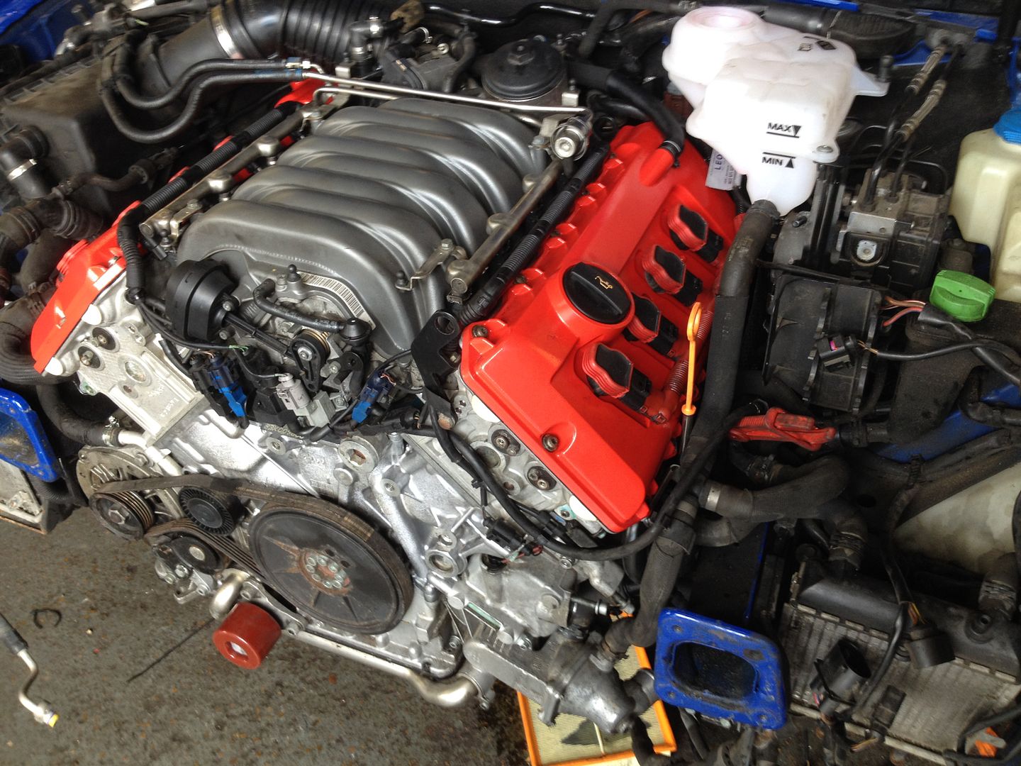

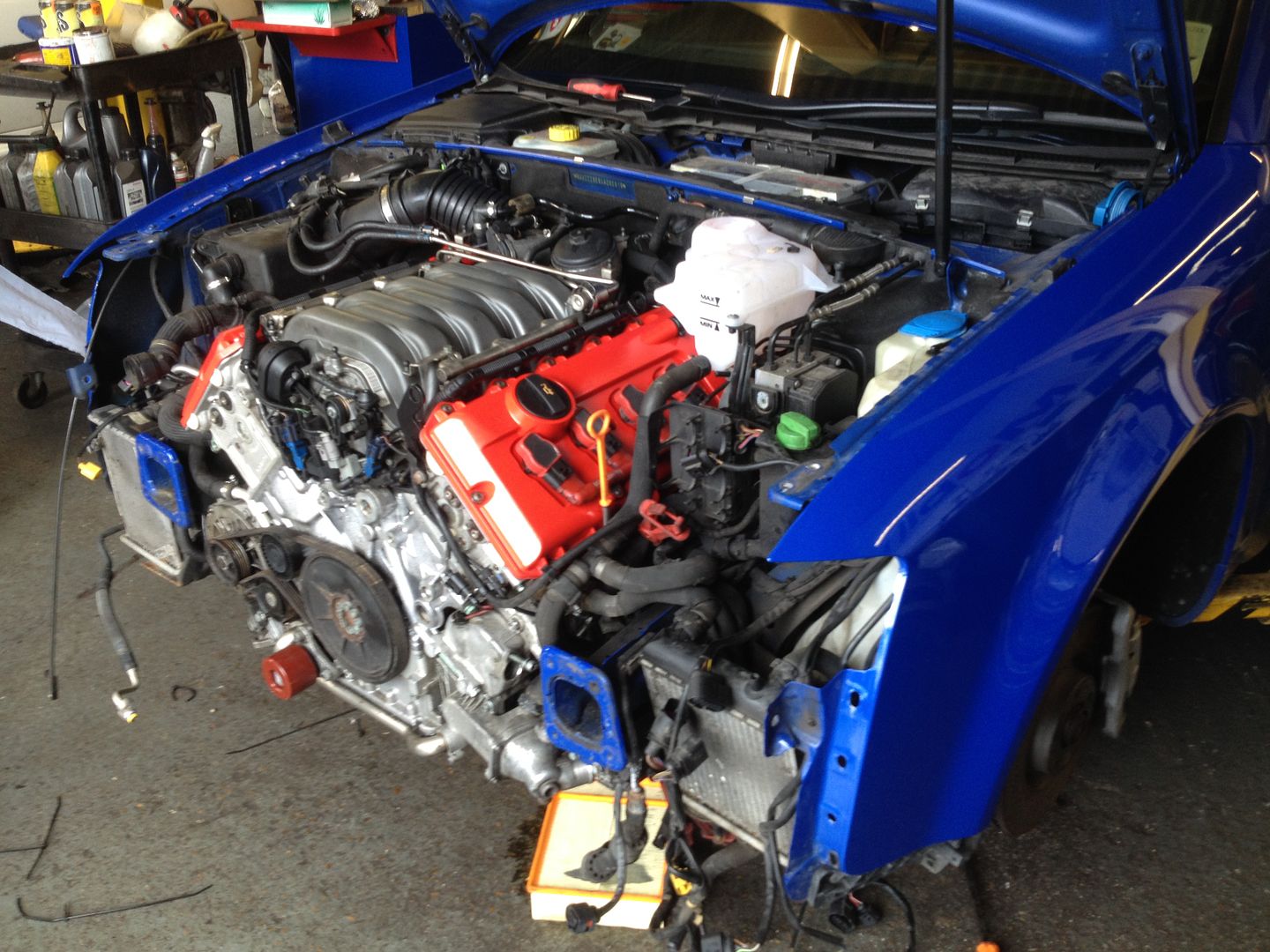

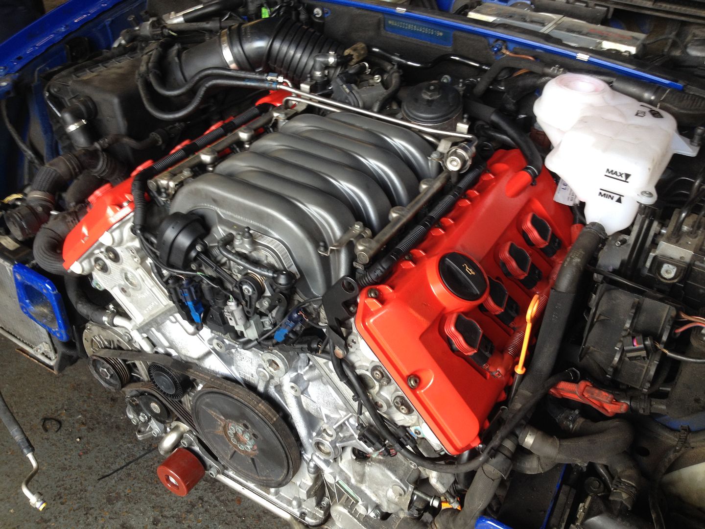

The final days of the rebuild......
I have the weekend off work and my main man is working flat out to finish it so hopefully I'll be back on the road on Monday.......... At last.
Have to say a huge thanks to Kal at Moorland Motors (Gosport - England) who's experience of the Audi V8 has proved invaluable in the rebuild, a very knowledgeable guy who's attention to detail is second to non.
Sorry for the quality of the pictures (Good Old IPhone)........... It's been a long, hard and more expensive job than I intended, but believe it'll be worth it in the end. A lot of the extra time was taken in deep cleaning everything once she was dismantled, plus a few unexpected bits that would have been stupid not to replace while the engine and transmission was out.... Sensors, gaskets that were looking a bit tired, Clutch assembly & Flywheel replaced, Valve covers bead blasted and powder coated, a couple of hoses here and there ...... Plugs, Filters, Fresh Oil etc etc etc ... the list goes on.
And of course the time taken to keep this thread updated...... LOL.
Need to spend a bit of time cleaning up the engine bay (Greasy/Oil finger marks everywhere) but feeling very close to the end now.

Bits Done :
1. Total Timing Gear Overhaul (Using every item listed in JHM's "Full Plus Kit").
2. Cam Covers Bead Blasted and Powder Coated.
3. All One way return valves Replaced (Two underneath the Valley Pan + Jet Replaced + One in each Cylinder Head).
4. -25mm H&R Springs Fitted.

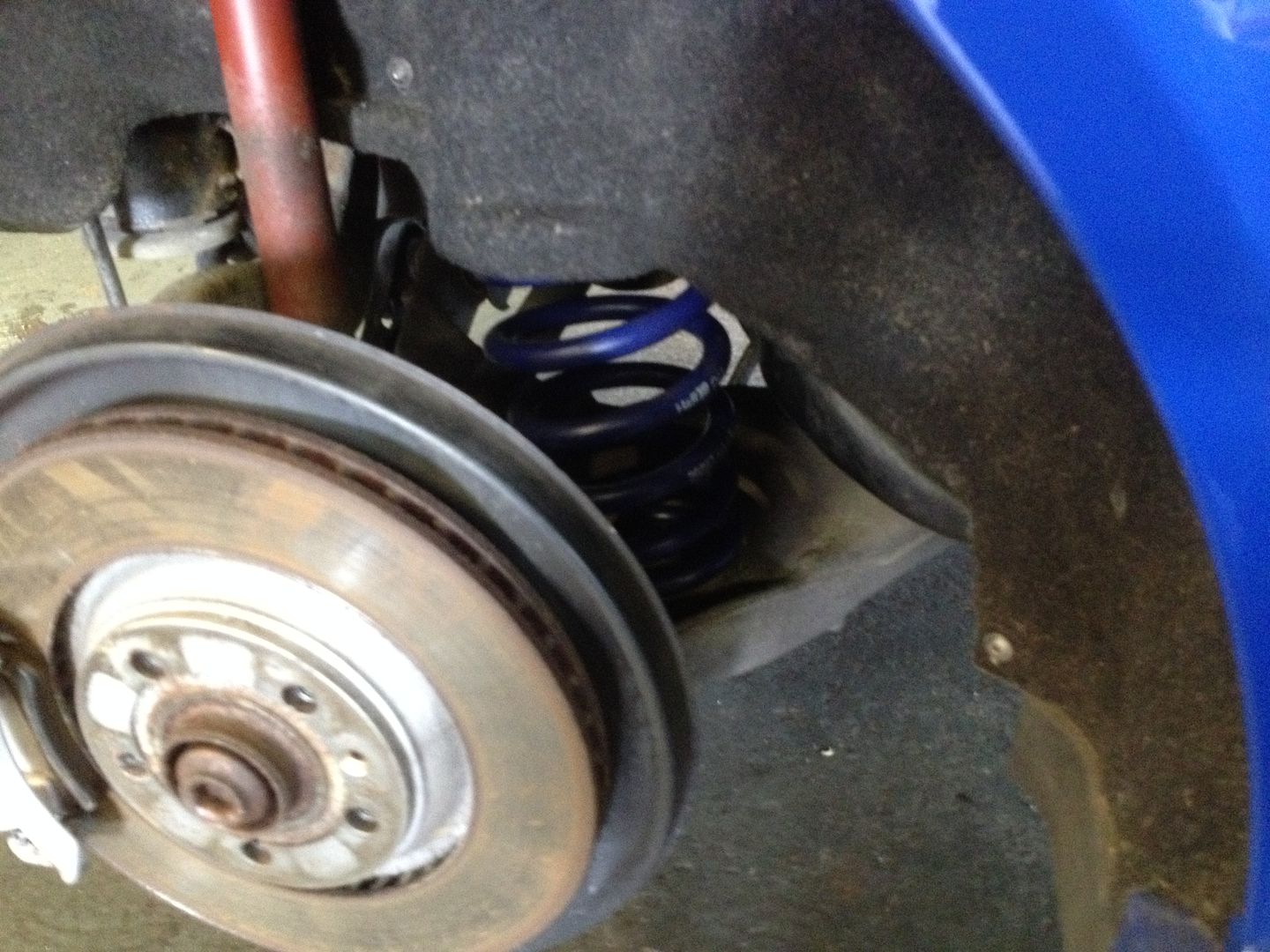

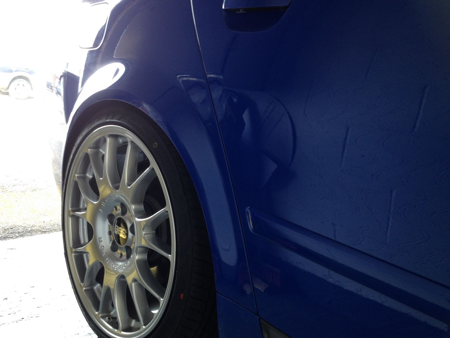

5. BBS CH 19x8.5 Wheels & New Tyres.
6. DeCat'd Down Pipes (Piggy Pipes).
7. Milltek (Non Resonated) Exhaust System.
8. New DM Flywheel, Pressure Plate and Clutch Plate.
Didn't get pics of these, my tech fitted them before I got the chance.
9. Numerous gaskets, Seals & Sensors Replaced.
Couldn't be bothered to take pics of boring gaskets.
10. ARP Snub Mount.
11. Oils & Filters all replaced.

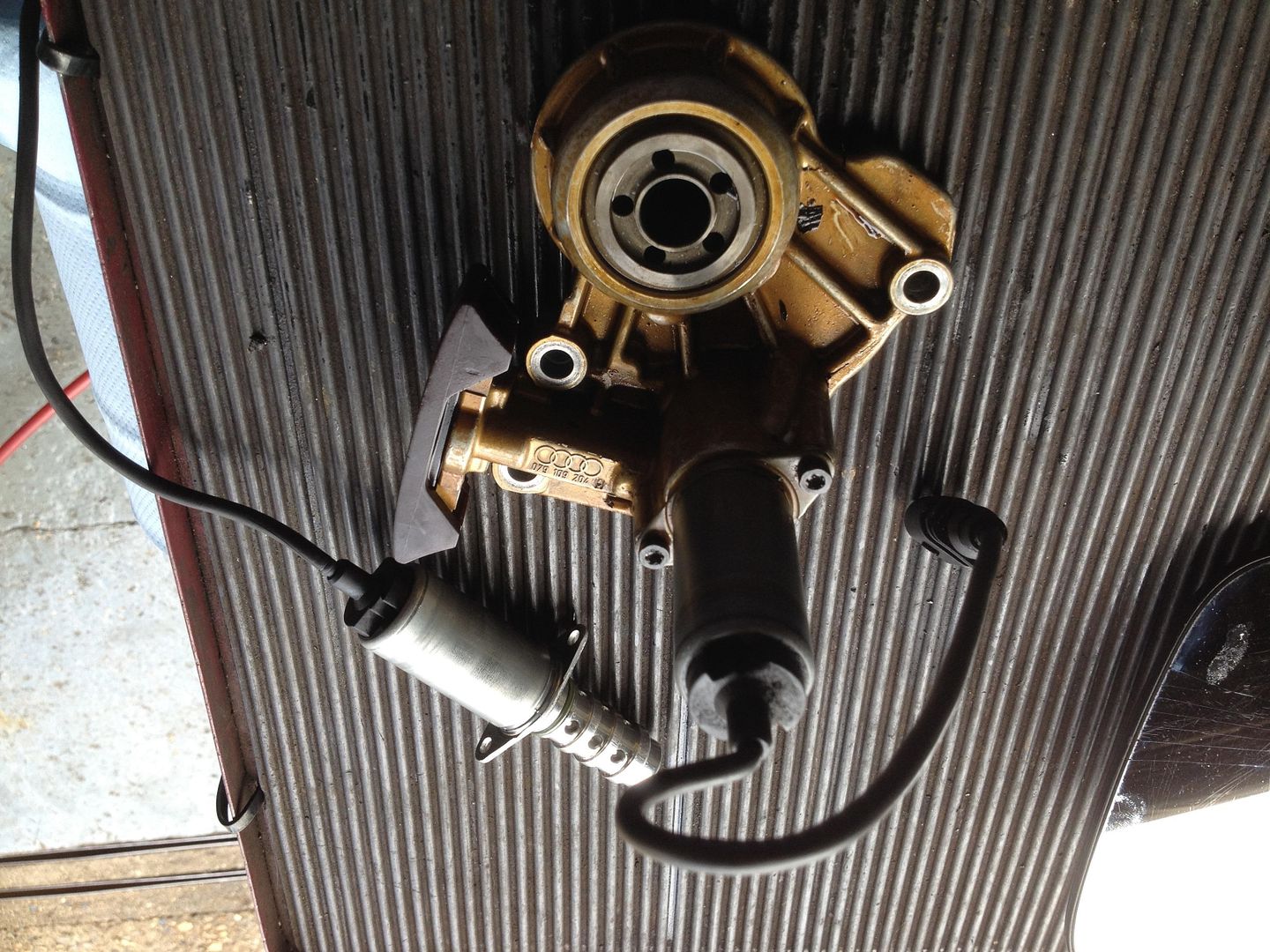

Suddenly when accelerating hard in third gear I felt the engine flutter and hesitate, and a loss of power. So I slowed down a little and pulled into a service station, got out my little VAGSCANNER and checked if I had any fault codes...... Sure Enough : 16405 bank 2 camshaft a (intake) p0021-002 <beep> setpoint not reached (over advanced) mil.
F-ck.....Sh-t..... and a lot worse...... So I cleared the code and started on a very disappointing drive home, BUT suddenly after driving for about five minutes and deliberately driving on and off the throttle, full power returned and she responded perfectly to the throttle. So I decided not to go home but continued on my driver for another hour in all types of roads and traffic, clocking up over 50 miles...... Without any further problems. Arrived home, checked everything physically, ran another scan, NO Fault codes at all. Went for another thirty minute drive, no problems at all, pulling really strong and just wanting to go.
Oh I'm hoping whatever it is has sorted it's self out.
I did wonder if the pistons in the actuator/solenoid could be a little tight, with it being brand new and maybe now they're bedding in. This fault code is caused by the variable timing not retarding sufficiently which is controlled by the ECU sending a signal to the electronic timing unit via the actuator/solenoid. The actuator/solenoid has a piston in it which the signal causes to move a piston in the actuator/solenoid (The part which has the wire coming from it), allowing oil to flow under pressure which releases the locking pin in the mechanical adjuster allowing it to adjust the variable timing. We did have a faulty unit supplied initially, with exactly the same fault code. When we tested it the piston was jamming in the solenoid. Now it's been replaced the new solenoid has had this one single hiccup, but I'm keeping my fingers crossed it was a one off.
I'm certainly hoping so.
Just going to let the car cool down so I can start it from cold and go for another run tonight.
So, for the last sixty miles she's running perfect, after that one hiccup....... Keeping my fingers crossed and it is so nice to have no timing chain rattle on cold or warm start up.
