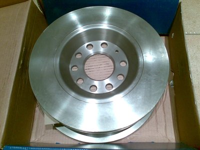

Re: Rear Discs
This is them

Re: Rear Discs
Ones on the car look fine to me - edited to add I mean those look like original B6 S4 discs
Re: Rear Discs
I would say just <beep> them with a hammer from behind. They should come off.

Re: Rear Discs
Not all brake discs are held in place with a retaining bolt though most are. Use a rubber mallet on the rear of the disc both above and below the hub, hitting the disc in the centre and it should fall straight off.

Re: Rear Discs
I must admit I was giving it pretty big licks with the rubber mallet I just didn't wanna go too far without checking as I didn't want to put excess stress on the bearing incase it was the type that is integral to the disc, cheers for the replies, I'll hit it a bit harder!
