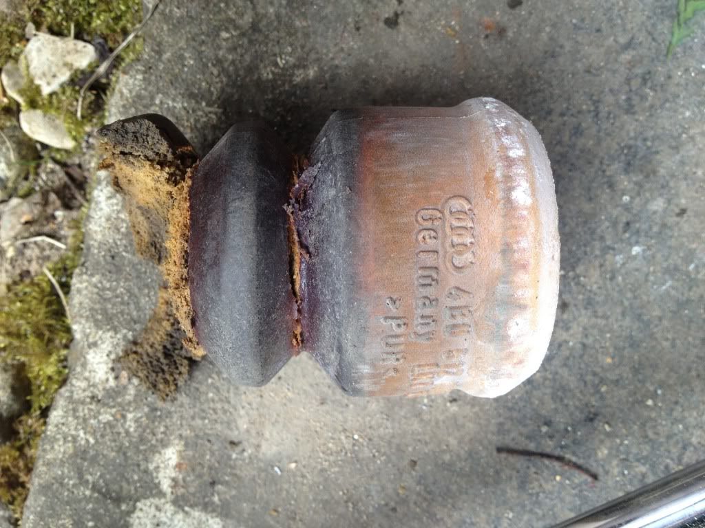

Also swapped out the two rear shock absorbers, including bump stops and boots. One of the bump stops had clearly seen better days:

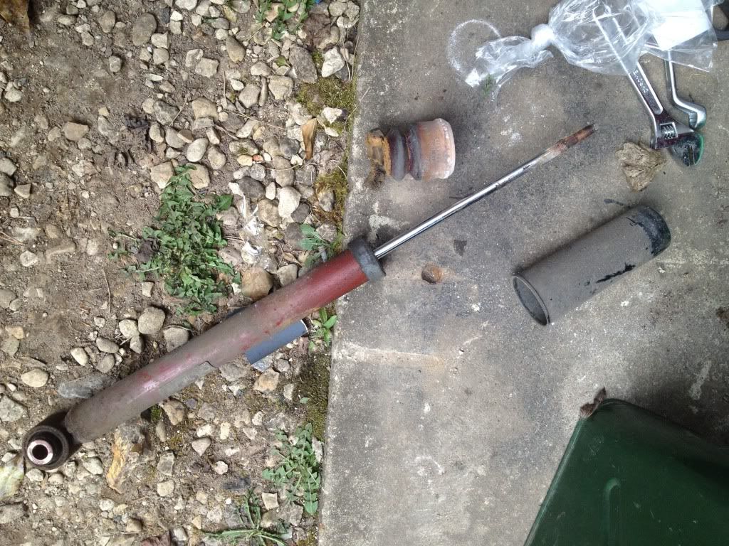

Shocks were pretty tired too:
Very straightforward job to do, the only bit that took some time was getting the old top mounts off - in the end a puller sorted it.
