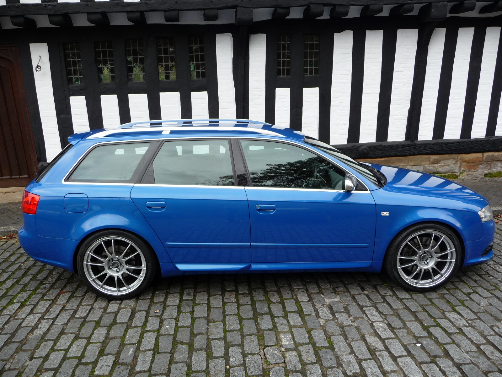

I tried H&R springs but it made the car sit on the bump stops, not good. I found the best set up was Neuspeed springs (much better than H&R) and Koni dampers, it rode better than stock. I think I set the Konis to 1.25 turns front and 1.5 rear on my Avant. You also need to cut 10mm from the middle of the front bump stop and glue them back together with super glue.
Mboy
mboy
Posts: 81
Joined: Sat Feb 12, 2005 6:27 pm
Location: midlands
Re: Which suspension?
Post by mboy » Tue Aug 09, 2011 6:40 pm
With Neuspeed Springs.

Looks lovely mboy!
