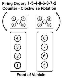

hi guys, I have to change a coil-pack on cylinder 7, but I can't seem to find a clear guide anywhere as to the cylinder layout.
Does anyone know which one is correct:
4-Back-5
3-------6
2-------7
1-front-8
or
4-Back-8
3-------7
2-------6
1-front-5
thanks in advance

It's the 2nd one. I spent ages the first time I had to find out the cylinder order and ended up getting the info from the audi erwin site.
Chris.
