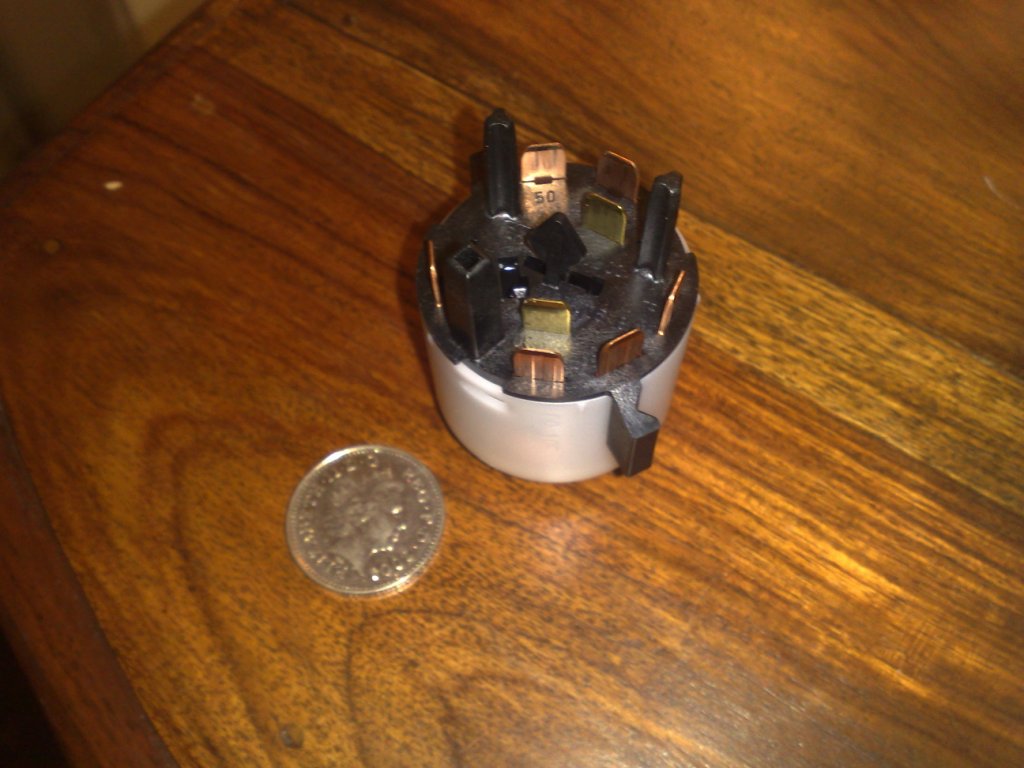

The Starter motor is a pig to do I've been told. You need to do it from underneath the car and it helps if you dismantle the soleniod housing on the side of the starter to get the unit in and out.
The ignition switch is a common item to all VAG cars. It's the same as the golf, passat e.t.c. I'ts a small multipin unit at the back of the ignition barrel, and i've been told it's a common point of failure. The switch is only £26, but was more fitted. It is only a switch and does not contain the immobiliser.
I'll post some pictures of the offending article later.

Try the ignition switch at the end of the ignition barrel. I will send you a picture of it.
It's a standard VAG item, only £26 excluding fitting and I've been told that it is a common source of faults on all VAG cars. Well worth replacing as it is one of the cheaper options. Also, with the S4, I dare say it is taking more current and abuse than a similar Golf or Passat!
Will post a picture tonight.

elmo
Posts: 138
Joined: Thu Jun 11, 2009 9:19 am
Location: Glasgow
Post by elmo » Mon Oct 05, 2009 10:30 pm
Lion,
Photo of the offending ignition switch.

Post by chunky79 » Tue Oct 06, 2009 6:20 am
Having that playing up won't help the starter if it's not making full contact.
Not sure how easy it is to remove the steering covers but switch looks nice and small to get in there.
