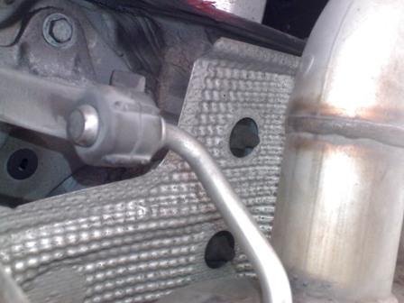

Na same shape as the above pics Bling.
I think that the originals must have been damaged (speed hump perhaps) and replaced with non genuine units. Will this have any effect on the performance?

Hi,
See pics below
kaisersolsay
Posts: 484
Joined: Fri Aug 31, 2007 4:32 pm
Post by kaisersolsay » Sat Sep 22, 2007 12:29 pm
another pic
