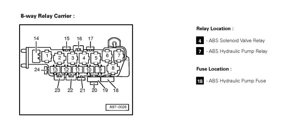

does anyone know where the j106 return flow pump relay is located, on a 2000 s4. thanks

On ELSA it shows the pump and the arrow for J106 is on the front side of the pump near one of the mounting bracket nuts

It's No. 4 on this diagram..........
