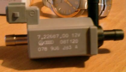

Hi, I ordered a new N75 valve from audi oxford, and the guy took the part number off of my car, and checked it against the system. But what I have been given is not the same.
Is this a superceeded part/alternative or have they messed up?
If it is alternative/superceeded can I fit it with out any trouble?

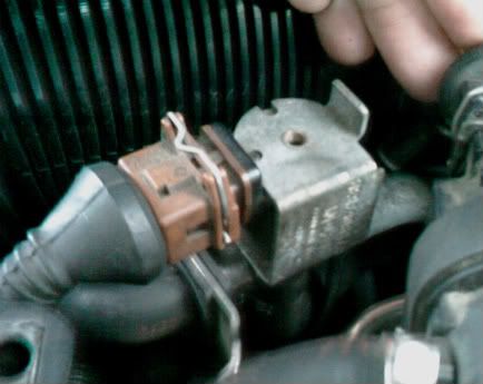

Part on my car
Part from audi

I cant see how this is going to work. Cause the pipes would be in the wrong place.
From what I can see the part number is the same, except for the last letter.
What are peoples opinions on manual boost control valves vs an N75. Would it be worth returning the part and fitting a manual bleed valve.

That looks like an N75 for a single turbo engine, ie: 1.8T.
Manual boost valves aren't a smart idea on these cars as Motronic engines rely on the N75 to control boost. You could end up with glowing red turbos or worse, melted ones!

That looks definitely wrong to me
Audi list all valves like these as "solenoid change-over valve", so if the parts man is not familiar with the car, it will be wrong.
It doesn't say anything about "N75" or "boost", etc.
Best to go back, and better with a part no. off the old one on your car

They have given you the wrong part :roll:
The part you need is 078 906 283 B.
The other valve you have taken a photo of is fitted to the engine on the RHS ( when viewed from the front ) beneath the plastic engine cover and just behind the oil filler cap but i dont know what this does, and is the same part Number minus the 'B'.

Think the other one is the N249 valve. :wink:

Iv just called audi, after a bit of yelling at them, they decided they wrote down the wrong number from the part on my car. and have ordered the correct part for me :)
