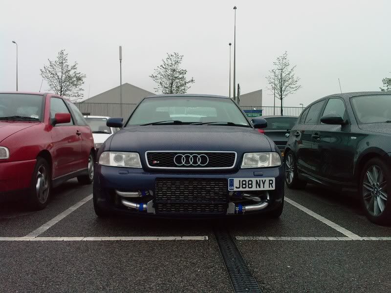

After a weekend of rain, swearing, pain and so on the FMIC is now fitted! Got to say these new cxracing pipes are a really tight fit. but they do fit... just, you have to cut LOADS out of the crash bar and a bit out of the bumper too. Havent fitted the side grilles yet, but I can see that being a bit tight.
Iv cut the number plate plinth out and put the no.plate on the side. I think it looks pretty neat, just need to get the mesh on the sidegrilles in.

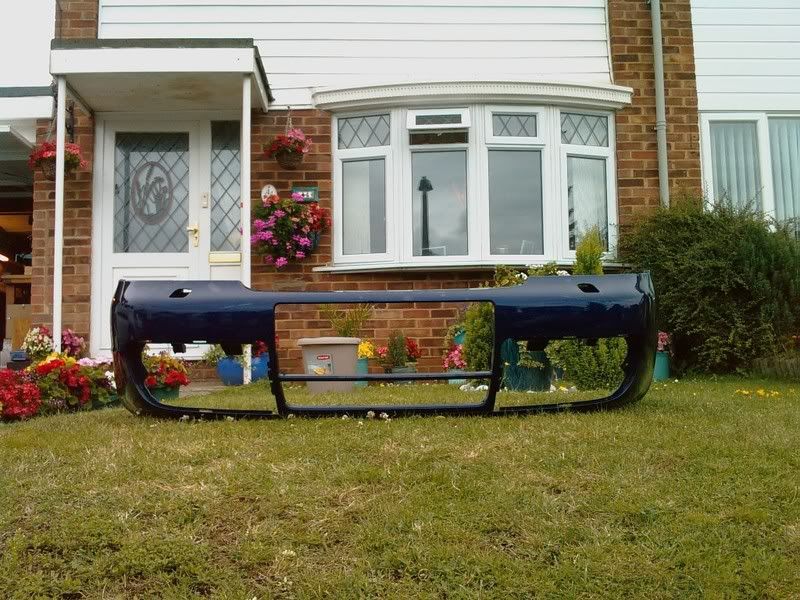

Without the FMIC, minus the front mounted fan as well.
Pic of car with FMIC on floor to compare for size. It's a big momma.
Plenty needs cutting off, including the plastics just underneath the headlight.
The plumbing roughly in place and held using steel wire. It does help to hold it in place while you wrestle with pipes.

Good work mate. Now i know which pipes go where
and what to cut out. Any pics of the bumper?

Heres a few more pics.

I want one asap , you got it proper straight too bet that took loads of time and cursing . Top job
anyone any pics fitted with a RS4 bumper or replica rs4?

Yeh, i just need to mesh and put in the side grilles and get them fitted, i think the pipes will look quite nice behind the mesh unpainted... the only problem is the grille will not fit on the right hand side with out cuting part of it out because of one of the pipes...
I was thinking i might put the grilles in and cut out part of the grill and mesh that needs cutting out to allow fitment around the pipe. and just paint the part of the pipe that sticks out black so that is doesnt stand out?

The bumper was childs play compared to getting everything else to fit.andybnwc wrote:I want one asap , you got it proper straight too bet that took loads of time and cursing . Top job
Even the intercooler itself is straight behind the bumper.
