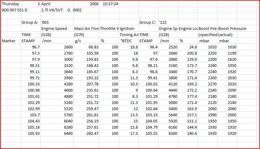

Could someone please look at my latest FATS times
Latest ones after new MAF and TBA

I'm sorry but I haven't been following your previous threads, so my observations are somewhat limited.
By the looks of your MAF and specified boost readings, you have a remap (with K03s)?
The MAF reading suggests around 320bhp.
Unfortunately the log doesn't quite hit 6,500rpm so it's difficult to compute an exact FATs time but it looks to be around 6sec, which is a bit under par for a remapped car - you should be in the low 5's.
The actual boost readings are well below specified from 2,700 to 4,400rpm, but pick up after that

Car has an ABT chip thats about it tuning wise and I agree it does feel a tad slow. Any ideas on logs or checks to make.
