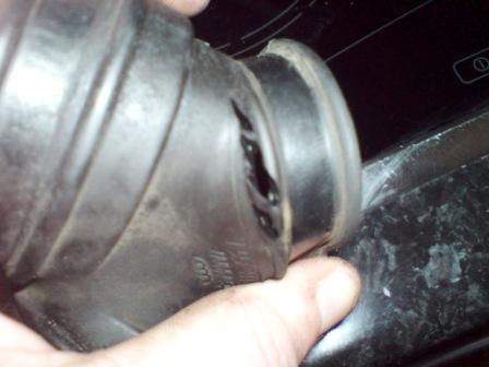

Well, it fitted. Ended up just replacing the TBB this morning as I didn't have a load of spare replacement clips/jubilees to do the rest.
Fit is nice and snug, has same issue as with the Samco set, that of the sensor mounting point being too high up to get the engine cover back on. I trimmed it down as much as I felt happy doing but still wouldn't create enough clearance.
All in all I am very happy with it at the moment as it has fixed this and I am back to 15ish PSI of boost again.

- Knackered TBB
- tbb.JPG (26.92 KiB) Viewed 1096 times
