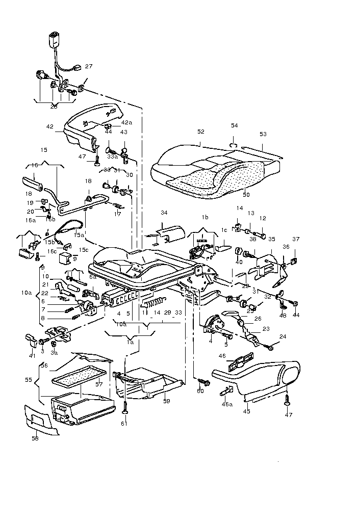

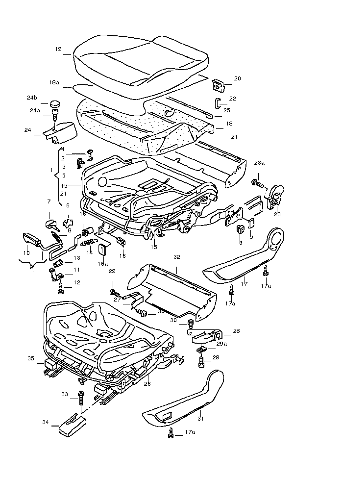

Looking at the parts catalogue (Vagcat came back up) that's a big fat no. The A4 has two mounting rails and the A6 has one. Compare and contrast these two images.
The first is the A4/S4 - see the two mounting rails? The second is A6 / S6, only one rail and in the centre.
I used a 1999 S4 Avant and 1999 A6 Avant to compare between - if you give me the exact model years I can try and give you a more definative answer.

What model year is your car? - I can check more specifically then - I just guessed at 99 year S4 / A6
Just had another look at vag cat, the diagram for the A4 / S4 actually shows two seat bases - the middle one is for normal seats whilst the bottom is for: "seat frame / for models with electric operated seats / adapt with workshop equipment
left / PR-Q1A/Q1D"
So, I'll reverse my opinion regarding A4 - A6, as long as both cars have the same type of seats originally ie both electric or both manual - then you should be ok.
left / PR-Q1A/Q1D"
