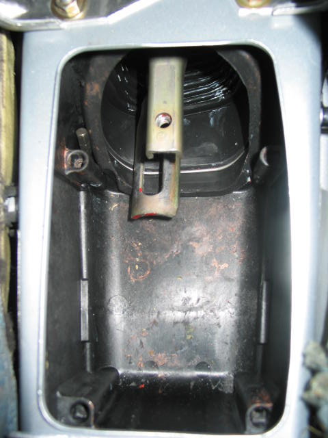

I need some urgent advice regarding my gearbox.
My shirt shifter doesn't like reverse, so i need to force it in to engage. However, today when I went out and applied the usual muscle to select reverse, the gear stick went floppy. I found I could only engage second and fourth (still very Floppy) and could not engage the upper gears.
I have removed the short shifter but cannot see anything obvious which would cause the floppyness. However, the below picture shows two rods which pertrude and both of these rods move around quite freely (up.down, left and right)
Have i damaged the gearbox? or could it be the short shifter?
Your help will be appreciated.

I didn't try adjusting as I wanted to change the shifter anyway. Is it possible to break something in the linkage by using brute force to change gear?. I can engage some gears but it is still very floopy when engaged and the movement out of gear is all over the place (up, down, sideways). I would have expected the link rods to remain fairly static, however, there is a hell of a lot of play which leads me to believe it may be something worse.
I have assembled the other shifter so will try a replace it tomorrow to see if it is just a case of alignment.

Sounds to me like you have dislodged the ridgid bar which is that top one in the pic i think? Yes it is. The top yellow looking bar with 1 hole in it should be solid and NOT move
