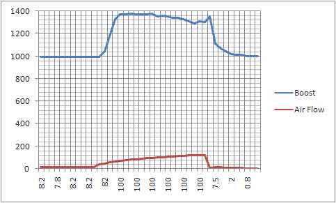

Ok just got some more logs, throttle position is on the x axis and airflow peaks at 121.25

Hmm just had another check and it's also throw up:
17536 - Fuel Trim; Bank 1 (Mult): System too Lean
P1128 - 35-00 - -
So looks like the Maf is faulty?
MarkB
Posts: 5695
Post by MarkB » Tue Mar 06, 2007 4:58 pm
Yep sounds very low MAF reading
Mark
