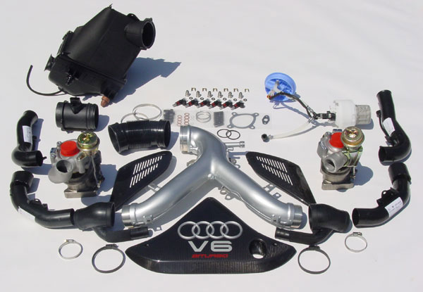

The APR kit is good value at the moment £3995 for the turbos and the bits pictured below. Add to this the APR intercoolers similar to RS4`s.
