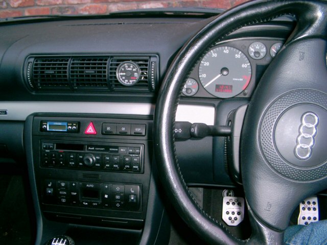

As far as boost gauges go, here is a picture of my interior (which I haven't seen for nearly a month now). I have the AWE vent boost gauge.
