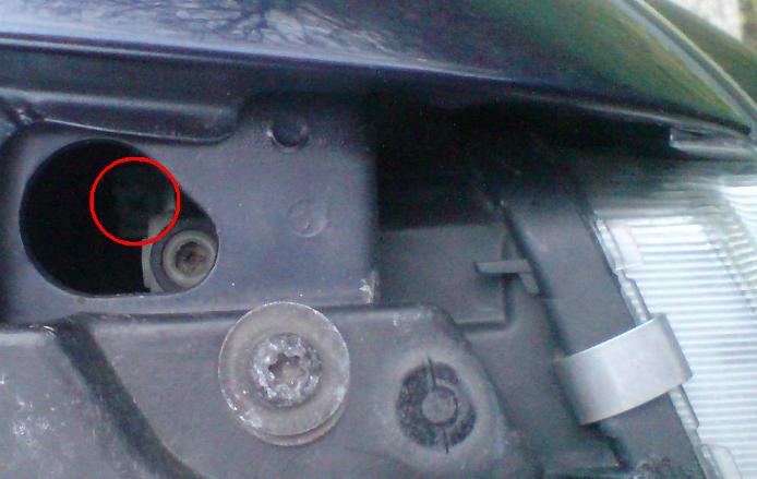

I'm also having a nightmare trying to change my passenger side front indicator bulb on my pre-facelift S4. Can anyone explain the best way to get at this one? I can see there appears to be a tiny bit of play on the seperate indicator unit, ie: you can slide it forward and back a tiny bit. Is there some kind of accessible clip to allow the whole unit to just pull out, or am I just as well off pulling the entire healdight assembly forward? The only recessed bolt I can see through a hole in the wing is a little white plastic screw. Surely this can't be what i'm looking for?

Post by MCB » Tue Feb 13, 2007 1:41 pm
Removal of Corner Lamp
  • Using a screwdriver, unlock the clip holding the corner light in place. This can be done using the screwdriver, the plastic, hinged clip can be removed by inserting the screwdriver through the access hole inside the hood lip, located just behind the corner lamp.
    After the hinged locking tab is opened, the plastic retaining tab can be depressed using the screwdriver.
    While holding this tab down, gently slide the corner lamp forward. The lamp should be fairly easy to remove, if there is a lot of resistance, the locking tab is not fully depressed. The lamp will now be hanging from the connected wires.
    If the corner lamp is being replaced, remove the lamp from the connecting wires by gently turning the harness inside the lamp.
Content courtesy of AW Tech section, always a good place to look.

Post by Blue_Thunder » Tue Feb 13, 2007 5:06 pm
Thanks for that. Had a go when I got home early from work and it's a piece of p. For those as technically challenged as I am, here's a photo showing the 'clip'. Basically you need to turn the white phillips screw head 90 degrees, then you can push the whole thing down with a screwdriver.
The indicator unit then slides out, easy enough to push the whole thing from where the back touches the outer wing.
