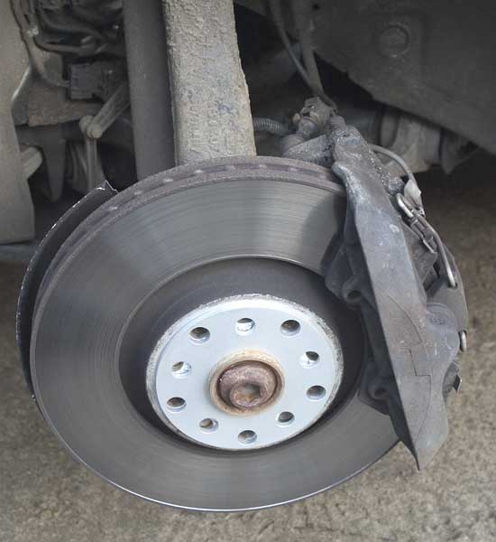

Here's a pic of the hub assembly with the spacer on:

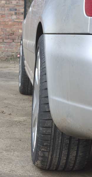

Shot from the back, trying to show the wider track. The wheels don't really stick out that much more despite the 0.5" wider rims and 5mm spacer.

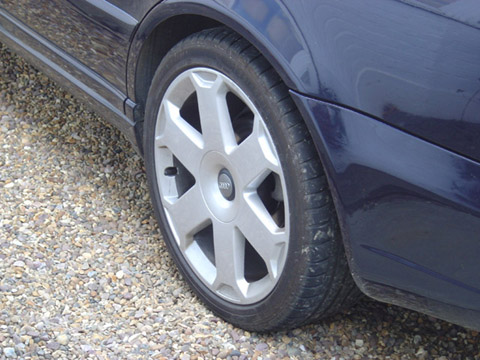

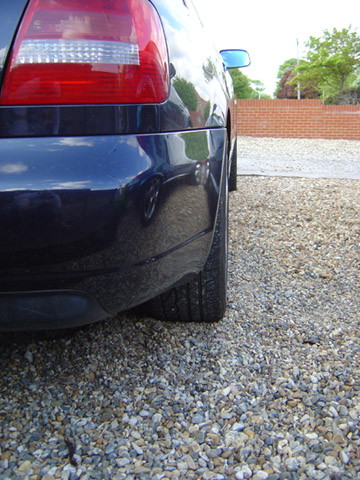

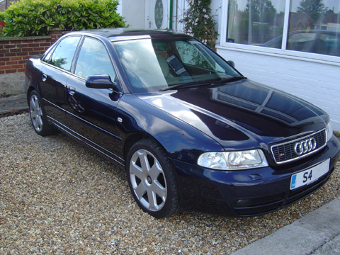

Well seeing you got the ball rolling I will add my pics, very poor ones I took this morning, car needs a good buffing! LOL
Got my wheels and tyres from the same contact as AJSL mentions above... although my 18inch AVUS came shod in Dunlop SP rubber....
Anyhow they really change the look of the car, and also help out the handling, yes there is more road noise but the comfort of the ride is not effected.
I am still in need of some longer bolts and 5mm spacers, at the moment I have some dodgy cheap 3mm ones..... :?
Here are some pics....

It seems dependant on year but my S4 needs them as the front wheels would not even turn. The wheel was tight against the brake caliper. The rears looked like they may just fit without, but there was barely any clearance. I thought at speed the tyre might expand and rub.... 3mm spacers would be perfect, but these are not available in hubcentric form, well not that I can find without paying MTM's silly prices.... so 5mm are the smallest available....
I understand the earlier S4 with the older style caliper does not seem to need spacers.

Nice photos. But they remind me of how much better the S4 looks when lowered...

I think the B6 wheels really suit the B5 S4, they are a little less angular looking and fit the car's lines, especially on a silver car.

I think they make any S4 look better..... and there better than the RS4 reps on the S4....... a bit more rare.....
But agree with Dippy, the car needs some lowering...... I mean the wifes tigra has a smaller gap between the tyres and arch and thats not a sports car!

Not for me I am afraid. I dont think they quite suit the B5 design....same feeling I get with the RS6 style wheels...IMHO these look better on newer cars.... But the car defo needs lowering :lol:
