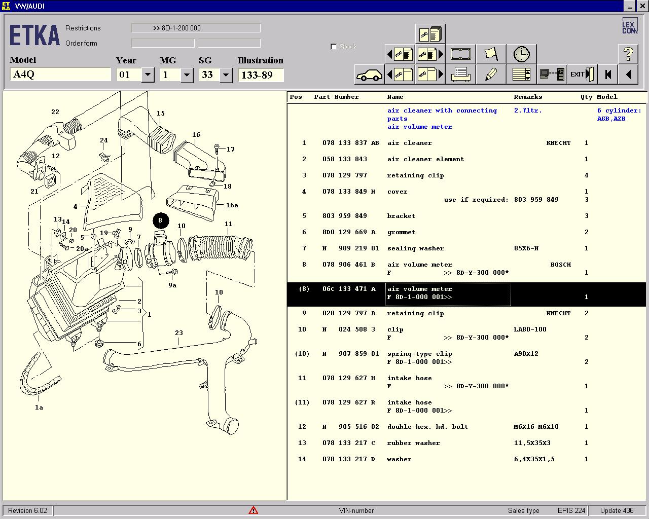

Got around to checking my MAF. It is a Hitachi part number AFH75-01A. The VAG part is 06C 133 471A.

OK, just checked ETKA out for this MAF info and Dippy's MAF part number appears on the main MAF diagram for chassis range 8D-1-000-001 onwards - whereas the Bosch unit was fitted up to chassis range 8D-Y-300-000 (earlier models than this!) so I bet Dippy's VIN number falls within the later 8D-1-000-001 onwards range.
As you can see from the diagram below, I think the Hitachi MAF will fit MY2000 model cars as long as you fit the associated parts (those being the replaced spring clip and hose - signified again by the 8D-1-000-001 onwards range on the diagram)
Hope this helps.
Hope this helps.

Actually, mine is 8D-Z-3*****. But then it is a personal import so maybe that explains the difference.
