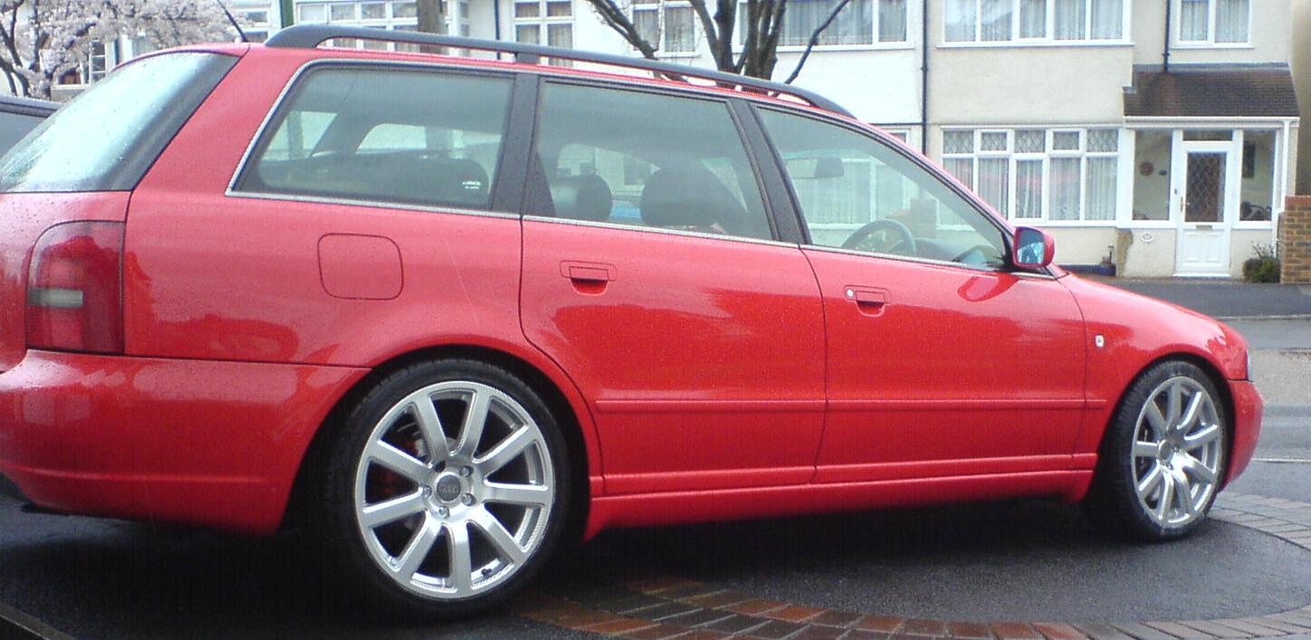

right guys here we go..my RS4 reps weighed in at 13 kg's each the new wheels weighed in at about 11.2 to 11.4 kg's roughly speaking 28.6lbs for the RS4 reps and about 25.08lbs for the mtm style rep.. oh and they look great.. :jump:

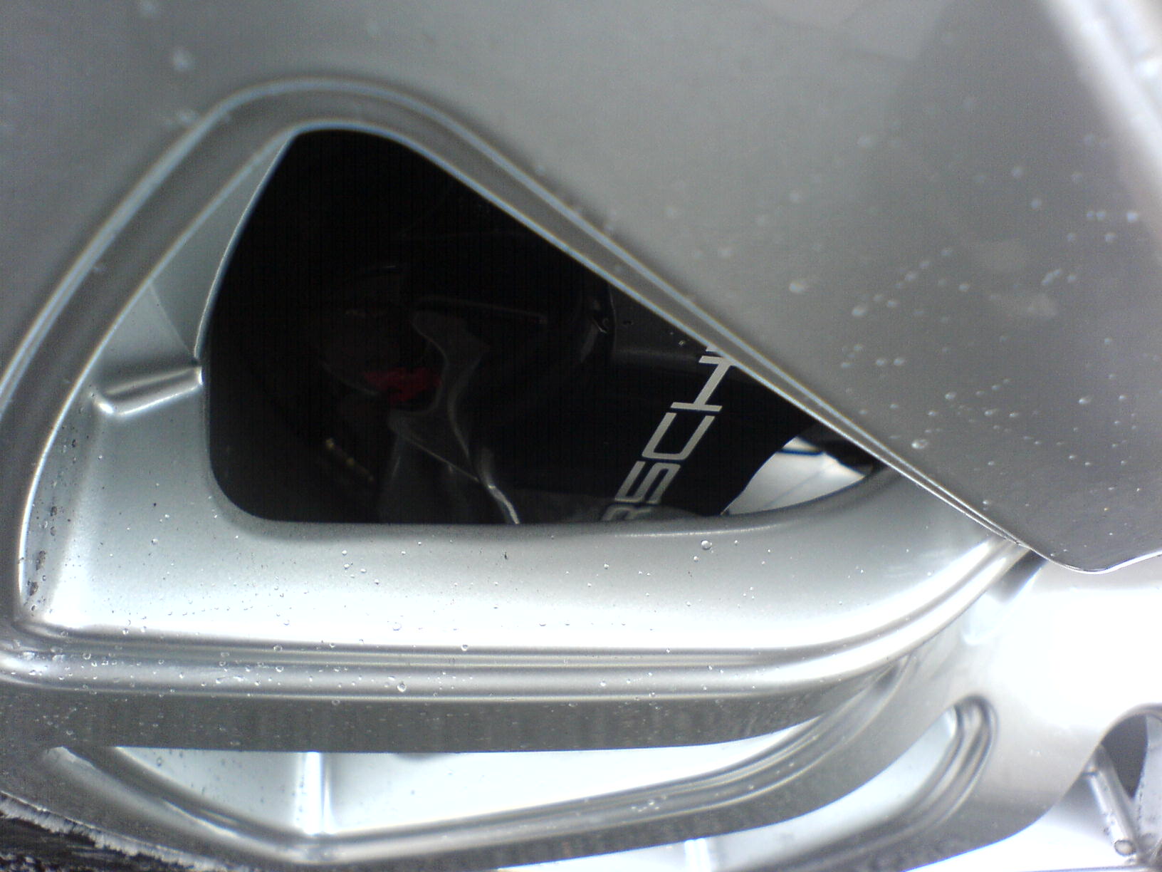

also they clear my porsche brakes even more than the RS4 reps did and thats without spacer 2...hope the pic below helps

They look superb Woody!
Many thanks for the pix and all the info. What is the ET on these please?

(The offset of the OEM wheels is 45, so the ET35 of these wheels plus the shape of the spokes gives you more clearance for bigger brakes)

well to be honest simon the tyre package aint that bad (price i mean) its just a shame that there prob a cheap tyre..clive its true what you say about the spokes..they bend just rite and give lovely clearence,would be nice to see if they clear the RS6 brakes too.

s4woody wrote:clive its true what you say about the spokes..they bend just rite and give lovely clearence,would be nice to see if they clear the RS6 brakes too.
I'll let you know - just ordered a set! I think they should as I tried a set of RS4 reps with ET35 and they cleared the brakes by a "Rizla paper" (copyright of expression ackowledged to Rolskii!) - too close for comfort. But I think the shape of these spokes should do the job nicely.
