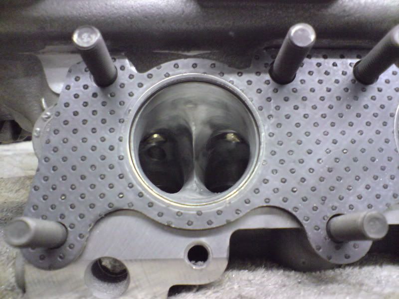

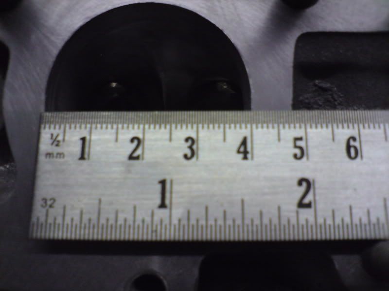

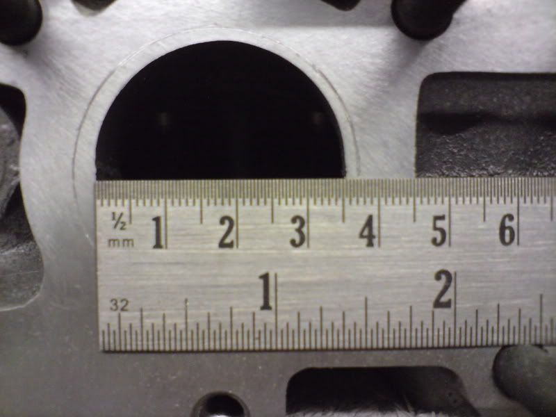

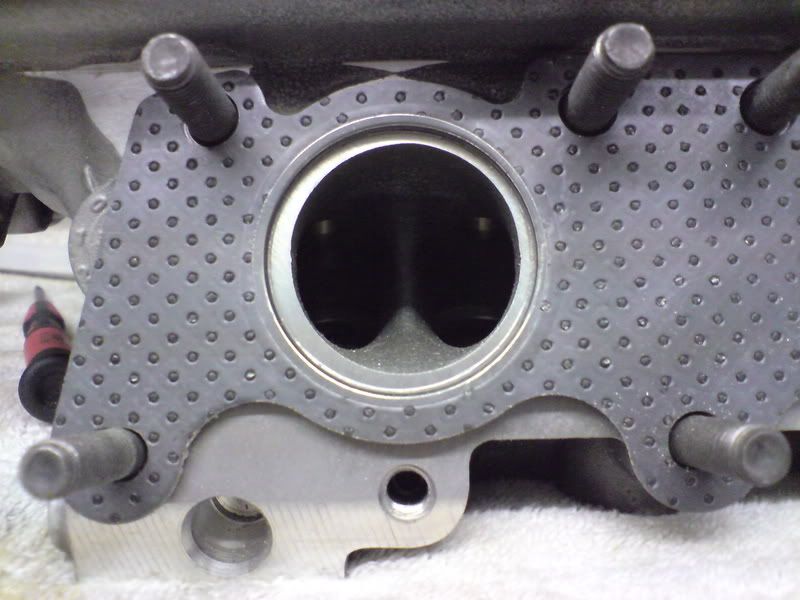

well .... the theory that there is a larger amount of material that can be removed from the ports of the 2.4 heads is very much so .. 5mm easilyquattronutter wrote:so whats the news with the 2.4 heads?
standard ..
ported ..
ive left about 0.5mm tolerance to alow for the gasket to expand "not shown"
all good news as regards to making satans child breath without back preesre issues ..
all this cost was 50 ... 40 grit dremmel bits and about a week in the workshop after work ... the heads are now off to qep for some final finishing and flowing, 3 angle seats and valves. solid lifters and the cams ...
ill keep you posted ...

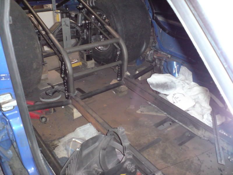

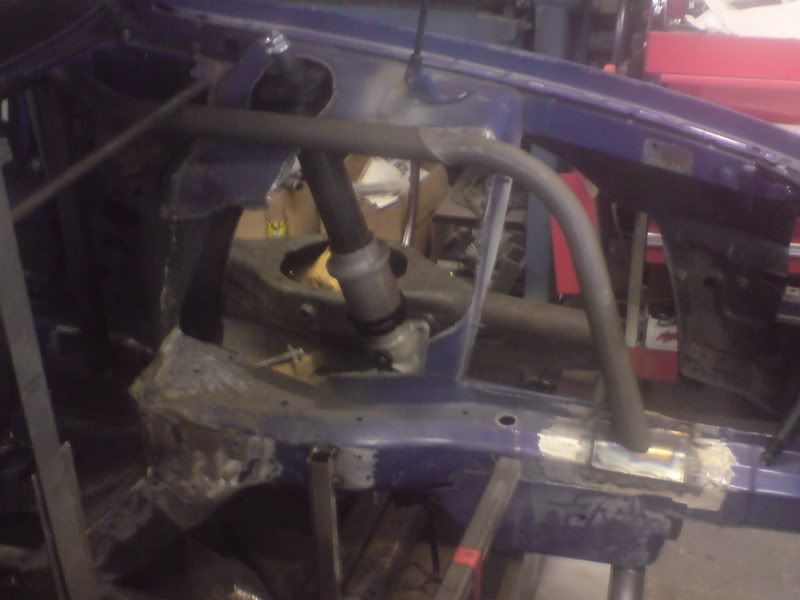

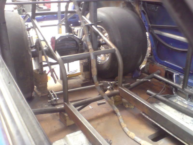

well here's the pics of the progress on the car over the last week...
the fourlink is now in and most of the floor now removed...
the floor will be compleatly removed and the full funny car cage built into the chassis rails, thus surounding me 360 degree's ...
the floor will then be replaced with sheet metal ....
more to follow ..
more to follow ..

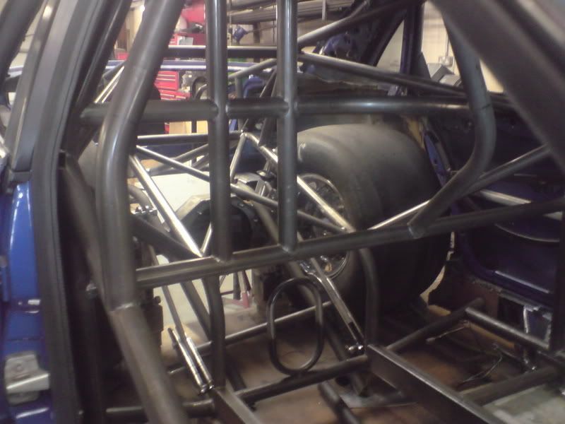

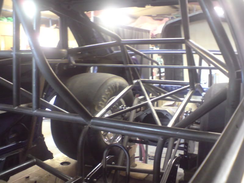

project satanschild

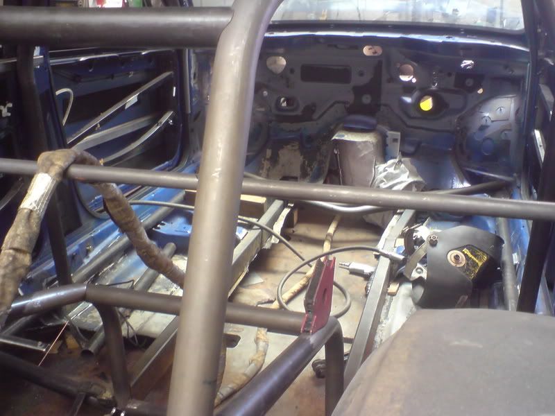

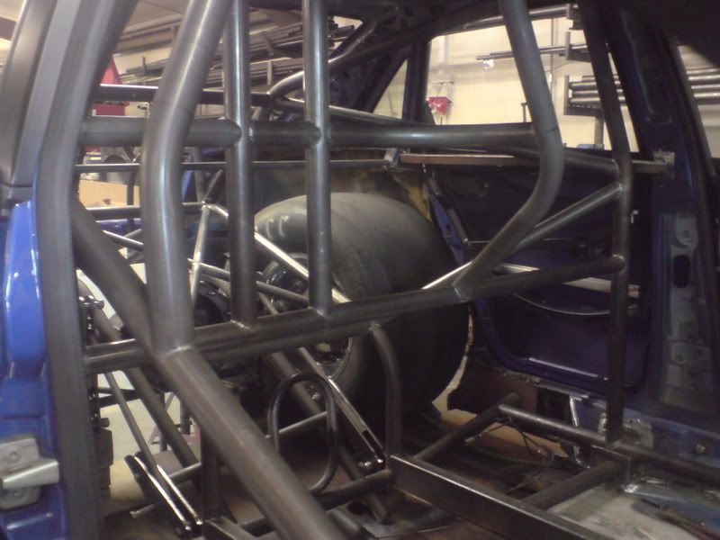

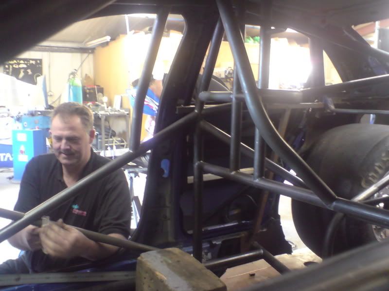

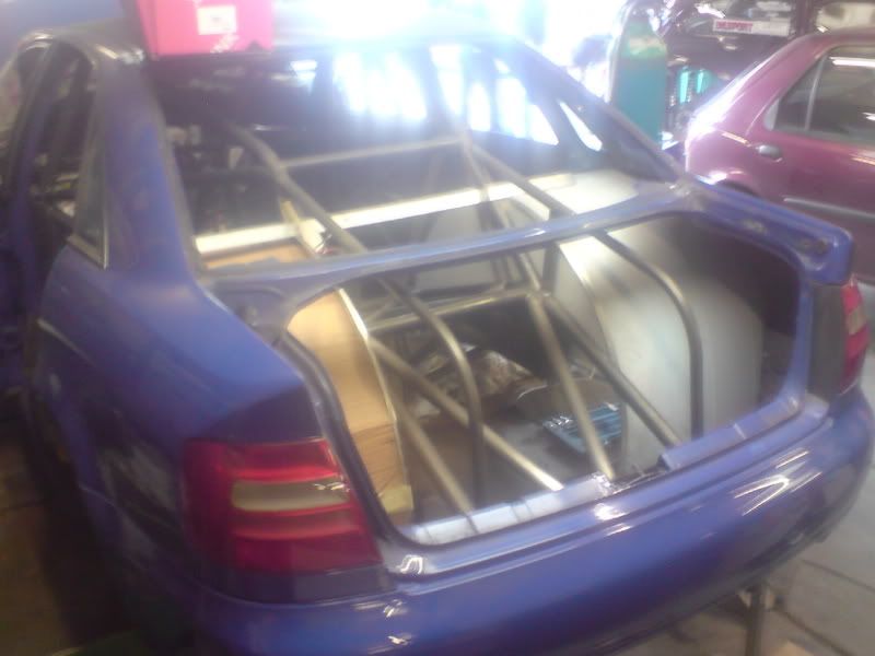

well its been about a month since i last posted some pics for you guys to see...
so here is some more car porn ...lol
i took these about 4 weeks ago,
i went to see it again yesterday and well......
the back end is almost finished,most of the funny car cage finished apart from the passenger door bars and a few bars left to do in the floor ..... then onto the front end and engine bay ...
say hi to rob ... this is the guy i owe a massive thanks to along with andy kate and luke, and all of the guys at ARRC.
STARTING TO LOOK A BIT MORE LIKE A RACE CAR NOW.........

Re: RE: Re: RE: Re: RE: Re: RE: project satanschild
Nice job, did the same with my old E30 BM and used the Dremel as well. Inlet and exhaust manifold gaskets always seem to be a lot bigger than the ports. You'd think the manufacturers would match them in the casting process.
Anyone know if the cosworth RS4 heads have the same problem with gaskets being a lot bigger than the ports?

RE: Re: RE: Re: RE: Re: RE: Re: RE: project satanschild
Chassis is a work of art.
When do you think it will run please ? I'd like to come along to see it.

Re: RE: Re: RE: Re: RE: Re: RE: Re: RE: project satanschild
thanks david.... it realy is a work of art.....DavidT wrote:Chassis is a work of art.
i hope to have it out for testing sometime in october.... bit late in the year i know, but with a few parts with long build times it has put this back about 3 months, so i dont think we will get time this year to try any major quick runs.....
you are all welcome to come and watch
ill post where and when we will first run the car .. so all can attend if you would like to ..
cheers .. jack

[quote="don"]Nice job, did the same with my old E30 BM and used the Dremel as well. Inlet and exhaust manifold gaskets always seem to be a lot bigger than the ports. You'd think the manufacturers would match them in the casting process.
yes they are mate .... all audi v6 heads have the same size exhaust ports. but, be carefull if you port them yourself as there is not as much material to remove as there is on the 2.4 heads ...

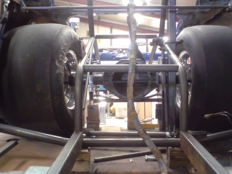

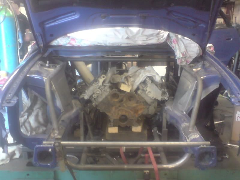

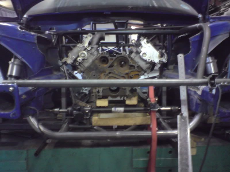

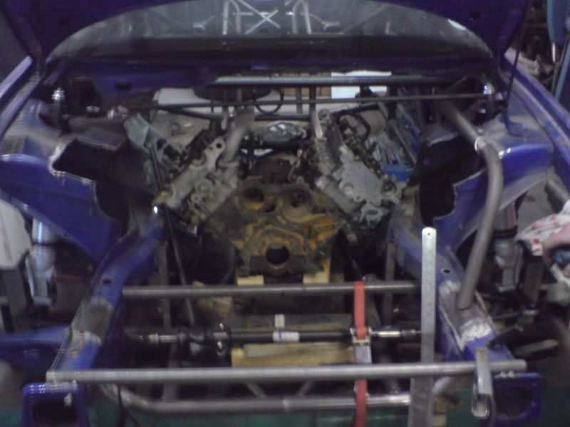

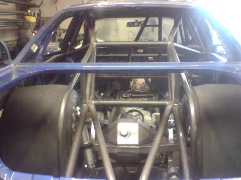

progress....
sorry it has been so long since i last updated you all.....
the car is now coming together faster than i expected and is looking great..
some pics for you...
and nearly finished ... by the end of next week the engine will be mounted and it will be off the jig and on all 4 wheels....
the rear tubs are now being fabricated and going in...
