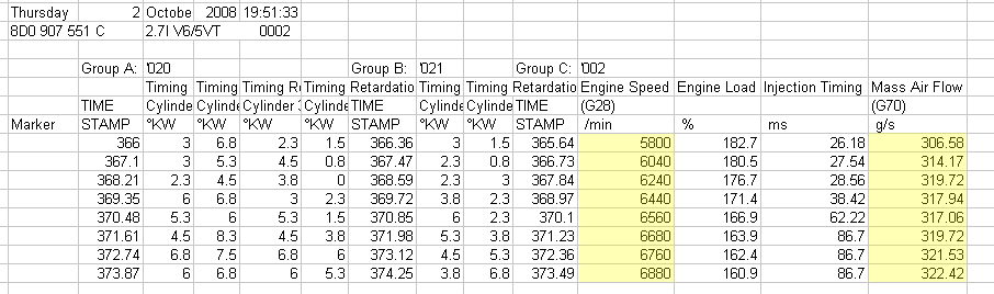

Anyway here is a snipit of the log i did last night when i found out that i need one of liam's (esp) gearbox braces......
As you can see the car is pulling very well at the top end with standard injectors/fuel pump/intercoolers/exhaust/airbox/manifolds,apart from the turbo's all we have done is yank the 2 precats out and fit a k+n panel filter!

Standard fueling? I would like to see a graph of you Inniovate (LM1?) at wot, at 6600 rpm.

Fueling is around 0.8 lambda wot in 4th at 6600rpm!
