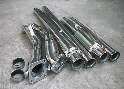

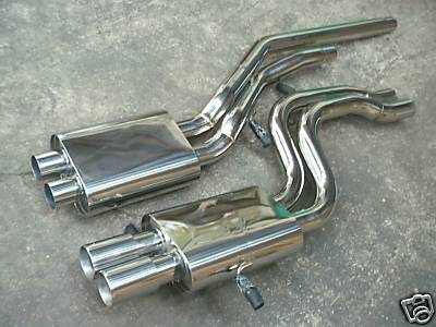

I am sure someone must have tried these off ebay? any feedback?
Full turbo back system £420?
The only thing is I can't see the flexi section on the down pipes? and the good old saying 'you get what you pay for'!
£160 delivered
£260 delivered

s4-99
Posts: 590
Joined: Sun Nov 13, 2005 11:33 pm
Post by s4-99 » Thu Oct 23, 2008 7:17 pm
viperbl wrote:I did 550hp on my single 3" miltek cat back here but I think its now restrictive (who knows, it might have been restrictive back at 550 hp, but my EGT's were normally below 1000 deg)
So sounds like 420-450bhp shouldn't be too much of a problem with the set up i've already got :?
Hmmm, its fast but is it fast enough!!!
s4-99
Posts: 590
Post by s4-99 » Thu Oct 23, 2008 7:23 pm
They look well made imo, the down pipes look good. I might be interested in some of these if you get any good feedback about them. Do you know what the size of these pipes are?
rocketmq1
Posts: 35
Joined: Wed Sep 03, 2008 8:42 pm
Location: Coventry
Post by rocketmq1 » Fri Oct 24, 2008 3:18 pm
Just got a reply from the seller, he said the pipes are 60mm. (2.25"?)
