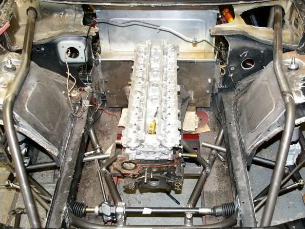

as most of you know the s4 is a heavy old chap, and this is how we have changed that very much......
starting at the front,
there are some very clever mods, we will no longer need the subframe or the front struts and heavy uprights, the engine will be fixed by motor plate to the new bulkhead which is moved back 15" so as to put the weight of the engine behind the front wheels, the suspension and wishbones is all custom mounted by andy on a new chromolly tube subframe, there are no uprights or hubs these are now all integral parts as the fornt shocks have spindle mount wheels, which saves us about 200kilo's in all....
you can see from this pic what i mean....
i chose these fronts..Image
fingers crossed we will have a full 1 peice front end and therfore have full access to work aroung the engine, but this will not be a priority and come when the budget allows.
